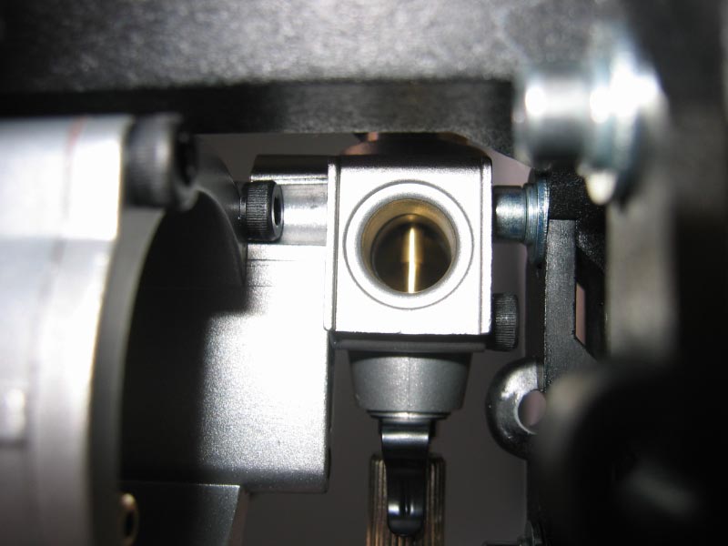

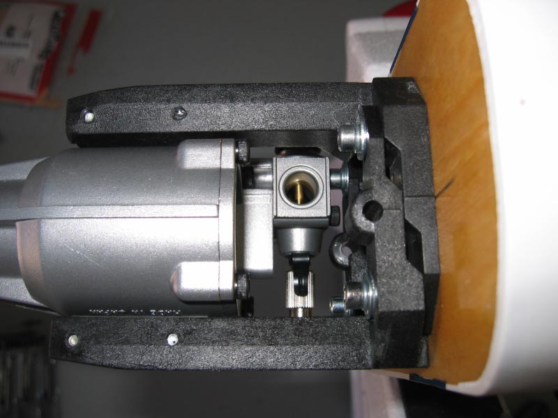

Guys,
I have a problem and need some advise. I'm in the process of mounting my Saito .91 using the standard mount included in the kit. I believe I saw posts of guys using this same mount with up to .100 sized Saitos, but I can't see a way to make it work without removing one of the bolts used to attach the carb to the engine body.
With it mouted as is, the engine front of the engine case (the mounts) are about 1mm from the tip of the engine mount - it's about as far forward as (I think) you can safely get while still being close to the suggested dimensions in the manual (5" from FW to back of spinner plate). The only alternatives I can see is removing material from the engine mount or removing the that part of the bracket all together, using a different mount (suggestions?) or doing what I have done.
While the carb is extremely important, I can't initially see how this piece undergoes enough strain where I can't safely remove one bolt. I did use blue locktite on the remaining bolt to keep it securely in place.
Is this a really bad idea? How did you guys with .91's or 100's get these mounted with the stock mount?
Please see the attached pictures and let me know any ideas. You can see where the one engine mount bolt (silver) is right up against the back of the motor where the other black carb bolt should be.
Thanks -
Wayne
Thanks -
Wayne

sl1200mk2... I used the bigger GP mount when I installed the S100 and I had
somewhat of the same problem on that mounting bolt. But I only needed
alittle more clearance so I just filed it down some, being careful to keep the
working end working... It worked for me... I would guess you could find a
flatter bolt/screw and/or counter sink the mount also???? which I feel would
be better...
You may be right on the removal of the one carb. mounting bolt????? But
IMO... I wouldn't do it.... I would think there is a fair amount of vibration
while flying/3ding.... And it may cause problems... But that's just me....

Wayne, Sorry it's being a pain for you. I just recently mounted a 91 to a mount for a Funtana and it was a challenge too. It seems like I had to do some grinding of the mount material to get it to work but it did work out fine. But that is a Hangar 9 mount. I wouldn't remove the carb bolt. There must be some other mount that will work. One of the other guys on here must have come across that and will chime in on this. You might have to relocate a few of the T nuts on the firewall. If you have to move them it's a good idea to fill in the unused ones with a chunk of dowel rod and epoxy. Also if you do have to fill holes with dowel rod make sure it's flush on the inside of the firewall or it could interfere with the new T nut.

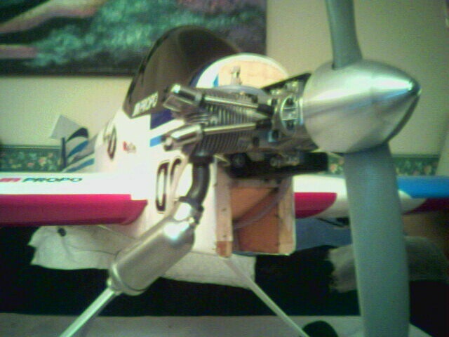

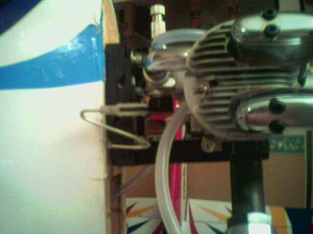

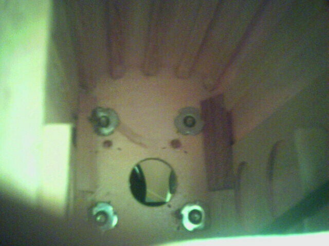

i used the 60 size gp mount for mine, it was easy
(except having to plug the old holes and drill new ones to put in new blind nuts, but either way ypu go there is work, so take your pick
the four little dark spots on the firewall are the old holes.

I used the stock mount with the 100. I just used a counter sunk screw in that spot and it works fine. The nipple is a breather, just put 3 to 4 inches of fuel tubing on it and let in stick out the bottom.

the stock mount for the 46 works great with my Saito 65 and the 65 has the exact same mounting dimensions as the 91 so I have to believe that it will work the same for you as it did for me.
All you have to do is reverse the carb so the needle is going out the other side of the cowl and then grind off the part of the mount that holds the nose wheel. This should offset the carb enough to the left side of the plane for the carb bolt to miss the mount bolt.
If your still having problems let me know and I'll pull my cowl off and take a picture.
