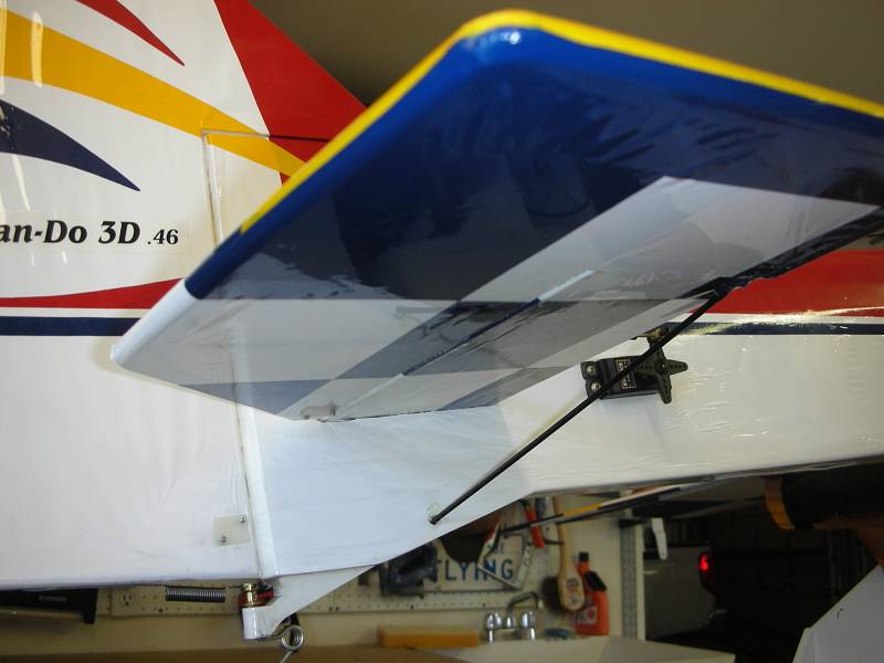

Hey Guys
Had a great maiden - what a puppy dog this Do is. For those wanting to "wire" the tail feathers, take a look at my solution. I borrowed the idea from the Funtana series. Just inserted/glued some carbon sticks from the fuse to the edge of the stab. It held together during some tight loops and pull outs. Time will tell if its a lasting cure.
Barry - I'm at 2700 ft. so I have half your altitude problem. The 14 x 4w worked well but I'm goin to try the 14 x 5n prop and see what happens.
Thanks to all who posted - your experiences help me put this one together.

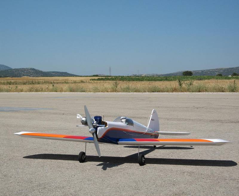

This goes to all experts here.
I am in the way of purchasing a GP UCD 46 but i don't know what engine to use.
I am flying now a GP Super sportster with an OS 65 LA.
Great combo i must say.
Do you think that the 65LA would be a good choice or what?
Kostas

TedG...
Great idea on the tail. Congrats on the successful maiden. The UCD is an easy flying plane...when you want it to be. But it can be a lion when you want it to be also.
