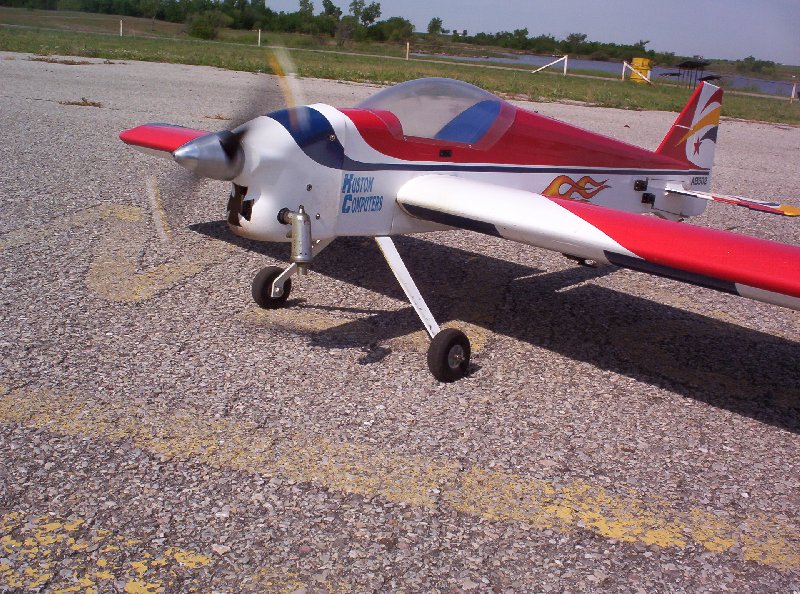

Hey guys !! Great to see the the massive Do thread just keeps getting bigger. I always tell friends to come in here and look through this thread for Q&A on the DooDoo when they get one. I'm still flying number 3 and it keeps getting better all the time. These UCDs will do stuff no other will. Amen.
So here's my question for the Do experts tonight. I've been running a Saito.72 with 14x4W APC . A local hobby shop owner suggested running the 14x5N APC instead. He claims it will tax the engine less and I'll still get the pullout power I had with the 14x4w.
I have swapped the prop and ran the engine. It does seem to spool up better and get less warm. But will this prop hurt OR help my CanDo flying ?
Thanks in Advance !!

Hey Sturtz and Welcome.... Never looked at the "n" prop... I take it the "n" stands for
narrow?? It looks that way on the web site, but hard to tell... Besides welcoming you
I was hoping that you would tell us(me) the size difference from the 14x4W...
Not much help on what it will do[
]... But if you have it on and it spools up faster,
you have the true to life tester... Let us know how it goes... Have you ever tried a
13x4W?? seems like your 72 may like that better than the 14x4w, maybe even the
12.25x3.75... I ran that in my YS 63 during the "Hot" season here... It would over
rev if you let it, but hardly ever at full throttle on the "Do"...But WoW on the response!!
It worked great for me....

You guys first gave me a warm welcome on 5/16/2005 . Page 91 I believe. But regardless,,, thanks again for being here and being helpful.
The 13x4w prop has always been my bad weather prop. Too humid,, too windy,, too hot,, too cold. My .72 likes the 14x4w on basically perfect engine condition days. (Back to the narrow prop.) According to the store owner who is a young guy and flys 3/D , heli's , jets, etc. The guys that fly Do.46s,, running 4-stroke type .72/.82 , size engines have all been flying this narrow prop. And I'm told they prefer it over the Wide prop. Ok,,, I'll bite. Will post a report back here when I get back from flying today.
I'll try both props ,, the 14x4w and the 14x5n and write my comments down with each flight. But I can't see a narrow blade out hovering the wide.

I'm back from the field. Tach battery low so no rpm report. But I can say that after a bit of tweaking on the needles for the new prop it was worth the trip.
Roll out was a tiny bit longer it seemed (maybe two feet more) and my speed might have been a touch higher in general. I know I used the throttle down switch on my 9Super for landings. But they were still harrier stops like always.
Hovering was easier than before at half throttle and sustaining the hover was just a blip more of throttle instead of full. So I guess the answer is YES. Try this prop out on your Saito/UCD 46 combo. The best part was how cool the engine was after landing. You could have stuck your tongue on the valve covers.
