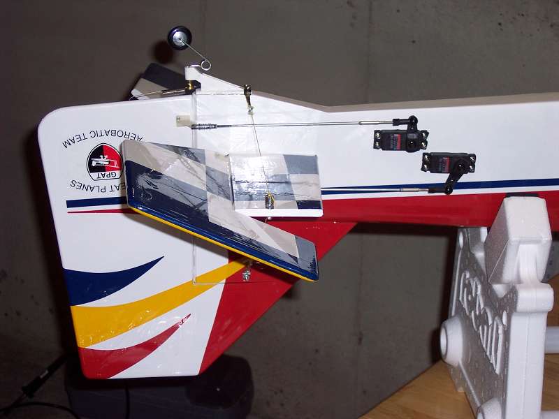

Well just finished the tail ...servos in ...radio set up for split elevators...tail brace is on....engine is on its way from chief...maybe this weekend!!!!!!!!!!!!!!!!!!

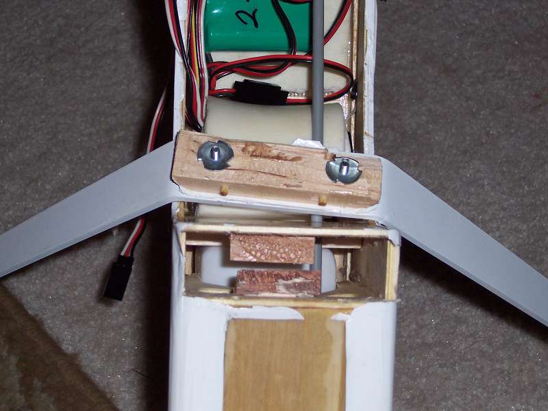

I have had quite a few flights on it, never landed hard, or had any nose overs. The only damage That was on it was from the wind blowing it off of the stand at the air feild where I fly and it just cracked the rudder on the leading edge, and tore the monkote. Put a peice of pushrod where it broke with some epoxy, and some white trim take and it was good as new. I do have a question. The plane it balanced laterly, but when I do a loop, it is not a loop it is more like a cork screw to the left. The wings stay level but it will come out of the loop to the left of the entrance of the loop IE not on the same line.

Hockey - Looks great. Do you like that style of rear wheel over the OEM better? I like the way you did the wires too.
Golden - GP sure has a design problem. Keep us posted on what their response is

Goldenclan, Luckily it looks like a nice clean break. Mine did that and I was able to put some Gorilla glue in there. Problem on most is that the block is nice and stout but there really isn't much that it is bonded to so they just snap out. Just glue it back in really well and it probably won't ever come out again.

goldenclan.. Sorry about your gear problem, Glad to hear damage
was kept to a minimum.. Most 3D planes seem have landing gear
holdimg problems, guess their trying to keep them light... It don't
help us though, when you make a landing and the gear drops out..
I'm now thinking at the very least to add more epoxy to the area
and or some triangle stock also... Let us know what GP has to say

I landing gear block had some 1/8 bamboo sticks in it also, I fighured since they were broken, I was going to drill them out and put in some steel 1/8 rods in the place. I have never used any gorillia glue, is there any thing special to do to use it?

yes I like sullivan tail wheels over stock...if you ever come down hard on the tail wheel it doesnt ripe your rudder off...tail wires are sullivan too..and thanks! trying to get a tracking number from cheif here now!

Yeah, Gorilla glue is some pretty strong stuff. Doesn't stink either but it does expand out the joint which in some cases can be good. When I used it to re-glue the landing gear block back it expanded in the cavity somewhat and made a nice fillet in the glue joint. It's hell for stout now.
