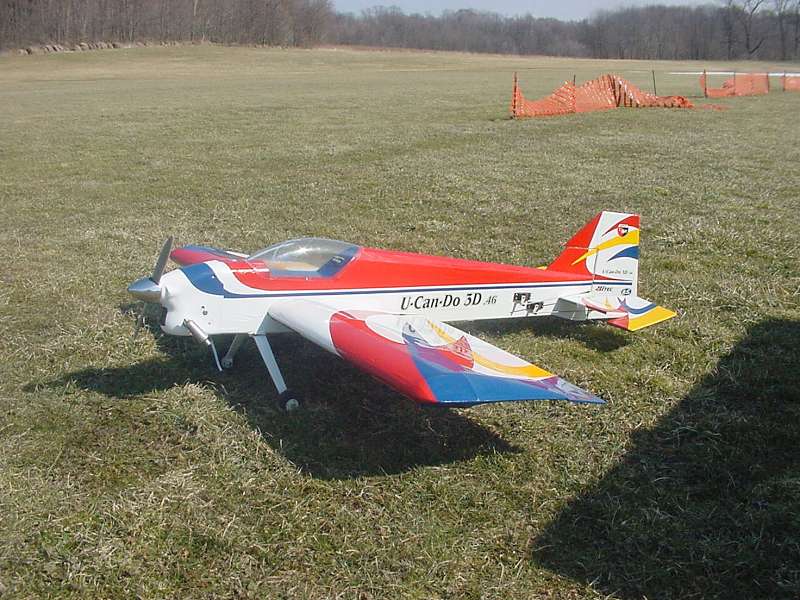

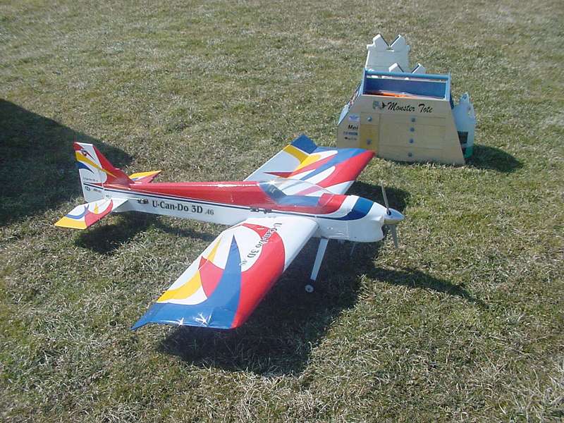

Well, I went out today and after about 6 flights, I tore the landing gear out again. Actually, the hinges on one of the Elevators broke, which laft that Elevator, just dangling. I was hitting it pretty hard on high rates when the failure happened too.
It was a hand full, but I was able to get it down. It didn't really hit too hard, but I think the nylon bolt I put in the barcket I made broke. The damage is not too bad, and I'll put a metal bolt in next time.
I attached some pics,,,,

hi perkinsm, i was wondering if the hinges were ca or other? looks like you got out alright!
good luck fixing her!

gjeffers - The hinges were the plastic ones from GP. I think the problem was that I CA'ed them in. This time I'll use 30 Epoxy.
Your right, it could have been alot worse,,,,,,,,,,

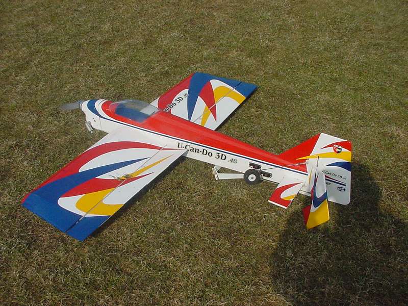

raideron - I was wondering how well your UDC hovered with a 13X4. I tried a 14X4W today on my Saito .72 I'll be the first to admit, that I'm not the best at hovering yet but, on my Fancy Foam Edge and on my G2 Sim I have hover really well. I attached a pic of my "UCD" FF Edge. These foamy's are a blast BTW.
Also, I was wondering if anyone has a certain rate/and expo that they have their radio set at to hover. I have a Futabe 9C and I usually has their rate of throw and expo set at.
I usually hover with the following: Aile 75% Expo -75 Elev 75% Expo -60 and Rudder 100% Expo -75
These are just a starting point. Any Suggestions?

perkinsm, The 14x4W is perfect for the Saito 82. The 72 would probably be better off with the 13x4W. I think you would be happier with that prop. It would spool up quicker and pull a little more RPM.
For hovering I think your expos are way off. I use expo, although not nearly that much for all 3D flying except hovering. Depending on the plane for normal 3D flying I use between 30 to 50%. With your expo you are just moving the throws to the end of the sticks. For hovering I've found it much easier to use only about 10% or even less. You want a quick rudder action and not too much movement when you are locked into a hover. This is easiest with little or no expo. Same with the elevator. But you must be very careful or you can get out of control quickly, but it is much easier to do with less expo. Also, generally I leave my ailerons on low rates and use about 30% expo when hovering. You don't need that much aileron. Especially if you want it to torque roll.

perkinsm, I can hover my UCD almost at will, She does it really easy
the only other plane I can compare it with is my 4*60, which I thought
was also easy but no way close to the UCD,,, As for the props.. I felt
like the 14x4w was easier to catch it after getting out of shape.. But
the 13X4W does good.. I mainly went back because of the spool up
time on the 14X4W was slower when I got in trouble... And I truely
believe I would have saved it if it would have cranked up faster.. But
then again the engine was a bit down on power because on the hotter
day and that was the first time I flew with the cowl on with no holes
for adjustment on the reg... But I made some now, So I may try the
bigger prop again...
I would have to agree with Barry on the 13X4W for the Saito 72.. On
the expo's My Airtronics RD 8000 does not have expo on the rudder,
I fly on Hi rates only, which is everything I can get, The radio is maxed
out too... So my expo is always on ... Elev-70%, Ail-50%

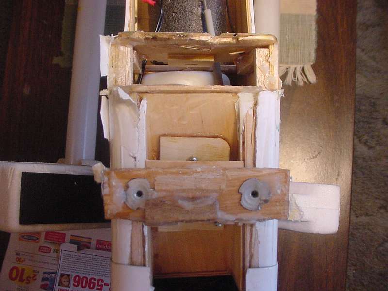

Heres a few pics of the damaged gear on mine from yesterday.
Looks like some of the other pics.
I think someone was gonna email GP, any news yet? I'm gonna email them too. [>:]

Well, I guess I was lucky when my landing gear block broke out. The scoop shaped piece in front of there broke out as well, right along the side seams. I was able to glue in the landing gear block in and then add some gorilla glue around the entire inside base of the block and let it sit untill the glue cured. The gorilla glue expanded into the seam and against the fuse body. The gorilla glue expanded against the sides and created a nice fillet. For the block to come out it would have to take the fuse sides with it. You might want to try that. Just cut out the scoop (ramp) forward of the landing gear block. Once it's out you'll have better access to the L G block.

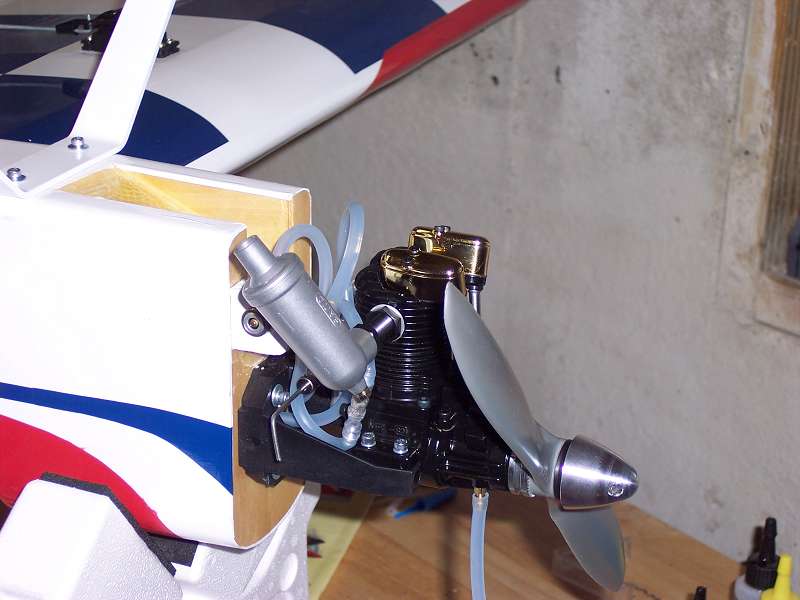

Well the engine arrived a day early...nice surprise...anyway here it is installed..tried a rough balance tonight ..seems a bit tail heavy ...battery is heading in on top of the fuel tank tomorrow night...

Man!!! That's "purdy" I love it. Maybe you should send it to me............... Good job man. I bet you can't wait to fly it.
