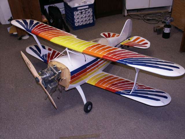

Mine arrived today. Beautiful kit. Maybe my standards are much lower, but the covering is as good as ARFs get. I personally prefer Ultracote, though.
This will actually my first bipe, so I'm a little apprehensive. I'm a little puzzled by GP's weight estimates: Christen Eagle 16-18 lbs, 1/3 Pitts 14-16 lbs. I was under the impression these two are practically the same plane. GP specifically warned about keeping the 1/3 Pitts below 16 lbs, above which the mild manners supposedly disappear. How come the Eagle is 2 lbs heavier?
Then again, they might be more different than I thought. Their wing incidences are all different. BTW, both of mine came with new "Product Improvement" brackets. May be I won't have problem with strut alignment.

Keep us informed how yours goes together. I got mine like 2 weeks ago. I also had the new brackets. The wings still didn't mount correctly. See how easy your wing fits in the saddle. It goes in fine,the TE is about 2.5" before I need to force it to bolt down..Becides that its a complete ARF. I like the flying wires are done,this will save lots of time,and the hrdware is great also.. I just want to see if mine was a bad one or not. I also prefer Ultracoat

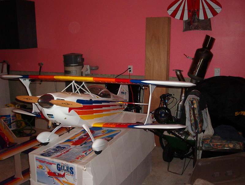

Volfy, unfortunately, I MAY not be the brightest bulb on the tree,
therefore I welcome any and all suggestions and comments. I appreciate your heads up on something I was mislead about.
Now, Xtraflyr, I really hate you hade the same problems I had, sorta proves/reinforces my comments on my first thread. I had the pleasure of assisting another flyer assemble his Eagle this weekend, it was apparent his brackets were not going to fit from the start. Sooo- After we finally got the bottom wing in the saddle and fitting properly, (that was not a problem on mine, but this one was way off), we mounted the bottom wing outer brackets 3/4 from the LE of the AIL, where the cabane struts fit as good as possable on the wing, then we mounted the top wing brackets to fit the bottom. last we mounted the center cabane. Mine missed the cowl by about an 1/8 inch, we had to notch his cowl amout 1/4 inch. Most likely that was influenced by the engine selection. therefore effecting the cowl mounting depth.
I hate this problem is more common than uncommon, I know it's going to break Flyfalcons heart.
I flew mine again Friday, Saturday and yesterday, Take offs, the plane still wants to drop the left wing and turn left taking off.???? Death spirals and Flat Spins are spectacular! Inverted flight requires very little down elev. Knife Edge- well I'm having a problem there, the plane wants to fall towards the canopy and gain altitude, I have to add a lot of ail. to correct it. Snaps-- do them high, REAL HIGH, the recovery time is scary...... Still love it.
therefore I welcome any and all suggestions and comments. I appreciate your heads up on something I was mislead about. Now, Xtraflyr, I really hate you hade the same problems I had, sorta proves/reinforces my comments on my first thread. I had the pleasure of assisting another flyer assemble his Eagle this weekend, it was apparent his brackets were not going to fit from the start. Sooo- After we finally got the bottom wing in the saddle and fitting properly, (that was not a problem on mine, but this one was way off), we mounted the bottom wing outer brackets 3/4 from the LE of the AIL, where the cabane struts fit as good as possable on the wing, then we mounted the top wing brackets to fit the bottom. last we mounted the center cabane. Mine missed the cowl by about an 1/8 inch, we had to notch his cowl amout 1/4 inch. Most likely that was influenced by the engine selection. therefore effecting the cowl mounting depth.

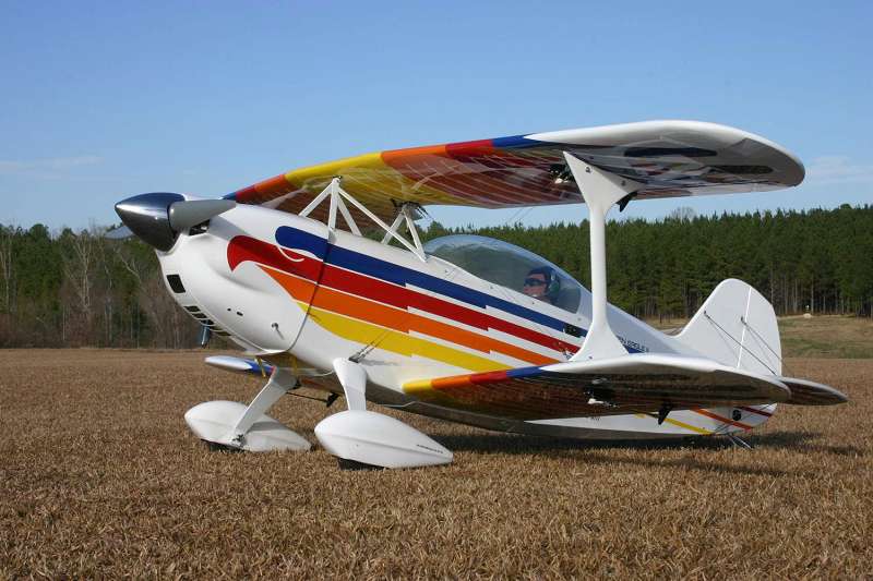

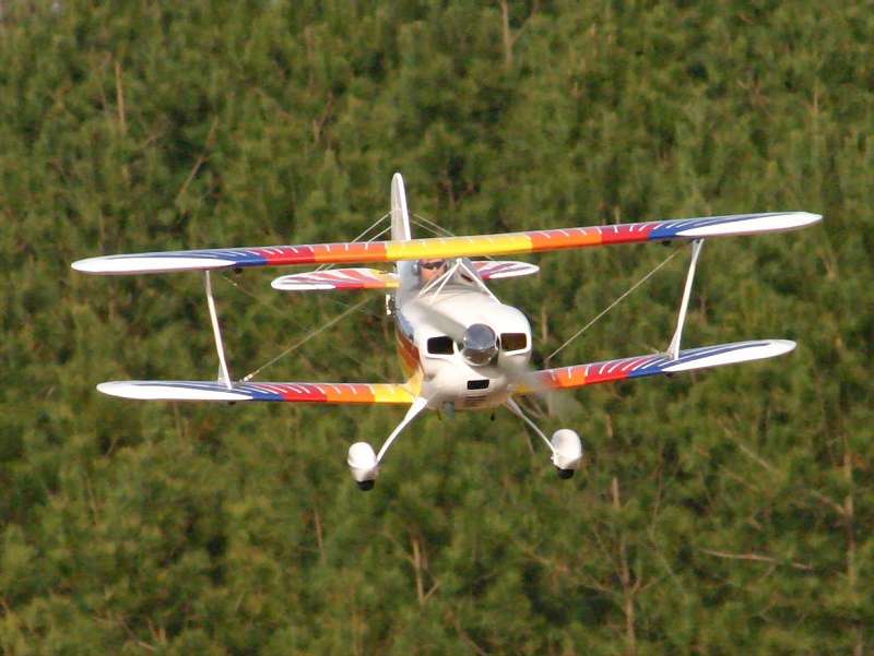

My Eagle has landed! Test flown this past Friday, all flights excellent. 18.5 lbs dry with Fuji 50 engine, no bad habits, 100% aerobatic, but no 3-D. Still flies like it is on rails.
(Notice, no strings or cropping on landing photo)

Dick, very nice shot on the landing approach. Much better than the "fake" ones. BTW, did you use the short prop hub on the Fuji 50? I have a Fuji 50 I could use, among other engines, but I find the $58 price tag for the short hub obsurd. I know I should probably wait till your full report comes out in RCR, but how about a little more detail on its flight behavior? I've heard the Eagle's close cousin, the Pitts Special, is a precision, if somewhat unforgiving, aerobatic plane. This seems to jive with Wayne's flight report. I'm no rank beginner, but I did manage to spin a GP .40 Decathlon to the ground just recently, so I'm still leery of snappy airplanes.

Yes, I used the short hub. The long one is really too long. It's a shame you can't order the engine with one hub or the other. You may want to ask Great Planes if this can be arranged. The long hub isn't even installed when you get the engine.
Flying? Nothing out of the ordinary noted, but it will take 2 full turns more after you start spinning to get out.
Keep this in mind.

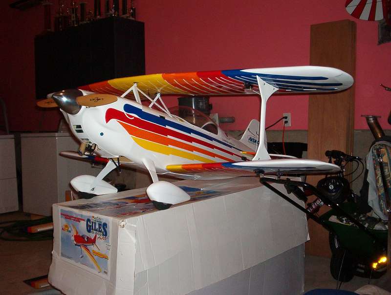

Hi texas,
Flying wire only on the stab. Not on the wings. They are not fonctionnal after
all and does not worth the extra installation time at the field. Dunno yet about
the weight but I will soon. Winter here so no maiden yet.

CG at center of range specified. Flying wires fine, but tail wires replaced with 2-56. Wheels are stock. I fly off grass so they shouldn't wear much.

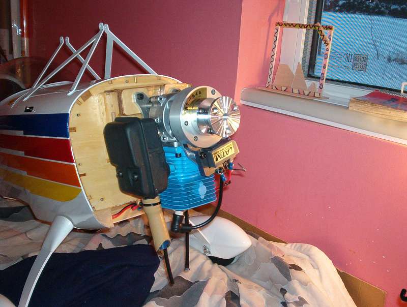

OK, the Eagle is getting close to be finished. Who is running a smoke system on theirs ? I would like to mount a TME system. Any pictures of your smoke setup guys ? Shold I just shoot for a tray with the tank and pump on it behind the fuel tank. Should be almost right on the CG there. Any recommendations ? Does it really matter if the pump sits behind the tank or not ? I want to do that for a better access to the pump itself. This is my first smoke system, so I need some suggestions here.

Tex, I have a Slimline smoke system on mine. NO Eagle should be without one !!!
Tank and pump are mounted behind the CG. I do this for better 3D type flying and when the tank empties I can still land the thing. Most important item is a smoke system is check valves, make sure you place a minimum of two in front of the muffler, and one in front of the pump. That will keep the oil from running back in the tank under maneuvers and keep the pump primed. ALSO *** Use line clamps and barbs on all tubing connections, the smoke oil is some nasty stuff and if you get it in the fus of the plane, it will migrate to your Rx, switches, connections, and you can never clean it all up.
