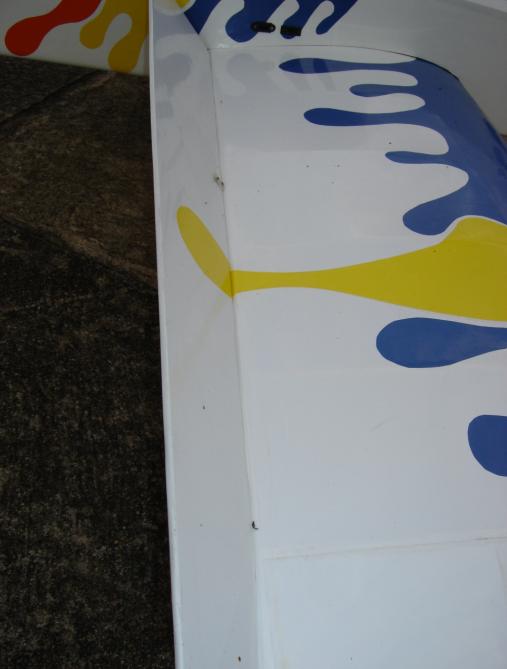

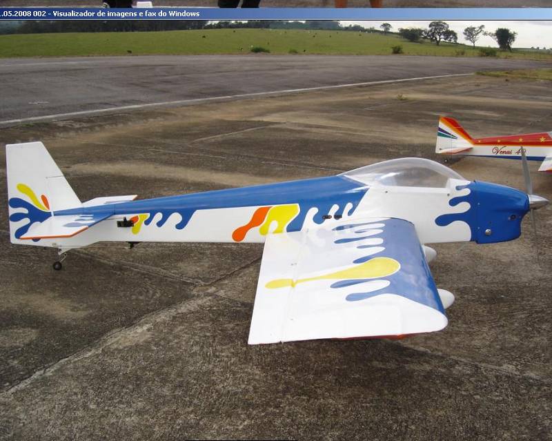

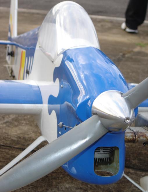

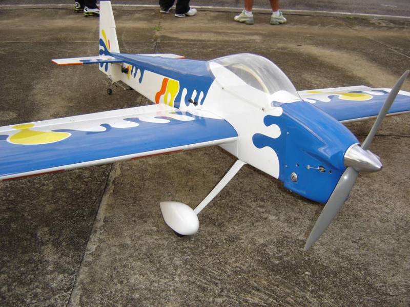

Hi guys.
I have some news that I want to share with you.
Well, my standard UCD covering just came off with time and I made a completly new covering scheme to it.
But I took advantage of my naked Do to make some mods.
I removed all the CA hinges and installed DUbro nylon kinds. Much more precision.
I also made angles in the wing's edge (the final one where the aileros are installed. I don't know the english name) to get more aileron authority. Right now I have more than 50º of deflection.
At the end, I installed the ruder servo in the bottom of the fuselage. I am using two push rods like a pull-pull sistem.
You can't believe how my plane is flying right now. It is a completly new plane. Much more 3d capable.
I will post some pics soon.
Thanks.

ORIGINAL: HoverLoW
Swap out the push rods for cable. I had pushrods for a while and the tension created by the geometry of the set up would wear out the connectors quickly and put strain on the servo and mount. cable solved that. good luck. joe

Hey, AcroJo!
Thank you for the advice. I will do that, because I am noticing the push rods are really stressing the connectors.
Here comes the pics of my new U-Can-Do.
Thank you.
