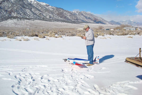

Hi guys, been awhile since my last post but i thought id share my new experience with snow skis on my UCD60. i thought that after i put these on that id have a lot of trimming to do after takeoff but to my suprise there was none needed! this plane (which ive had for over 4 years now) flew great with skis and i will use them anytime it snows now, they were great.

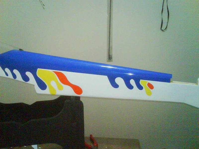

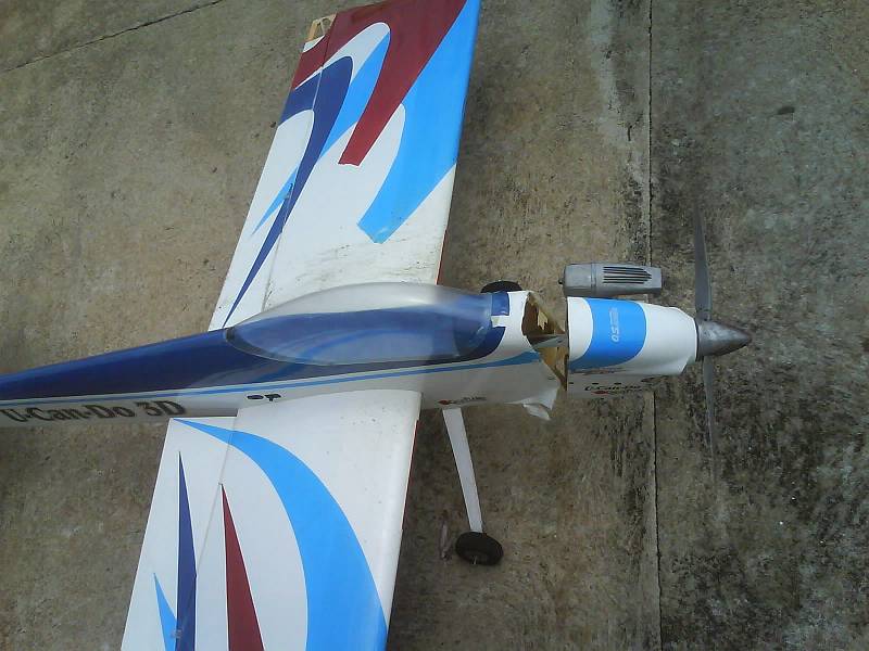

Hey everybody.
Like I said some posts ago, my Do was loosing the covering and after to loose the firewall in flight (thank God she crashed in some soft plants and didn't broke), I decided to recover her again.
Here is some pics of my cover job. Sorry the bad quality, but I took it from my mobile phone camera.
Personally, I think it's a piece of crap. At the beginning, it seemed to be a good idea. But now, looking to the Do, I don't like it.
But at least she will fly again.
Best regards!

Nice job on the covering!
Wow is the UCD a fragile plane... breath on it too hard and it will crush...
As with all ARTFs it is VERY important to go over all the film overlap joints with a warm iron and then press the joints with a soft cloth until the glue goes cold. This must be done before the model is flown. Once oil gets under the film the model is on the way out.

i like the covering job Hoverlow, looks good[8D]
i am on my third 60 size and found that they are well built but you do have to keep an eye on the firewall for separation and if caught in time you can avoid the total failure.

gjeffers...Good to see you are still flying and posting...wow! skiis!?!?!? My friends are always trying to get me to fly in the snow. Maybe one of these days I'll try it. This year we have still got a lot of snow. I'm super anxious to fly and I haven't been able to since November.
You inspire me.
thanks
Barry
