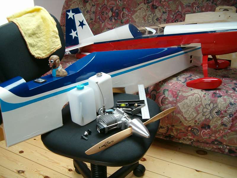

Hello all, stole a little time today for some serious stuff. Got my tank mounted on the CG. A little brace work, new throttle servo tray and a dirty used velcro strap. Thats gotta go. Ordered some "Ernst thrust plates" from Quantum Models and some HD servo arms for those JR digi's, oh yeah, also the fuel regulator from Cline. Ouch....$60.00 From what I'm told, aside from the one way valve, its just a diaphram from a carb. Put it in a case and market it for a special application like RC and there you go, sixty smackers.
Dave, it just goes to show, a picture is worth a thousand words. Joe

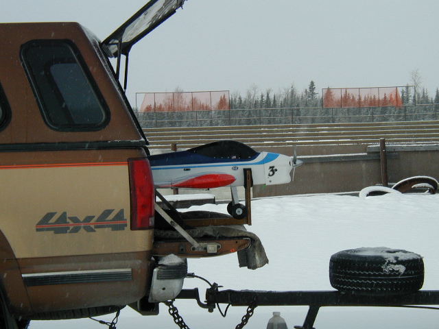

Hi LL...It's a GP spacewalker with a OS91fs ,It has a 79" ws ,sullivan 1/4 scale tail wheel assembly,I ordered a set of extra 300 durel landing gear for it so the LG will be attached to the fuse, Not the wing...It should be a nice lawn chair plane....
....JW
....JW
