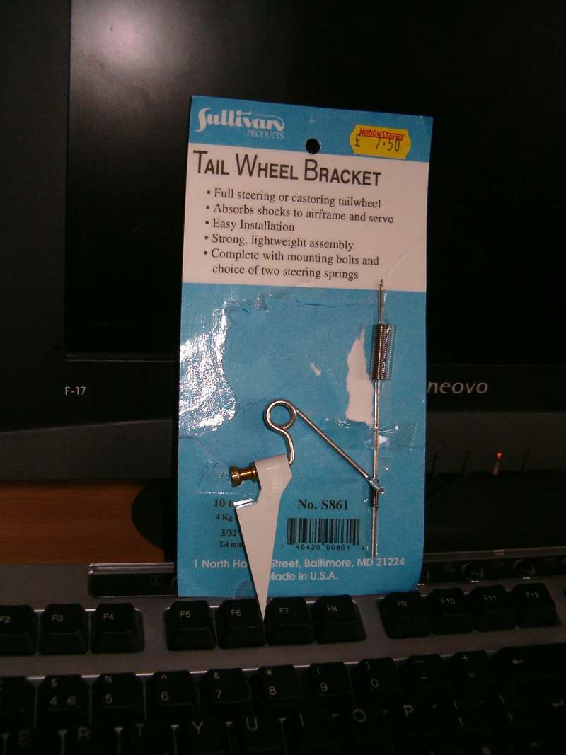

Hi Dave,
Thanks for the Sullivan tailwheel part number I will pick one up today. I also ordered the OS remote glow parts, but also picked up a Tettra glow plug cap. Some of the pattern guys swear by these and say they won't come off.

Generally, I'm only going to swap the tailwheel bracket out and use one like Dave's. I really like the Sullivan parts. No mods to the main gear, mostly following Joe's example with the Dubro pinned hinges, fuel tank to CG, fuel regulator to deal with that, Saito 100 should be plenty of power with a 3 degree Ernst thrust plate. Think I'll start out with a 15X6 APC. Carbon fiber pushrods etc. Anyone have any opinions either pro or con about using Dubro HD 4/40 swivel ball links on the servo ends?? I have some extra ones and this seemed like a good place to use them. Most of my parts should be here by the end of this week, then have the dreaded jury duty next week, so looks like the first week of May. Like I said I'm not in a hurry just want it right. Brian...

Stoney..
Great respect to you sir...21 years..got some stories to tell there i'm sure !
Looked at those ball links some time ago,in fact , used 'em on that CAP 232...the one like Autoguns has got... must admit to finding them a tad fiddly..if you didnt get 'em spot on they seemed to bind...i probabally didnt install 'em correctly
...i feel an order from Tower coming on...

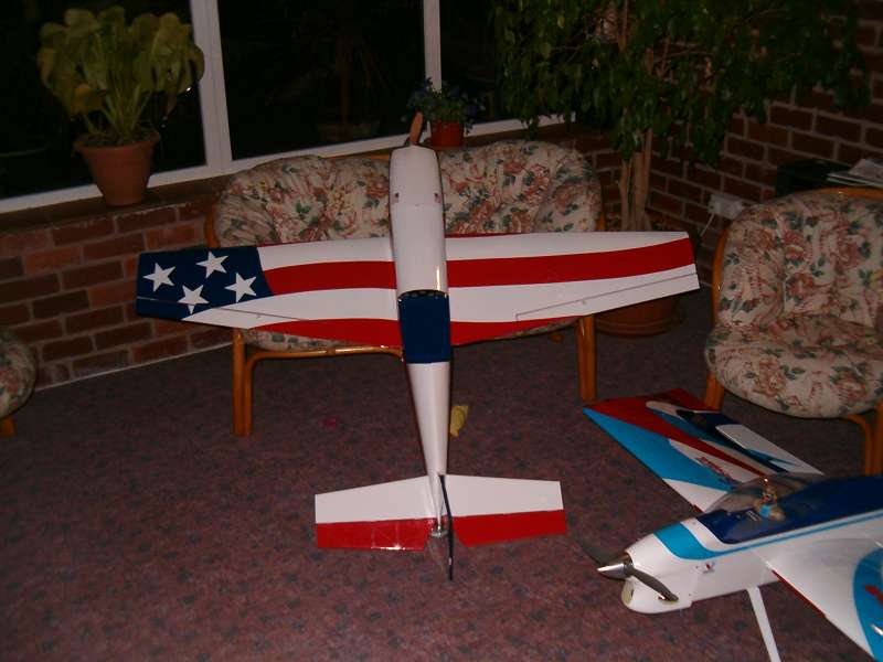

Joe...Now then..been going round the side thrust thing on the Cyclone ..virtually no room for any up front with a 1.20 welded on...but looking at the vert stab slot ,it seems some offset has been built in here Joe ,whats the Pro's and Con's of eng sidethrust Vs vert stab offset..look at foto for amount..
Finished off the trim on the Extra last night..i'm pleased with the way this has turned out..not easy, but worth it in the end...Dare'nt put it on the scales..

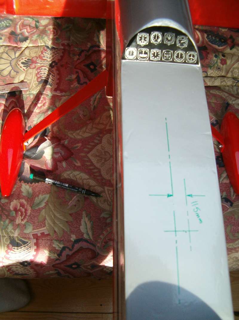

Joe, Roger, Raj, and anyone who is good at math...stab offset convesion to degree's...
Pull up a chair... At a distance of 1000mm from the rear edge of the stab, the centre line of the stab is 11.5mm off the centre line of the fuse .....o.k. so far
The rear edge of the stab is 1560mm from the prop driving face ...whats the angle of stab offset for the quoted 11.5mm, and if there was any error reading the rule, for 11mm & 12mm also...Joe..
THIS is wifey demonstrating ..
...Green marks in photos to aid your calculus...show all working out on a seperate piece of paper...
