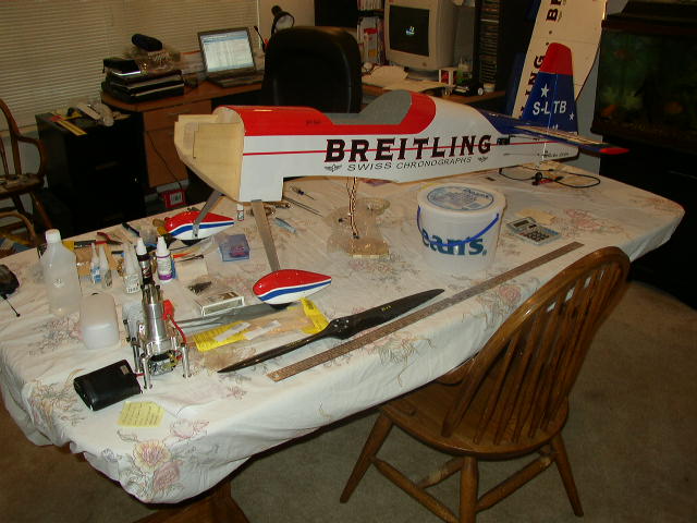

Okay...here she comes. I cant believe how fast and nice this plane builds. I have everything done now with the exception of installing the engine, reciever and batteries. Oh...and the canopy. And I ordered one of Slimlines new Extreme pilots only to be very dissapointed that its going to be too small for this plane.
If my modified standoffs are ready by tomorrow I could mount the engine and have this one ready for maiden on Sunday......... if the weather holds out.

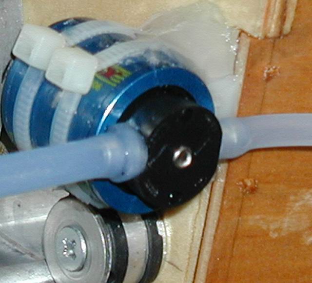

With regard to fuel tubing, see the attached photo for a good way to secure large fuel tubing on smaller fittings. This also works great for regular tubing on regular fittings.... My dad was the first I've seen do this, and I've adopted it on almost every connection I do. To get the outer tubing on, I slip in onto a pair of curved forceps and stretch it right over.
Richard...

  #297
Posts: 1,407
From: Louisville, KY
Default RE: Chip Hyde's Cap-X - Building & Flying
I learned that fuel tubing trick back in my Helo days. I always use a pair of needle nose pliers to stretch the piece of fuel tubing over your line, but sometimes you may have to hold the small piece to keep it from sliding off the pliers while being stretched. All my tubing connections get that nowwa days.
