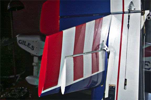

ORIGINAL: wavy777
....all i can say is be wary of snap rolls when applying alot of elevator and slow downwind turns....so more than likely it will land like a trainer.
That's good advice but I wouldn't use the word "trainer" in the same breath as "CAP". It will be one of the best Caps you've ever flown but don't get careless with the elevator.
The photo shows the total amount of low rate elevator throw I'm using and I can do violent consecutive snap rolls with it.
My CAP balances with an OS 1.60 and no lead weight.

Thanks Iam glad to hear from someone that has a moki in it. please let me konw how it goes. where did u cg it?
Old 04-07-2007 | 08:47 AM
  #1000
Joined: Mar 2006
Posts: 4
From: sacramento, CA
Default RE: Chip Hyde's Cap-X - Building & Flying
wow that is not much throw in it. It flys ok like that?
