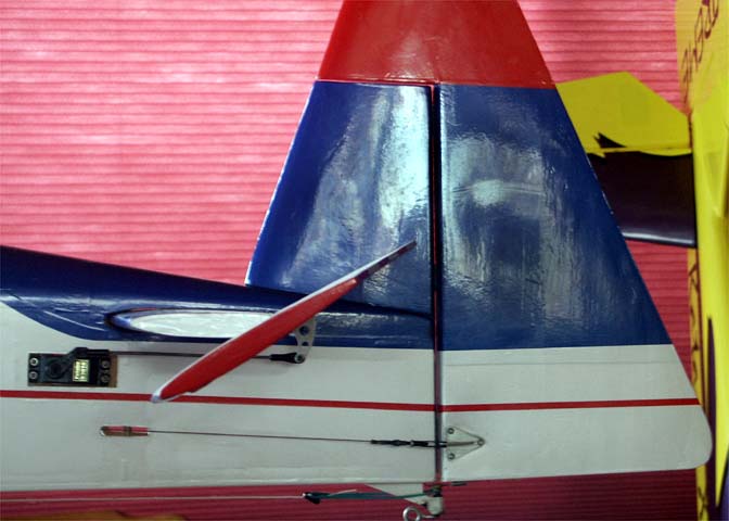

Where is everyone ballancing this plane, 3-3.5in aft from the leading edge of the tip??? or more??

Yes, 3.5 inches aft from the leading edge at the tip.

ORIGINAL: blueeagle140
wow that is not much throw in it. It flys ok like that?
Yes it sure does and that's how I fly most maneuvers. I switch to high rate for some 3D maneuvers. The picture shows full up elevator on high rate.

I am at the point of setting my throws and Chip says the elevator on high rate should be set at 2.625" up/down. Can someone let me know what that equates to in degrees? Just wondering if that happens to be 45 degrees or what. I have a CRC throw meter and like the accuracy of that as opposed to inches.

More than 45 isn't necessary(or particularly useful)... I'd set it there...

That's what I figured, just wondering if 45 degrees equates to 2.625" though. Can someone measure their throw? I'm curious.

It is measured from the leading edge of the counterbalance so you can get it pretty accurate. I found his recommendations to be spot on.
