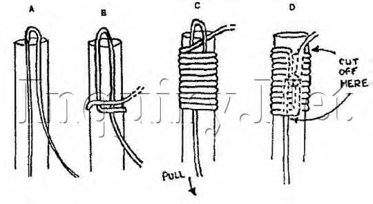

Dean, you didn't use JB Weld, hm? Then I don't understand why the carbon fiber rod split--unless, when you put the rod through, you cut one of the long fibers and weakened it. Can't see how CA would enlarge and break it. That stuff can be fragile if in any way those fibers are clipped--as with sharp threaded rods being pushed through them.
The fisherman's coil: forgive me I don't know the proper name of that knot, but most fly fishing rods have them. I googled "knots" and didn't find it. Maybe you can get luckier.
Here's what to do (if I can do this without graphics): take a 15 inch piece of very tough thread (fishermen use common sewing thread, but you can get thicker stuff, but common thread WILL work). With your left thumb, press one end of the line on the rod, starting where you want the coil and leaving about three inches of line under your left palm. Make a 2 inch loop running along the rod. holding the "top" ends of the loop under your thumb. Squeeze the bottom of the loop so it is very narrow, making two parallel lines. Then you have a thin loop running along the rod with a three inch tail under your left palm and the other, long tail, hanging down from the thumb. With your right hand, starting at your left thumb, wind the LONG tail tightly over the loop and rod time and again, going from left to right. It will look like a spring wound around the rod. Keep the coils reasonably tight so they secure the loop and don't go over one another. When you get about 1/4 inch of coiling along the rod, you'll still have a loop to the right. Take what's left of the long tail and thread it THROUGH the remainder of the loop.
This is tricky. While keeping the coils tight, slide your left thumb over them and press to secure them. Pull the long tail (now considerably shorter) tight. THEN grab both tails and pull. If you've done it right, the thread will look like a tightly wound spring around the rod. Keep pulling (but don't break the line; good luck) The coils will bunch together and the previously LONG tail will actually go under a coil or two, held tight.
Trim off both the long and short tails. Voila, you have what I call a fly fisherman's coil, tight around the rod. CA it. You can make the coil as long as you need... a quarter inch, 3/8ths, 1/2 inch, whatever you think you need and can execute.
[Maybe some good samaritan here can find a link to graphics for this execution. I don't think it's really a "knot."]
It takes some practice to keep the coils adjacent and not falling all over. And if you let the left thumb loose, the whole thing falls apart. You may want to TAPE-tack the bottom of the loop to the rod. It'll help you get started right. But it is a very efficient and super strong way to keep a split rod from splitting more. It's a knot worth some time learning, like the bowline--for other purposes.
My words seem clear to me, but I've done it many times. My wife got it on the second attempt. Try it. You'll hate me--but if you get that coil right, you won't have to worry about the split carbon fiber.
Jack (believe me, I'll hear you cursing me as you try that coil the first couple of times :-) )

Or, he can wind some good carpet thread or kevlar fishing line (spider wire) around each end of the tube and CA it. Small pieces of brass tubing with an I.D. the same as the carbon tube's O.D. and used as ferrells on each end. Peace.

Waldo, thanks for the graphic. Oddly, that's precisely the way the Model Tech 300 is built to put a horn on both sides of the elevator, driven by ONE servo. My Voyager Long E-Z has a different method to control the canard, which is really where the "elevator" is, the trailing edge of the canard. They use a rod (imagine the wing rod for the Twist, but longer) but in the middle of the rod they've soldered or brazed an arm, to which a servo in the center of the forward section is connected. That arm drives the elevator on the canard.

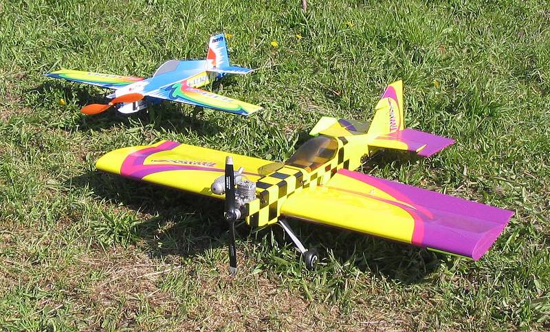

Addendum: I added a picture of Down's foamy "prostitute" next to The Lady, his Twist. I am convinced putting the Lady next to the pross is why The Lady gave him so much trouble he had to change her prop. Paybacks are hell, Down.

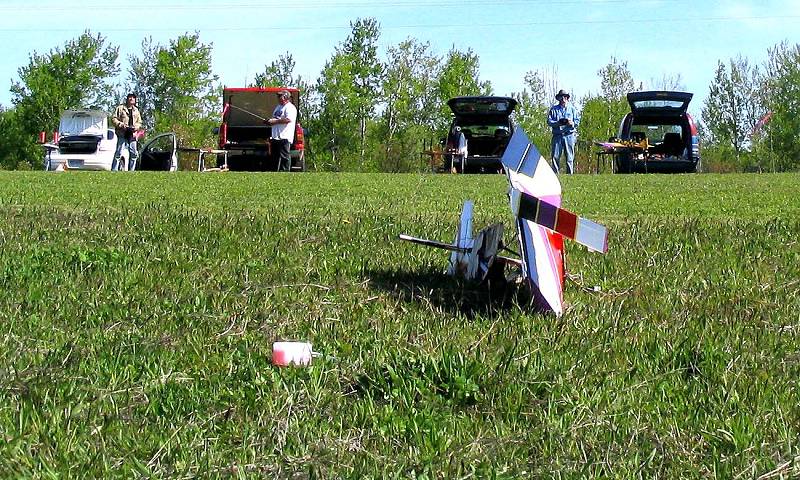

Vitually Destroyed? Obliterated, trashed, wasted, kaput! More like!
Jack. The 540 is still yours if you want it.....good plane to put together on a rainy day. I'll be home for an hour or so.
Oh, the T_ _ _ T didn't give me any trouble,but it did take a well-trained ear to hear the subtleties of pitch the engine was producing, which had me replacing the prop. Unlike Jack, I don't attribute superstition as being the force that necessitates change, but rather sound logic based on a wealth of experience. mmmmmmmboy As for the foamie, I admit she's a delicate bird, but did you notice how Carl's wife put her crosswords down and so visibly enjoyed her flight? After each flight I can handle her and not be covered in a slimy residue, and you have the audacity to call her a harlet? Look at your hands after you handle that worn-out old broad you call the Katana! You might want to wear some latex protection (gloves......what were you thinking) the next time you handle her....that way you won't catch something.
The instructions you gave me were great. I understood everything up to "take a 15 inch piece of thread. I did print the instructions and will give them to a friend who may be able to translate, as he was in the navy. I will get if figured out. Thanks for the help. I think you'll like the Extreme 330. Built one for a friend and have flown it several times. It handles really well. You may need to do some trimming to get the 50 in there. We did on his model.
I still have about 3 feet of carbon fiber tubing left so I'll probably just replace it, wrap it, and CA it (thanks Down) for now and see how it holds up to that.

Dean, you "understood everything up to 'take a 15 inch piece of thread....'" That far, huh?
Thanks, Tim, for the graphics, rope whipping, indeed, and I have used it for that purpose, too. "Whipping" is a kinda anti-intuitive name. Now I don't feel so bad not recalling it.
