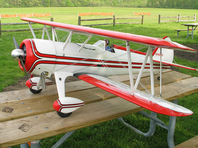

#932
Joined: Aug 2002
Posts: 91
From: Lee\'s Summit, MO
Podo,
I agree your steerman looks great! I have been wanting to add flying wires to mine also. The recommened method in the manual
is to use elastic material available at craft stores. I have not been able to find any that seems to be the right diameter to me.
All the stuff I have found seems to be to small.
Yours look great, what did you use?
Craig
Craig
#933
Joined: Aug 2003
Posts: 26
From: West Dundee,
IL
Aerosman and KCCraig ,
I used 1/16" metalized elastic cord that's available at Jo-Ann Fabrics which is a chain here in the midwest. That's the only place I found it. Tried a couple other places including w-mart. It's called StretchRite Metallic Elastic Cord. Look in the beading section of your local craft store. The cord is just plastic so there's no radio problems and it looks a lot more like the rigid steel "wires" on the real plane than the black skinny stuff recommended in the instructions.
Pete
Pete
#934
Joined: Jul 2005
Posts: 70
From: Rochester,
MI
Craig:
Here's another source for your flying wires. These look a little goldish in the picture but they are definitely Silver in real life. Good scale look as far as the diameter.
Got these at "Michaels" a craft shop chain here in Michigan.
Ed
Ed

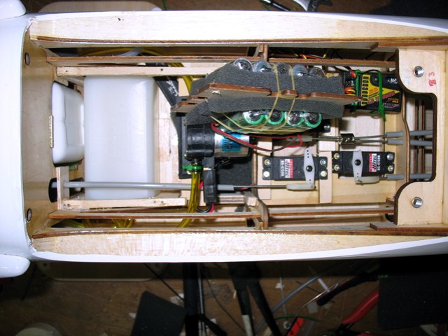

#938
Joined: Jul 2005
Posts: 70
From: Rochester,
MI
Aerosman:
I've attached pics showing the tank and battery pack locations. I'm running a 6 volt pack for the radio gear and a 5 volt pack for the smoke system. Also a pic of the smoke oil feed to the header. My brother has the PT17 and put a preheater on his but took it off since it didn't make a difference. All we did was to tap a hole in the header pipe to fit an old needle valve to use for the smoke oil delivery ... works great. No need to go with a special muffler($150). The four stroke is never going to smoke as good as a gas engine but this setup does a decent job.
Happy with the 16x8, I may try a 18x6 just for the hell of it.
Ed
Ed

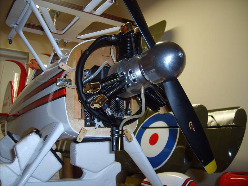

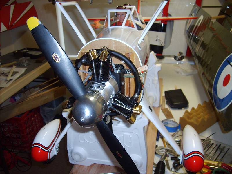

#946
Guys, I've got this plane and have been flying it for a couple of years using a Saito 170 R3 for power. It is the ULTIMATE combination! You will forget all about the cost of this engine the first time you start it. The performance is on par with what this airplane is, a scale bipe. I have also seen several of these with the G26 engine and they fly about the same as mine, BUT, the sound of the radial makes the plane!
#947
I just got one of these Stearmans, still in the box. Waiting till I move in two weeks so that I'll have a good place to assemble it. I couldn't resist the interesting technology behind the RCV SP series engines and found a very slightly used 1.20 to put in it. I figure the 18 to 20" prop this engine will swing will make it look about right and the massive torque they're supposed to have should make this thing very scale in speed. We shall see.
Kurt
Kurt
#948
rcten,
Can you supply details of how you mounted the R170? I've got one just hanging around with the same exhaust ring. It looks like you used a plywood plate covered with CF. I was going to use a g26 until I saw your pics! TIA
FB
FB
#949
FreeBird, basicly the plywood plate allowed me to utilize the exsisting engine mount holes and blind nuts, it also gave the distance from firewall to back of spinner clearance. The problem with using the 170 mount spacing is in the support arrangement for firewall and accessability to properly attach blind nuts. I also placed the throttle servo below eng. on firewall, this not only made linkage simple, it also helped with balance.
Speaking of which, balance that is, by placing 1400 4.8 sub-c ignition pack by the fuel trank and 7.2 AA nimh behind tank, the plane balanced perfectly with no additional weight.
RCTEN
RCTEN
