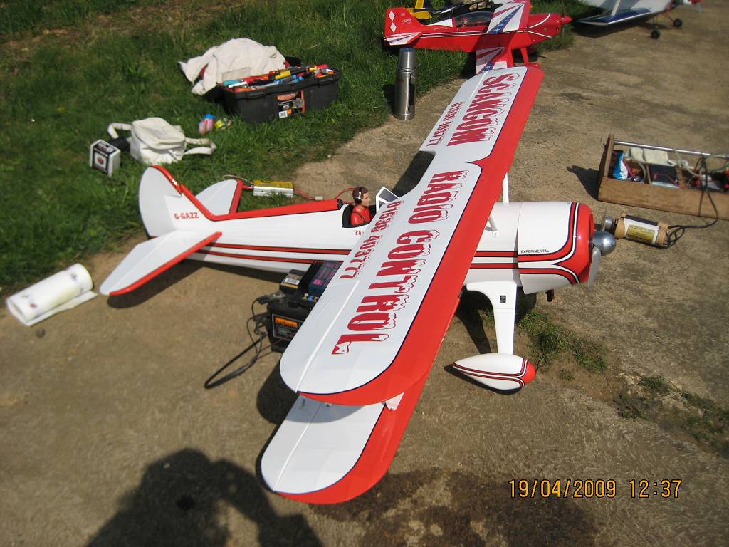

Howard, this is just mypersonal opinion but these things take enough time to assemble as is.
Mine is Saito 170R powered and I only use two servos, DS821, standard Spektrum and it is plenty for the plane.
They do not struggle and she flies beautifully, so 6kg servo's will do the job a treat and keeps it simpler!
Gary.
