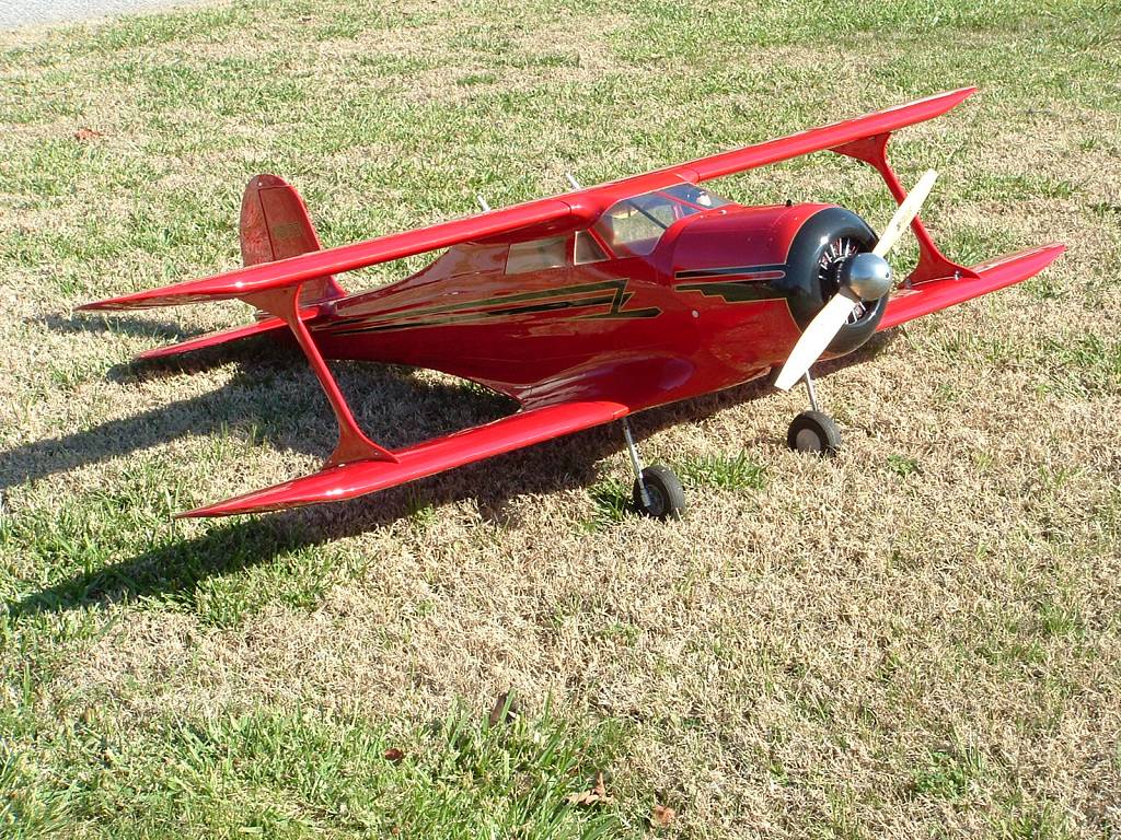

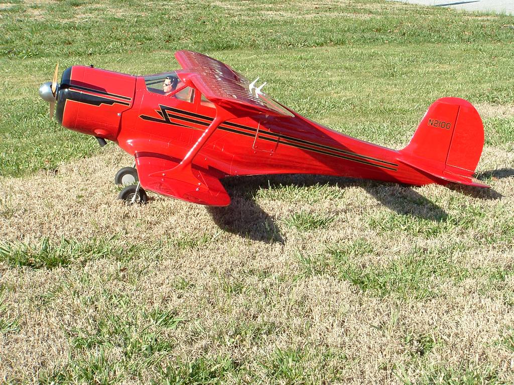

Here are a couple for photos of my SW
Regards, Jimbo
I balanced her this afternoon, had to 15 OZ. of lead to the engine mount
Almost a pound. Does this sound about right? Did ya'll have to add that much to yours?Anyway, I'll try to get some video of the flight for OL Rowdog. He was hounding me about some video footage a while back. I just hope that Super Tigre S-2000/25 doesn't let me down.
Wish me luck!!!
Regards, Jimbo
