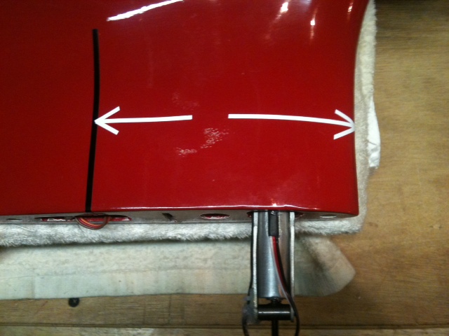

Got mine all done except for CG adjustments.
Grabbed my trusty ol' Great Planes CG Machine. I've had this machine for many years and it has worked flawlessly on everything from 10 ounce foamies up to 30+ pound planes. Unfortunately, it won't work on this plane ![:@]
It shows a cute little picture of this same machine on page 37 of my manual, but apparently nobody actually took the time to try it out on an actual TopFlite Staggerwing. The horizontal rods used to support the two CG machine bases are just too short at about 12 inches.
Easy fix !
Went to local hobby shop and picked up a 48" length of 3/16" carbon-fiber tube. Chopped the tube in half. Machine bases will now span 24". Works great now.
Bad news is, I had to add 1 pound 6 ounces to the nose. Good news is, even with the addition of the nose weight, my total weight was cut from its original 23 pounds down to 19 pounds 11 ounces. My StaggerWing diet has worked !
Bad news is, now I've got to wait 'til spring to get her in the air.[:'(]

ORIGINAL: JoeMamma
Easy fix !
Went to local hobby shop and picked up a 48'' length of 3/16'' carbon-fiber tube. Chopped the tube in half. Machine bases will now span 24''. Works great now.

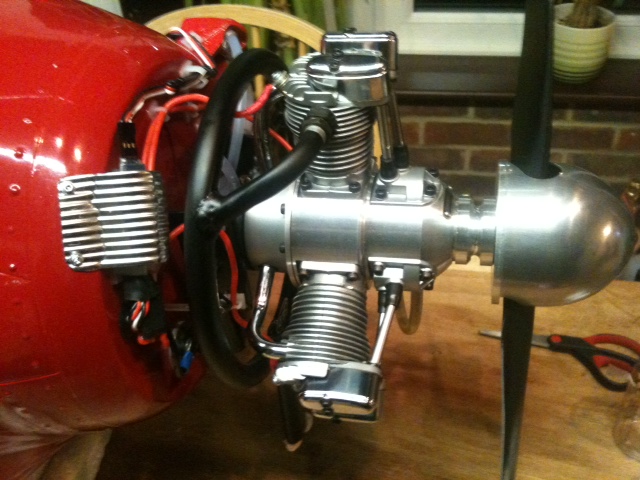

Hi To All.
I have been away from this "thread" for sometime,great to see it is alive and well !!!
I have been away from mt S/W project,details of which I posted some time ago............I have now finished her and just awaitng to do the maiden ( at long last !!! ).
I have run in my Saito 200R3,pleased to report that there appears to be plenty of power + it sounds great !!! I found out that the idle mixture was too rich,it was giving me a bit of trouble with causing a plug to "go-out" at extened lowish RPM's......I have now in addition to the "mixture" fix added an "on-board" glow system............working great.
I know that this subject has been talked about alot.........CORRECT POSITION FOR C of G !!! ........I would just like to confirm with you all that the position I have is correct by the "flying-results" you have all acheived.I have set mine to 5 1/2" from the leading edge of the lower wing.At this point she balances with a slight "nose" down attitude ( Wheels are retracted ).If I get it right,I have posted a photo of the position of the c of g.I will set about 30% expo and will increase the upper limits of the control throws to start with.
Thanks to all for the thread.
Cheers.............Nick (UK).

Nick, looking good.
Take your CG measurement right on the outer rib where the wing joins to it. You should be perfect there. Your marked position looks good.
Go easy on adding more elvaor movement, unless you have a 3 position switch, and want to add more for taxiing on grass only. Switch back to listed max movement just before starting take-off run. If you want to add a little more, 1/4-3/8 inch max. 30% expo good.
Good luck on the maiden, hopefully you will get video.

Hi Don / "Gageebees".
Thanks for your response to my "question",much appreciated..............thought I had got it right !!!
Was up the strip today,having a good fly,my club members are eager for me to maidend my S/W...............so yes,all things in place will be very soon and I hope to get the vid posted.
Thanks again.
Nick...............(UK).

Hi Guys.
Staggerwing c of g checked,should be ready to go for the maiden now,just waiting for the weather !! Have "widened" my GP balancer..........works great.It is" slight" nose down at 5 1/2" as photo in other thread.

I'D say it's too nose heavy per the photo. And will use a lot of runway to take off. And will need up trim for level flight. Just like mine.
If I were you I would remove some weight in the nose till she's perfectly level.

Hi Don / Jim.
Many thanks for your advice.....funny,in the photo,I agree it does look too nose "heavy", but in "real-life" it didn't look as much as that !!!I have to change out one of the batteries at the "firewall",so will do that first and then see what weight I can remove to get her SLIGHTLY nose down.
I have re-checked all the control throws and they are as the "high" rates as stated in the manual + 1/4"max,I 've added to them.Expo is set at 30%.......so hope that will be good.
Thank you again for your advice,all very much appreciated.......watch this space for anothe c of g pic !!!!
Cheers............Nick (UK).

ORIGINAL: njmheli
Hi Don / Jim.
Many thanks for your advice.....funny,in the photo,I agree it does look too nose ''heavy'', but in ''real-life'' it didn't look as much as that !!!I have to change out one of the batteries at the ''firewall'',so will do that first and then see what weight I can remove to get her SLIGHTLY nose down.
I have re-checked all the control throws and they are as the ''high'' rates as stated in the manual + 1/4''max,I 've added to them.Expo is set at 30%.......so hope that will be good.
Hi Don / Jim.
