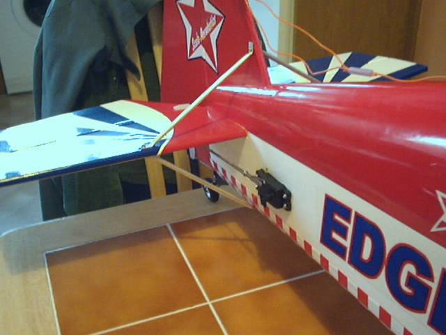

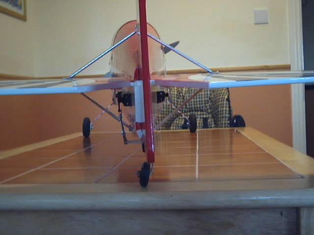

Hi gang,
as described previously, I beefed up my tailplane with the use of 2 1ft tubes of 3/16 round aliminium stock. It's super light and easy to work in to appropriate angles etc. Just crimped the ends with pliers and drilled a hole for a short woodscrew and loctited them in there.
The tailplane has a leading edge of ply or some type of strong wood but the elevator section is all balsa/poplar or something else weak. I found if I squeezed mine with my fingers it left an indentation!
Hopefully this mod should give it the appropriate strength otherwise I'll be cutting out the horizontal member and rebuilding with stronger wood.
Before fitting the struts the horizontals were a bit wishy washy, now they are nice and tight.... should all help. And hopefully no more breakages from just moving around the house.

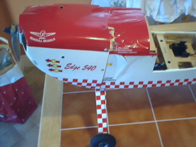

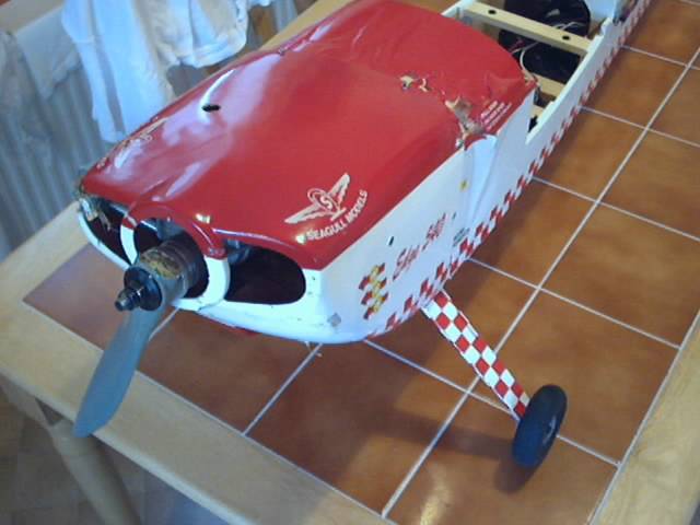

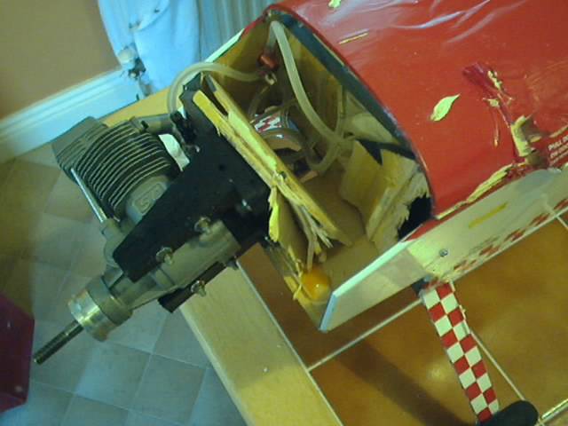

Yeah, I here you 'not again....'
sorry guys but it looks like this bird is destined for a repair once a week.
Today got some great flights in, this baby does some great moves. I had it vertical, inverted, hovering, knife edge, looping, bunting, blender etc. etc....
until......
The clevis on one of the elevator halves broke. While I was in the middle of an inverted loop (the low middle not the high middle).
Anyway, the plane went way out of control, I managed to flip it around but was in major trouble, landed up spearing the nose end in at about 45 degrees (ouch). One of those crashes where you see it hit and then you hear the crunch/bang a couple of seconds later.
Anwyay, they definately build them tough as you will see by the pics, no wing or fueslage damage. Did a great job of obliterating the firewall.. Luckilly no damage to the engine but at €25 per prop, it's bringing tears to my eyes thinking about the 16*7 that broke on it's 3rd flight and first day out....... (Who said drag racing was the most expensive hobby?)
Lesson learnt, throw away those crappy clevises that come with the kit. Well if you want to do anything more than stooge around the sky that is. I like to push my planes for performance so need to invest in a set of heavy duty ones. It probably doesn't help that I'd be over the designed wingloading and inflicting mega stress on the moveable components so I'm not complaining too much. In fact, the plane kit itself is quite cheap, the RX and motor not soo. Once I have all of the bugs sorted maybe it's time to just go and buy another one that I can build strong enough in the relevant areas/components and then it will look pristine for good....
Repair pics to follow, can't bring myself to look at it for a week or 2 so you'll have to wait....

Luckilly the whole tail section is fine, not as much as a bit of grass on the tail wheel!
no damage to the wings also, looks like a rebuild job

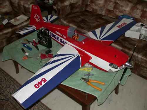

Here it is......almost ready - just the push rods need to be installed and the programing needs to be done. Test Flight is tomorrow and I am getting jitters. Please wish me luck guys....
Servos - 6 Futaba 3001's all around
Battery - Futaba 4.8v 1000Mah ( Enough
Engine - Magnum 91 FS
Prop - 14X6
Spinner - Vortech Aluminum 2.5"
Hardware - Stock
Any last minute advise before I take her up???
Cheers
