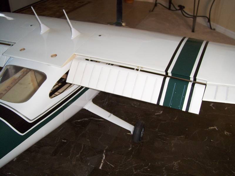

Old 09-26-2008 | 10:45 AM
  #227
roly1129's Avatar
Joined: Jan 2008
Posts: 228
From: St. Cloud, FL
Default RE: New CMP Cessna 182 .52 size

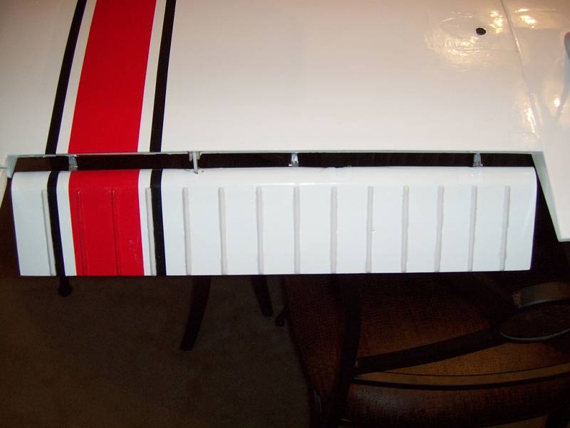

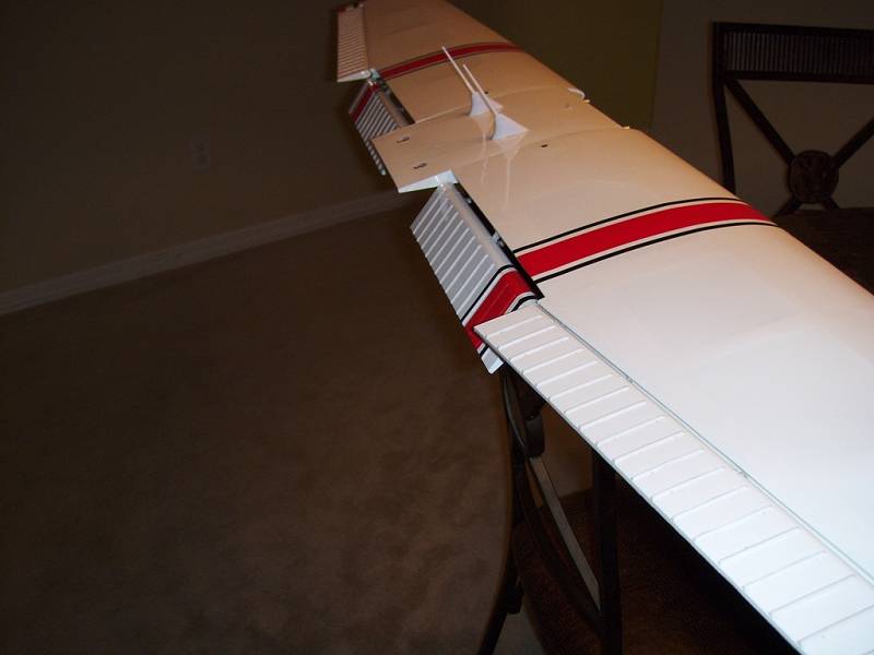

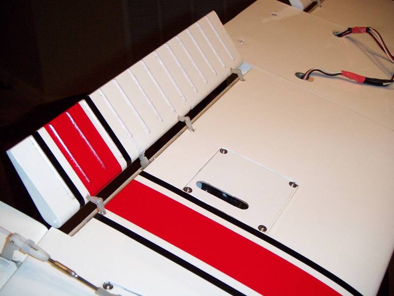

Here is my flap modification to my CMP Cessna .50

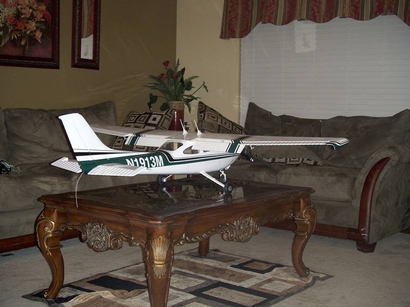

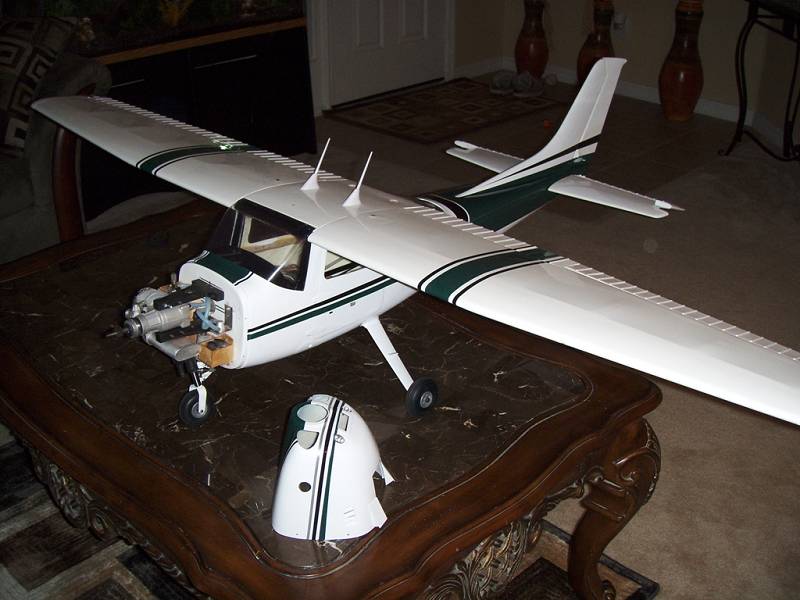

roly1129's Avatar
Joined: Jan 2008
Posts: 228
From: St. Cloud, FL

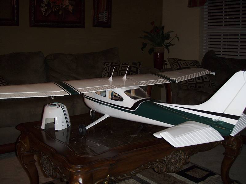

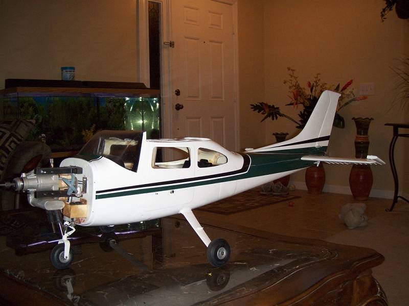

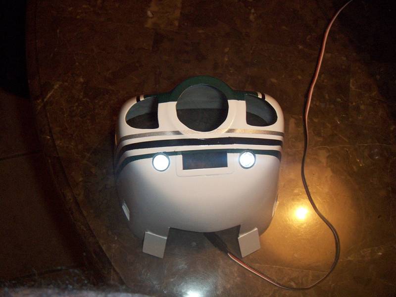

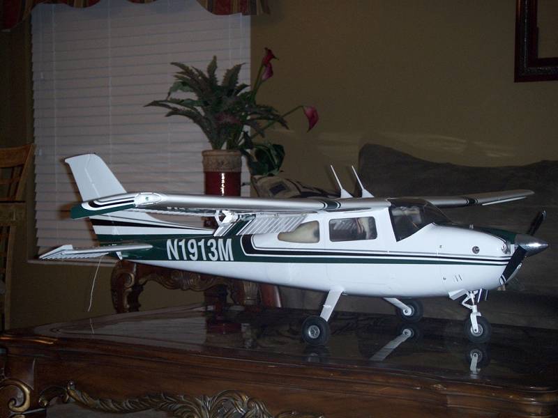

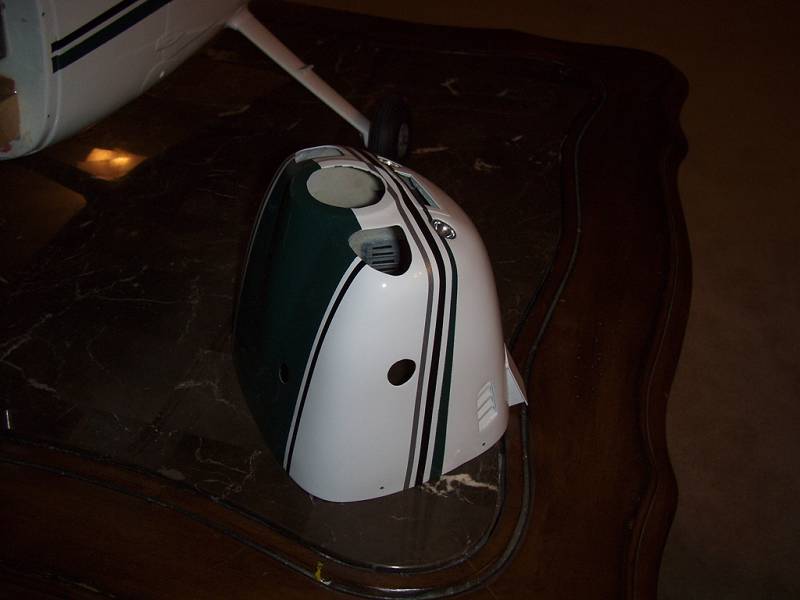

Here is my Cessna with a few modifications I did.

Old 10-30-2008 | 08:15 PM
  #242
Tracon's Avatar
Joined: Sep 2003
Posts: 221
From: Gibsons, BC, CANADA
Hi Roly,
Awesome job !!!
I'm was thinking about the exact same color scheme !!!
I love the green !!!
Can you give me some details about how you repainted her and how you stripped the old color off ???
I give ya a 10/10 !!!
Sam

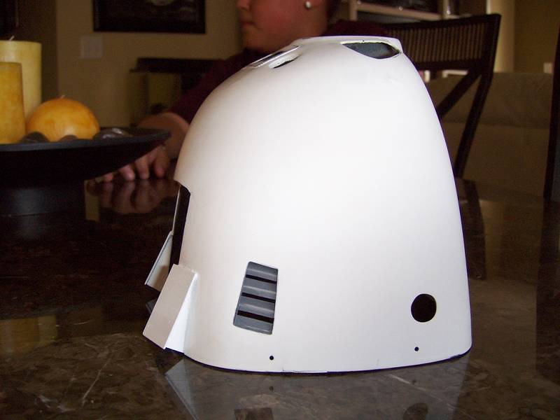

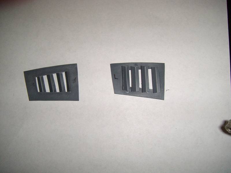

Old 10-31-2008 | 05:33 AM
  #243
roly1129's Avatar
Joined: Jan 2008
Posts: 228
From: St. Cloud, FL

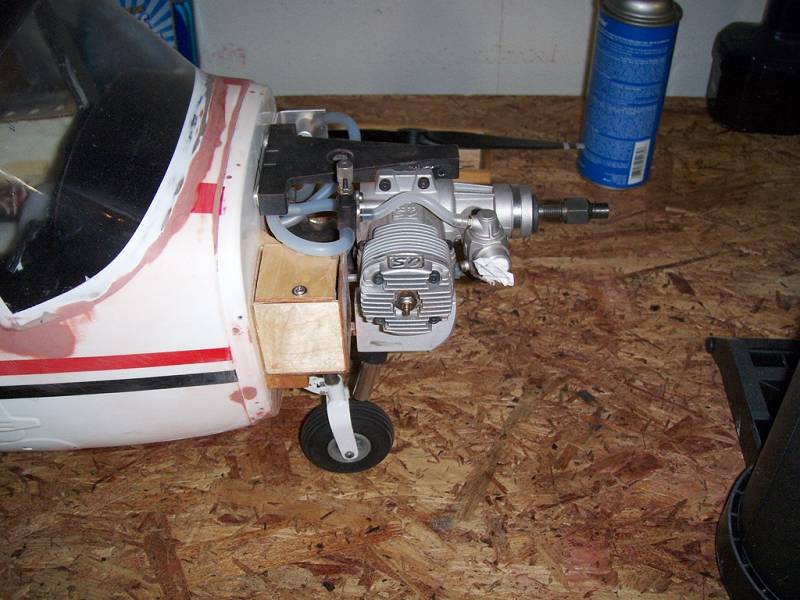

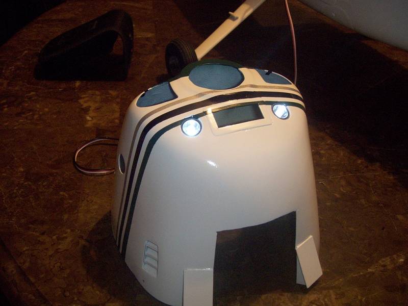

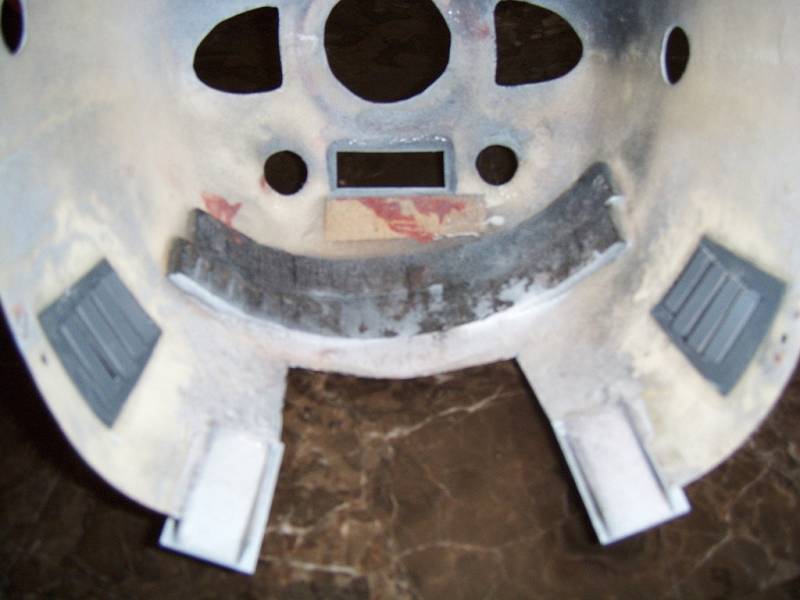

Thanks for your comments Sam. The wings, I painted over the red strip on the wing tip and the mid wing. The fuselage was wet sanded until I couln't feel the decal anymore then prime follow by more wet sanding and it is ready for paint. It is almost done just a few touch-up and the a/c registration. Also I just order the Graetplanes Cessna 182 wheel pants they look more scale than the ones that came with CMP Cessna,

How many flights did you have on this bird before you did the repaint ???
I like the way you filled in the muffler area also !

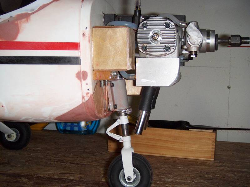

Old 10-31-2008 | 10:16 AM
  #245
roly1129's Avatar
Joined: Jan 2008
Posts: 228
From: St. Cloud, FL

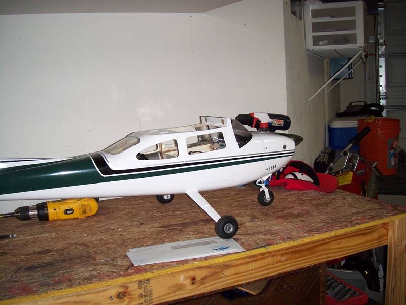

I don't know how many flight so far. I made the first flight back in March and have been flying it ever since until two week ago, when I started with all the mod's. The muffler area was fill with liquid foam then sanded. Then a final small pice of fiberglass. Then more sanding fallow with auto body filler. The fowler flaps I fallow the instructions from the TOP FLITE Cessna 182 that I downloaded from their site.

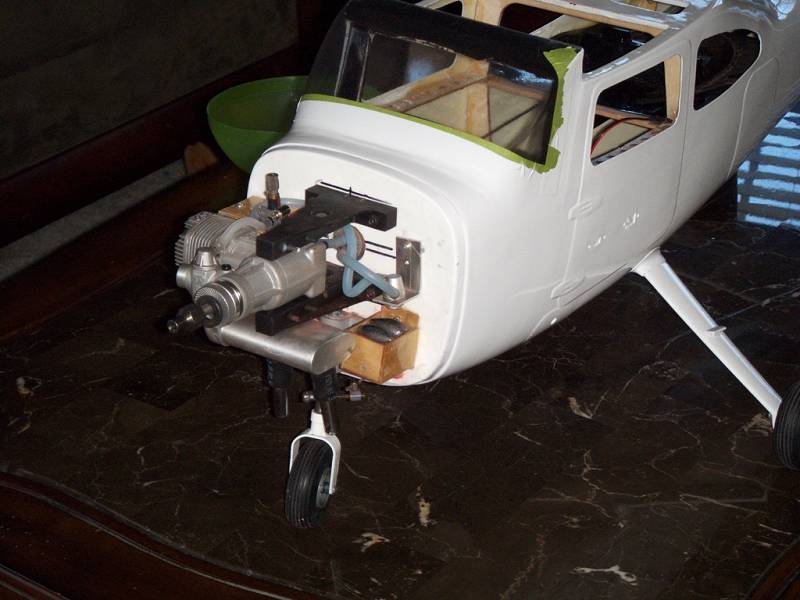

Thank for the comments Paul, Tracon and Fairplane. I have a O.S. .46 AX and is has plenty power I flight it at half throtle for more scale speed. I just got my landing lights working. Paul you Cessna is just a work of art, I plan on building the top flite kit can you e-mail me more pictures of you cessna for referance. Thanks [email protected]
