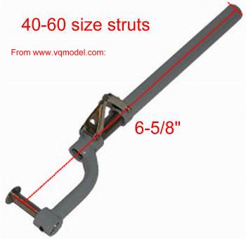

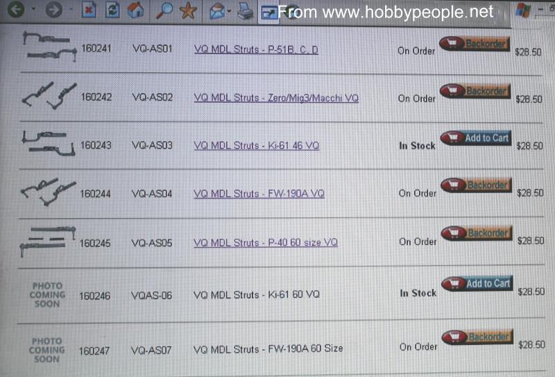

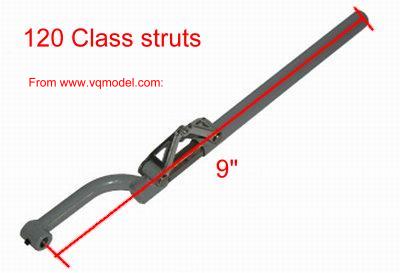

1st 2 pictures are from the www.vqmodel.com site. Shows only 2 models of struts. The 3rd picture is from www.hobbypeople.net website and shows 7 models!!! What is it? 2 models or 7 available? Can the smallest 1 of 2 from VQ model be cut down to 5 inches? The main landing gear on my T-28 is 5 inches. Any answers?

You can cut off the tops to fit. The Robarts are the same way. You might have to drill and re-tap the set screws that hold the strut to the wire. Had to on the Robarts.

The trouble I see with the smaller strut is it will not accept the wheels that came with the model, much less larger ones and should work with the wire size on the model. The 120 size strut will but then needs a larger wire diameter. Either adds a lot of weight unless you can save a similar amount of weight by the wire you remove.
I'd also think twice the shock travel would be beneficial too.

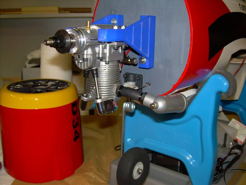

Hey guys
I have been slowly assembling my T 28 Trojan. Have the radio equipment installed (temporarily until I check CG) and put on the decals. Still have the fuel tank to install as well. I am going to use a 2 line system with a Dubro fueling valve. Wondering where the best spot to mount this might be.
Also, I have to decide on what to do with the exhaust, before I finish off the cowl. Anyone know where I could get a shorter 12mm nipple (manifold) so the entire muffler can stay within the cowl.
Also, I have these decals left over. Looking over my manual, I don't see them on the plane anywhere. Any ideas?
Cheers

I have my fuel filler mounted on the fire wall even with the carb. I fashioned a mount using aluminum angle and drilled a hole in the cowl just large enough for the fuel filler to have the head flush with the cowl. This way al the lines are connected and don't have to be removed when taking off the cowl. Saito makes a couple of different nipples for their engines. I have a couple of the older muffler exhausts so was not a problem for the exit. You could also consider a flex pipe and mount the muffler so the exhaust points down.
I didn't use all the decals so not sure where the extra you have go.
JimO

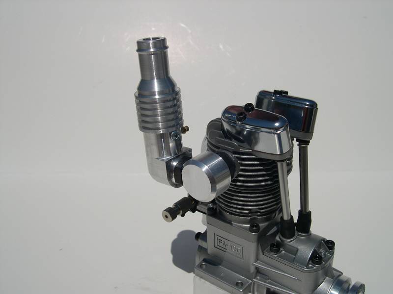

How about a Turboheader from RC Specialties? It'll also give you a couple hundred more rpm on the top end.

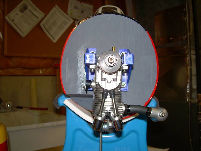

How about something like this to help with your muffler solution.? Of course, it would be inverted.
Jim
