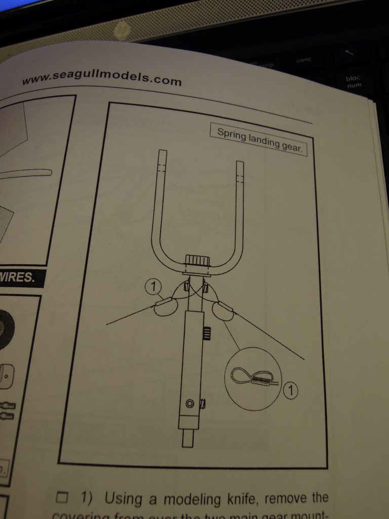

I need help with this landing gear. I got my ARF from one of are club members that suddenly passed away, I always loved Gee Bees. My problem is my cables for the gear are already made up. He never opened the box so they had to come like this.There are no instructions on how to do these and the loops are already in the cables there is no way to put them in the turn buckels in the wings. Should I cut one end loop off? They are already the correct length per the manual. Any help would be greatly appreciated.

I have not got to that part of the build yet, but looking at my instructions it appears they want you to slip the looped ends over the landing gear and up to the u shaped yolk before attaching oleo strut to the wing. Their info is very vague, and does not show you what holds the loops in place other than the two set screws locking the socket head screw holding the u shaped yolk in place. I bought a set of Sullivan flying wires in a kit, and plan to remake wires for gear, wings, tail etc. If you read this thread through from the beginning, you will see other people's modifications for this attachment, like putting a small metal hose clamp around oleo strut, and looping the wires through the holes in the clamp befor crimping them in place. Of course that means starting over with unassebled wires, unless you can engineer another way to attach the looped ends of gear support wires to hose clamp via a small split ring like keys are put on, only miniature like 1/4 or 1/2 in. Dia. Or maybe a small 1/4 in. wide strap that loops around the strut and through the loop end of cable, then is clamped in place with a 4-40 screw and nut? Just an idea. Pete

I forgot to answer your question about attaching cables to the wing. One end of the cables should be looped through a threaded rod which you attach a snap clevis's, which then clips to your wing anchors. At least that's how my instruction book shows them. I believe there a couple of different revisions of this Arf, and the manufacturer has continued to upgrade things here and there. For instance I have noticed earlier arf's did not have oleo struts included, just bent wire gear, and the wheel splats were in two halfs that required gluing together once the wire gear were installed! I know this is a challenging one to put together, and as usual, we must rely on some of our own ingenuity along the way. I guess that's the part of modeling that hones our skills;-). Pete

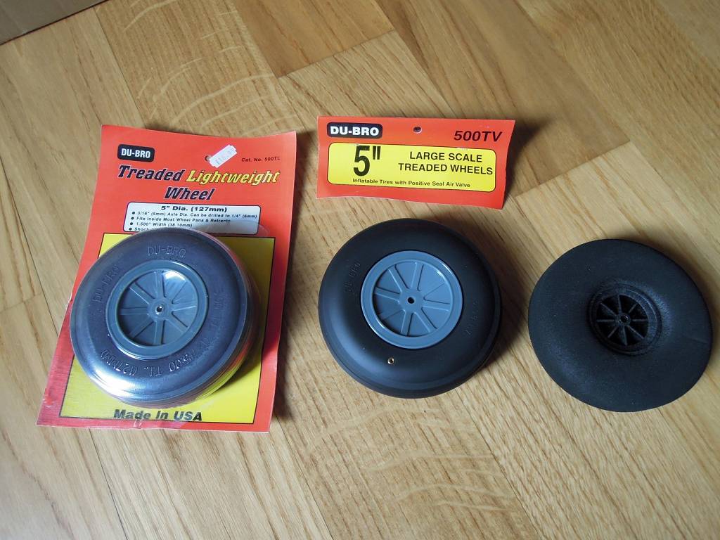

Today i've received the HUGE 5" Dubro inflatable tires.
They are a little bigger, in diameter, than the original and they weight a lot but the landing bouncing will be reduced.
Now i've an entire collection of tires to choose from.

My problem is the wires have loops on both ends.There is no way to attach them to the threaded rod and clevis. I am getting ahead of my self on this build but always like planing ahead. I may have to make all new wires or try to figure something else out. Thats ok it's part of the hobbie I actually like.

ORIGINAL: dderst
You must remove the strut from the base.

Sorry Stefano, Iam talking about the other end, were the clevis and threaded stud are.

ORIGINAL: dderst
It must be a mystery. Also my wires have loops on both ends. I've to cut the brass that stop the wires and make new loops (if the length is correct).

I was just down in my workshop and put things together temporaily I have come to to the conclusion I have to cut the loop off one end and that end over again

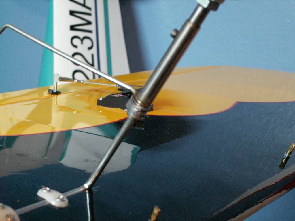

Here is how i modified my Struts to keep from turning. I got a large surface washer, had a friend of mine spot weld it to the nut ,then drilled and installed 2 1/8 screws with nuts. see photo.

That's a good idea. Did you happen to take apart the strut to see if there are flats filed on the socket head screw where it enters the lower end of strut? Mine have two set screws, one on each side holding the screw tight. You definitely solved the U shaped bracket connection, but the screw must be really secured where it enters the strut as well. On mine it looks like there might be some gray looking JB weld under the washer and socket head screw, holding the U shaped bracket tight. I guess I will just have to take everything apart and inspect how the factory assembled it to make sure it will hold permanently, and allow me to lube the internal spring and moving parts with a good teflon or graphite grease to help them work smooth, and prevent eventual rusting. Pete

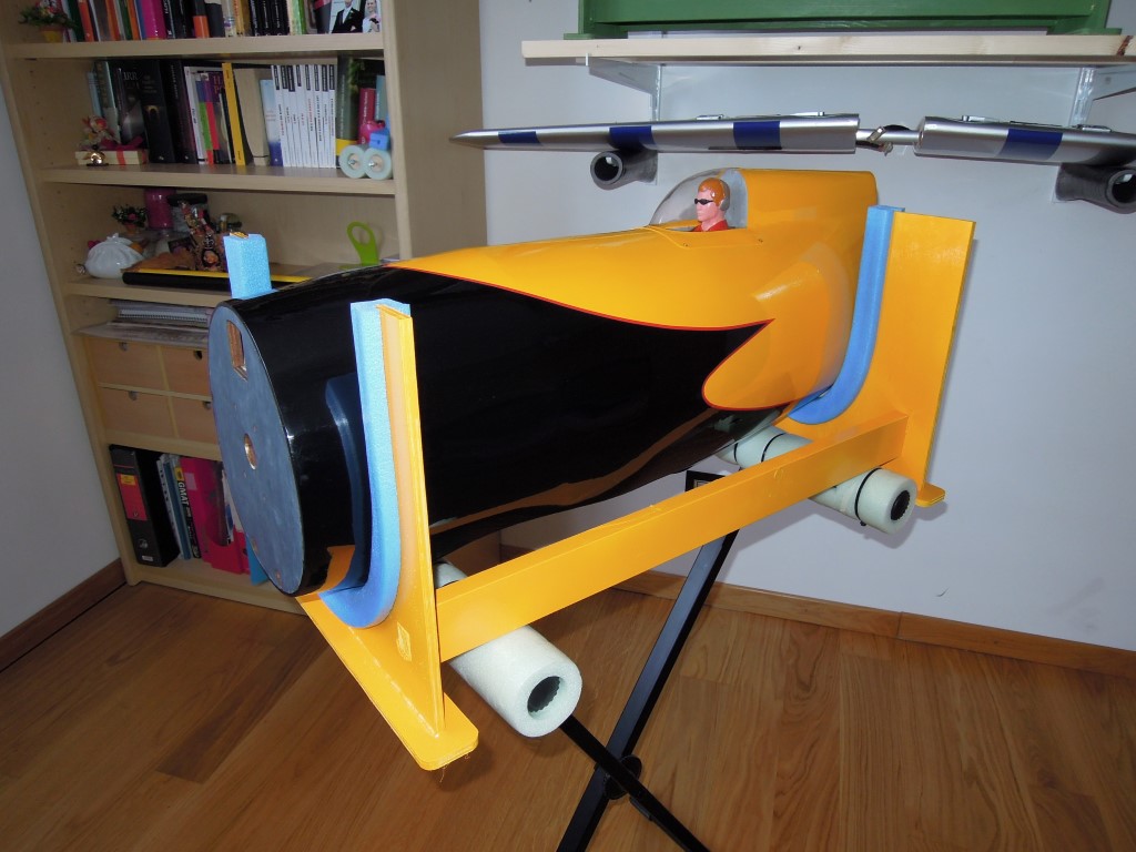

Hi guys.
This is my cradle for the baby!
And the baby with the engine on.
I'm asking myself why Seagull in the manual suggest to assemble the engine sideways an not upside down.
If i assemble the engine sideways the lateral balance is off the center on the other end if i install it upside down the lateral balance is perfect.
I'm still thinking if to going nitro or electric with an Eflite Power 110 and 9S.
Stefano

Hi Stephano, nice cradle! About engine position, all I can guess is by mounting the engine horizontally, you keep the carberator closer to the center line of the fuel tank. That ASP 1.80 fs engine is about a pound heavier than a saito 1.80, so your right, mounting it horizontally throws a ore weight to side of the plane. You could help compensate by installing battery, receiver, etc on opposite side of fuse to help balance.

ORIGINAL: clockguypete
Is the same thing i was thinking. I've to put everything on the other side. Rx 2100 2s mAh life battery, 4500 1S nimh battery for the glow-plug, RX and other.
ORIGINAL: mbgbe696
I like your cradle. Great job, mind if I copy it?
Why not? Down here you can find the original project made by a friend of mine to do this cradle that i converted.
[link=http://www.baronerosso.it/forum/attachments/aeromodellismo-progettazione-e-costruzione/263330d1361784276-portamodelli-portamodelli.dwg]dwg file[/link]
[link=http://www.baronerosso.it/forum/attachments/aeromodellismo-progettazione-e-costruzione/263331d1361784288-portamodelli-portamodelli.pdf]pdf file[/link]
[link=http://www.baronerosso.it/forum/attachments/aeromodellismo-progettazione-e-costruzione/263908d1362218219-portamodelli-portamodelli.zip]dxf file[/link]

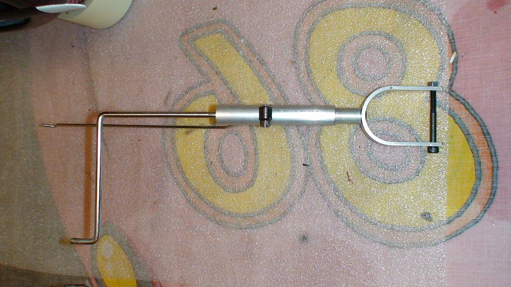

I took one of my struts apart and it only has one set screw holding the the large screw that holds the fork, but it has a small pin that comes down into the forks that I guess keeps the fork from turning.Any body else have this?
Not mine. Post a photo, please.
