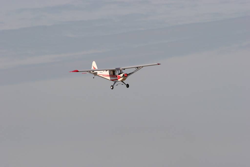

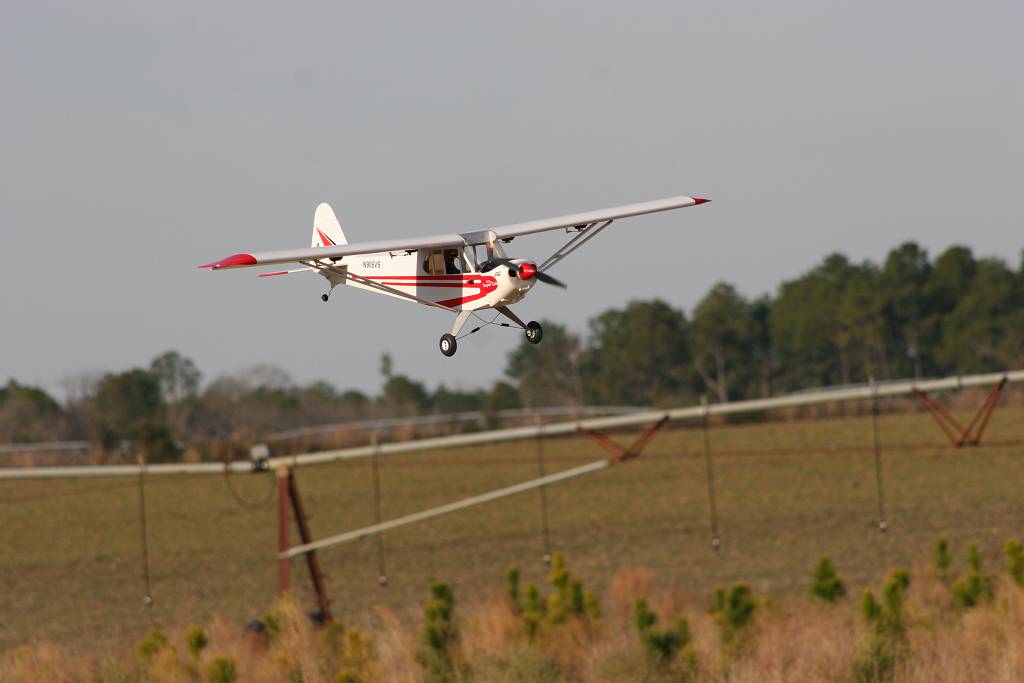

Hi John-we flew the super Cub this past weekend. It was a little breezy so I had someone with a lot more experience with cubs take off, trim it up and land it for me. It took off with between 1/4-1/2 throttle without flaps. We didn't try anything fancey but it did fly very good and stable. It has the E-flight 46 motor which is more than enough power. I don't think I'll be doing any flat spins but I might try a few standard tail spins. We had it on low rate for aileron and elevator. Terry

Congrat's Terry! Very satisfying to see your efforts resulted in a good maiden. I'm always relieved. A little progress on this end, tail feathers, tail wheel and servos installed, wing done. I'm thinking of putting an OS 70 four stroker in her, Always have had better results with OS. We fly off of pavement and it should be aiborn in about 20 ft. Big heli fly in at our field next weekend so no rush to get her done. Will let you know when I do.

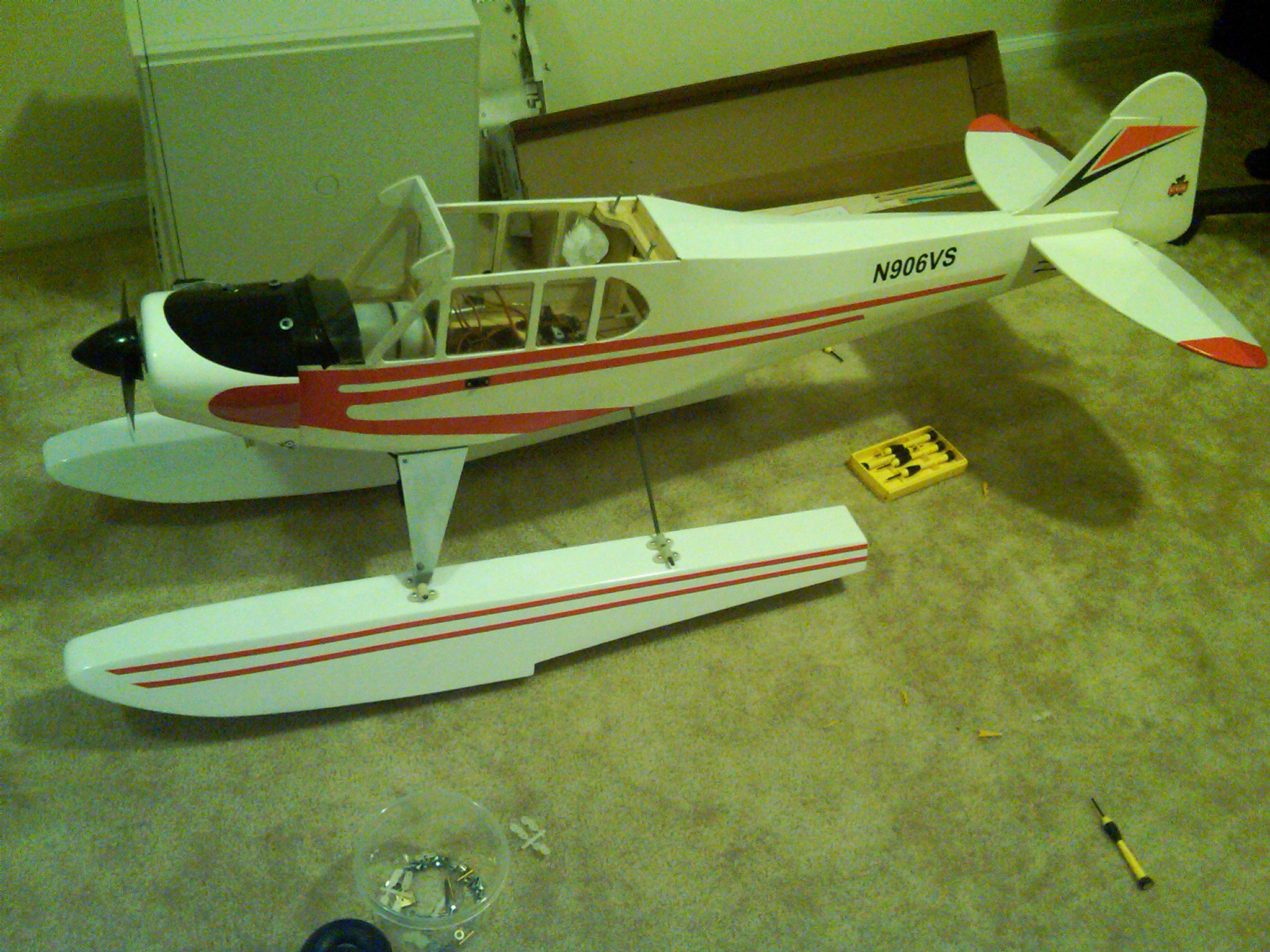

I've almost finished mounting my floats. I need a little more bracing. I may end up taking the gear off the front and making another brace like the back.

Nice job on the floats-since I live on a lake I may have to try that. What size are the floats? By the way I recieved a nice cap with the RC Universe logo on it, some RC Universe decals and a set of playing cards from them. No note attached. Did anyone else get something from them? TAPA

My floats are the Great Planes .40 sized floats. I did a little extra re-inforcing and glassed and painted them so they weigh a good bit more than needed. I am right at the high end for the .40 sized floats so I would recommend getting the .60 sized for this one (if you glass and paint them). I will post some pictures of it in the water hopefully this weekend (weather permitting).
