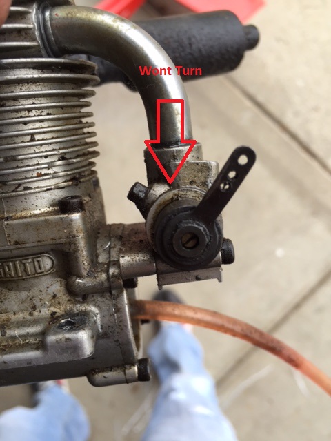

The plug didn't cross thread, but it looks like the engine did, there were little tiny pieces of metal and when I look in there with a light, it looks like the threading is a bit messed up. I have a duplicate engine, so I can probably swap out the heads since the carb is frozen on the other one, I cant use it anyhow.

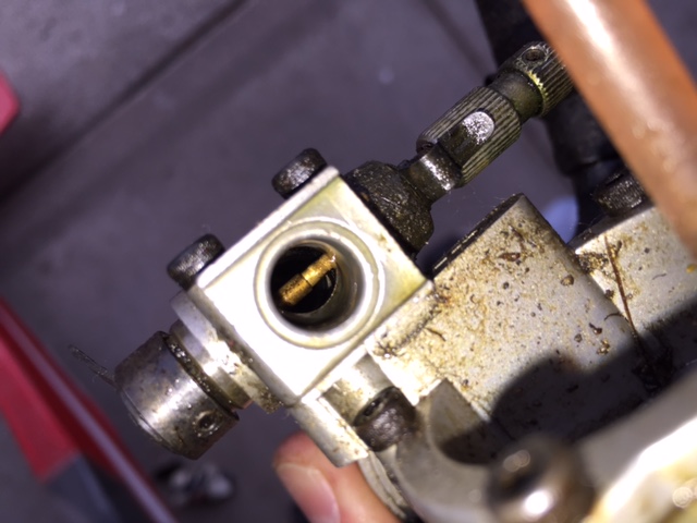

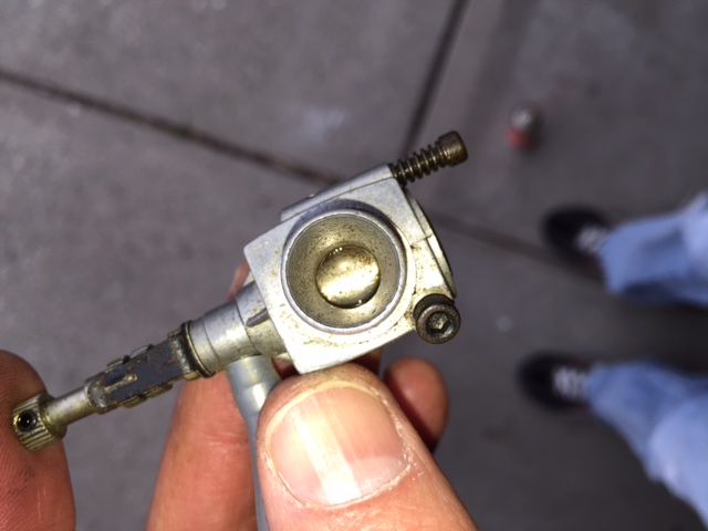

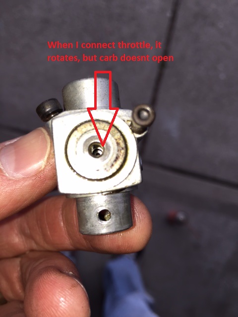

Okay so I removed the Saito and I attached 2 photos...the carb/throttle is stuck open and I cannot rotate it at all, which is probably why the servo was buzzing, trying to return to neutral. Both Saitos are locked. Am I missing something. I removed the carb from the OS to try and clean it. When I connect the throttle, it rotates, but the carb doesn't open. Any ideas...this one is stuck shut.
Okay, I may be getting somewhere with the Saitos....I saturated the carb with some cleaner and was finally able to break it loose. So I swapped carbs and put the working one on to the other engine. I need to remount the engine and fuel her up and give it another try. Not sure sure what to do with the OS though...that may be stuck, that ones just not coming loose. I will let you know what happens with that Saito

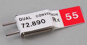

Back to your plane with the receiver that does not appear to work. If you look on the back of the radio, there should be a sticker with a 2-digit number on it. That is the "channel" or designator for the frequency that your radio transmits on. If you look on your receivers, you should see a small, plug-in crystal (see pic) which has a tag on it which also displays a channel number. The receiver channel number has to match the number on the back of your transmitter in order for it to communicate with the transmitter. Its possible that at one time, there was a second transmitter (on a different channel) that your granddad used for the other plane. If the number on the receiver that does not work is different than the one on your transmitter, you can buy another crystal with the correct channel number and replace the one in the receiver. They are only $10-$15 each but are getting hard to find now that most people have gone over to 2.4GHz systems.
For your OS carb, the throttle arm is held on the carburetor by a small phillips head screw. If this is not tight, the throttle arm will move without moving the carburetor barrel. Likely because the barrel is still stuck. Soak the carburetor in your glow fuel overnight (covered container so the fuel does not evaporate), then make sure the screw is tight, and see if you can get the barrel to rotate.

Yes I did check that and the crystal has the correct channel which is 12...same as the other receiver. I don't know why it worked ONCE, makes no sense
THanks for the tip on the OS carb, I'll soak it over night

I use heat to loosen old carbs and engines. A heat gun always does the job. RBACONS is right about the carb lever. Tighten down the throttle arm, then use heat. Don't force it; wait for the heat to work, and try it gently until it does. Then put it some light oil.

Another thought on your bad receiver. Futaba 72MHz receivers and the 8UAP radios support two different transmission protocols, PPM (most prevalent) and PCM. The radio needs to be set to match the transmission protocol of the receiver. What are the model numbers of your good receiver and bad receiver?

Yeah all my batteries (transmitter and receiver) are fully charged. I charged them last night.

So I am making progress, I pulled out the electric starter and Im able to get the prop turning as fast as the start turns, but its not starting. Also, I saw a bubble in the fuel line, so I plugged the muffler and did a few slow turns and saw the bubble moving down into the engine, so the fuel lines look good, so there is gas in the engine and the glow plug is good (at least the tester said it is) Getting closer, but something still preventing a good start.
" Chasing a starting problem with an old gummed up engine can be pretty frustrating" haha, Im finding this out =)
1. Have you set the needle valve about 4 turns open?
2. Do you know for a fact (by visual inspection) that when you are trying to start the engine the carburetor is slightly open. That is, you should be able to see the barrel open about 1/16" - 1/8"?
3. You have a fuel line connecting the nipple on the muffler back to the fuel tank?
Well I cant "see it" because its under the plane inside the body...however, when I put the throttle linkage back on, I verified the positioning so I know full open and full close and I put it at about half open. I tried the needle valve at 2, 3, 4 and 5 turns, yes there is a fuel line going from the nipple on the muffler back to the fuel tank.
