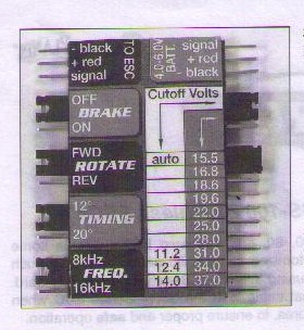

guver
My Feedback: (325)

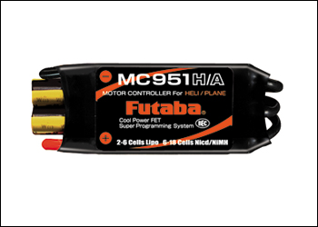

O.S and FUTABA ESC's:
Worth noting these comments:
http://www.rcheliaddict.co.uk/speed-...4-os-escs.html
cupracing: "Just noticed OS have released some escs, price and spec look good. Any one going to try one?"
O.S OCA-1100HV 100Amp 50V ESC P-OS52012100
Paulo uk: "Been sold under other names a long time, so same ESC, new label as Megapower, Hawk Fusion, SJ Propo, Robbe Roxxy (and now OS and Futaba)"
Rob O: "of interest do you think that the OS brushless motors are rebadged as well just i was going to get one shortly for one of my planks but dont want to pay OS prices for something i can maybe get cheaper "
Seems to suggest that: OS and Futaba products, like ESC's:
are the same as:SJ Propo, Hawk Fusion, Robbe Roxxy, Megapower,
-and are all manufactured by the SJ Propo company

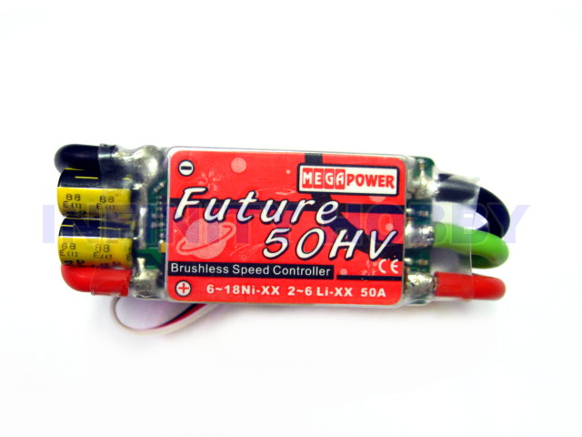

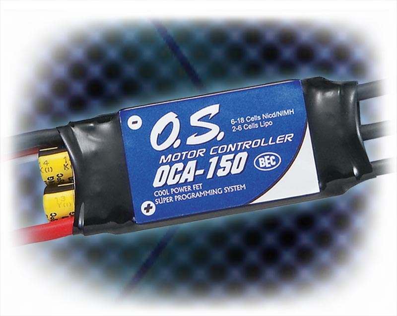

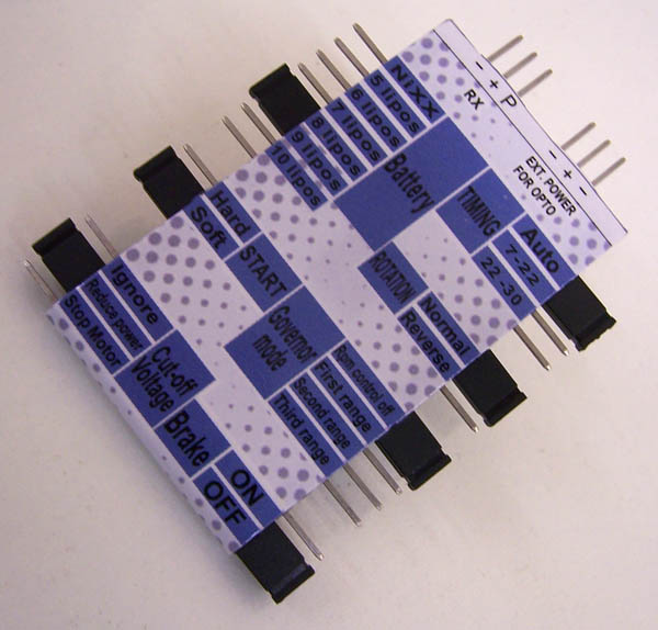

PICS OF 100A ESC's:
1st pic shows O.S. OCA-1100HV 100A 50V (HV) ESC (does not have fan)
2ndshows LogicRC Hawk (Fusion) BL100A OPTO ESC / LiPo 4~12 with fan
3rd shows SJ PROPO 100A HAWK PROGAMMABLE BRUSHLESS OPTO ESC(4-12CELL LIPO), with fan
4th shows Tahmazo Pro.C Max HV 120A ESC, with fan
5th shows Robbe ROXXY BLControl 9100-12 Opto, 100A ESC, with fan
6th shows Mega Power Future 120A HV OPTO ESC 12S with fan
7th shows Futaba MC9100A 100A ESC, Li-Po 4-12 Cell (does not have fan)
These ESC unitsare all obviously identical(only difference is O.S. and Futaba do not have a fan / heat sink) .These unitsmust all be manufactured in same factory.
Clear that O.S.and Futaba are manufactured in same factory that also makes: LogicRC Hawk, SJPropo Hawk, Tahmazo, Megapower, Robbe -and probably other brands in addition.
It is also clear from a previous post, that these ESC'sall use the same programming box -showing they are indeed identical.

PRICES OF THESE IDENTICAL 50A ESC's:
Mega Power Future 50A ESC $59
SJ PROPO 50A ESC (2-6 LIPO) $70.52 AUD$68.50
LogicRC Hawk BL 50A ESC LiPo 2-6 $74.69 £49.99
O.S. OCA-150 50A ESC (in UK) $98.44 £61.60
Futaba MC951H 50A ESC $108.4785 Euros
Robbe ROXXY 950-6 50A ESC$126.23 £78.99 (Conrad UK ...! )
Tahmazo Pro.C Max 6018 60A ESC$82.09S$102.51
(This states is a 60A ESC -but seems same as other 50A ESC's)
Once again, the price varies from $59 to $126 -for 50A ESC's which are completely identical ...
-make your own conclusions ....

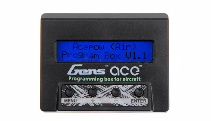

PROGRAMMING ROUTINE FOR ALL THESE 100A / 120A ESC's is as follows:
First, make BASIC MENU selections, using Tx stick
1. Battery type LiPo / NiCd
2. Motor rotation direction Normal / Reverse
3. Brake on / off (aircraft); Governor on / off (Heli); Reverse on / off (car) -refers to positions 8 & 9 in later advanced menu
4. Aircraft / Heli
5. Boat / Car
Second, makeADVANCED MENU selections, using program box -choices shown for AIRCRAFT
1. Battery Type (LiPo or NiCd / NiMh)
2. Low Voltage Cutoff Setting
3. Low Voltage Cut-off Type (power reduction or immediate shutdown)
4. Motor Rotation (clockwise \ counterclockwise)
5. Timing Settings (to enhance ESC efficiency and smoothness)
6. Soft Start -Acceleration (for delicate gearbox and helicopter applications)
7. Start Power
8. Air brake response type -Fast / Slow, or in %
9. Air brake on / off
10. Motor pole number
11. Gear ratio
12. Max RPM
13. Average RPM
14. Download stored data
15. Restore memory
16. Backup memory
-Interesting that there is noprogram parameter for selecting Switching Frequency; and no way of Restoring Factory Default (as there is for most other ESC's)..
(Also: The O.S. / Futabamanual makes no mentionof Heli Governor mode, as do all the other ESC manuals ... -but Governor mode will be used in positions 8 and 9, if the Heli mode is selected initially in the basic menu ... )
Otherwise, the programmingfor these ESC's looks quite advanced and sophisticated-compared to other ESC'slike ZTW, or Airboss / Hyperion etc.
However, in my opinion, it is not "Rolls Royce" finely adjustable programming, like one getson a Jeti Spin Pro ESC.

THE "SUNRAY" ESC PROGRAM CARD -IS ACTUALLY VERY DIFFERENT FROM THE ZTW ESC CARD
First two pics show ESC jumper program cards for an Apache ESC,and for a Common-Sense-RC ESC. 3rd pic shows the program card used for ALL ZTW (A-type) ESC's -no matter whetheritis branded "ZTW" or whetherit has another brand name onit( -there are a large number ofbrands for whomZTW makes ESC's...).
Compared to the ZTW card, the "Sunray" ESCprogram cards (i.e. Apache and Common-Sense-RC program cards) have:
-"Rx" and "EXT POWER FOR OPTO" at top of card;
-"Ni-XX" or "NiCd" and and a number list of Li cells at top left;
-Governor mode at lower rightarea (-instead of "Cut Off Voltage" on the standard ZTW card);
-"BRAKE ON / OFF" at bottom right of card (-not at bottom left, like ZTW card).
-6 pins at the top (-not 5 pins, like standard ZTW card).
-A different "look" -they doNOT have two central columns down the middle of the card, with writing placed sideways along the long axis of the card, as ALLZTW program cards do. Sunray ESCprogram cards have all the writing placed horizontally across the card, in small boxes demarcated by lines or by being shadedwith a background colour.
These features are diagnostic of a "Sunray" ESC program card -and show that a "Sunray"-type jumper card is not made by ZTW.

And now we have a list of at least some of the ESC brands made by Sunray Technology:
ESC brands that are all known to be manufactured by: SUNRAY TECHNOLOGY:
Hacker X-Pro SB series - http://www.rcgroups.com/forums/showp...96&postcount=1
Hyperion Titan V1 to V3 range of ESC's - http://www.rcgroups.com/forums/showp...25&postcount=3
Airboss Elite (Extreme Flight) - http://www.rcgroups.com/forums/showp...25&postcount=3
SonicElectric -identical to Airboss - http://www.rcgroups.com/forums/showp...25&postcount=3
Gens Ace Mars -use Sunray program card http://www.gensace.com/epages/genspo...cts/GM-PC001-A
Apache ESC -use Sunray program card http://www.anyrc.com/product_html/pr...=2&list_type=0
OK Hobby Infinite ESC's -use Sunray program card http://www.rcgroups.com/forums/showp...7&postcount=13
Common-Sense-RC-Z-series ESC's -use Sunray program card http://www.commonsenserc.com/product...roducts_id=324
Shulman Aviation FURY ESC's -identical to Airboss - http://shulmanaviation.com/index.php?cPath=290
LiPolice ESC's (Schweighofer) -use Sunray program card http://www.der-schweighofer.at/en/gr...less_governors -Program card shown here: http://www.der-schweighofer.at/en/pr...a-hv-opto%250A
Pilotage Nova-Line ESC's - http://www.pilotage-rc.ru/catalogue/75_/75_60/
Pilotage Stamina ESC's -may also be made by Sunray - http://www.pilotage-rc.ru/catalogue/75_/75_60/?flt[]=clf_75-60&page=2&count=20
BMI-Models Spitz ESC's -use Sunray program card -the NON-data log ones - http://www.bmi-models.com/#en/SPITZ_Controllor/4/1423
BMI-Models Spitz Data Log ESC's -use Sunray program card http://www.bmi-models.com/#en/SPITZ_Controllor/4/1423
Jeti SPIN range of ESC's - http://www.rcgroups.com/forums/showp...78&postcount=3
Jeti SPIN PRO ESC's -newer version of Jeti SPIN; all have S-BEC, from 11A to 66A; - http://www.jetimodel.com/index.php?page=home
Jeti Advance Pro ESC's -made by Sunray - http://www.jetimodel.com/index.php?p...=0&category=19
ELE-RC Advance ESC's - now discontinued - http://www.elerc.com/english/
JP E-PRO ESC's - (JP=J Perkins) - http://www.rcmodelcentre.co.uk/e-pro.../cat_1058.html
Watts-Up Hobbies AP 90A ESC - now discontinued - http://www.wattsup.co.nz
HDX Brushless ESC 35A - http://store.rcsupersales.net/servle...ESC-35A/Detail
Turnigy dlux data logging range of ESC's - http://www.hobbyking.com/hobbyking/s...RNIGY_ESC.html
Turnigy TRUST ESC's (45A, 55A, 70A, all S-BEC) - http://www.hobbyking.com/hobbyking/s...ming_Card.html
?? Precision Aerobatics Quantum ESC's - http://www.precisionaerobatics.com/c...cid=10&set=usa
Also:
Losi Xcelorin range of car ESC's (-use same Sunray car program card as Gens Ace and OK Hobby)
(-made for Horizon Hobby -Sunray also make all Losi and Orion-new style brushless car motors, They also make all Hacker car motors ..)
Gens Ace car ESC's -use Sunray car program card
OK Hobby Infinite car ESC's -use Sunray car program card
Turnigy "Trackstar" range of car ESC's -use same program box as BMI Spitz Data Log ESC's, and Jeti ESC's
And probably: Turnigy "AquaStar Water Cooled" boat ESC's -use similar program box to Turnigy dlux

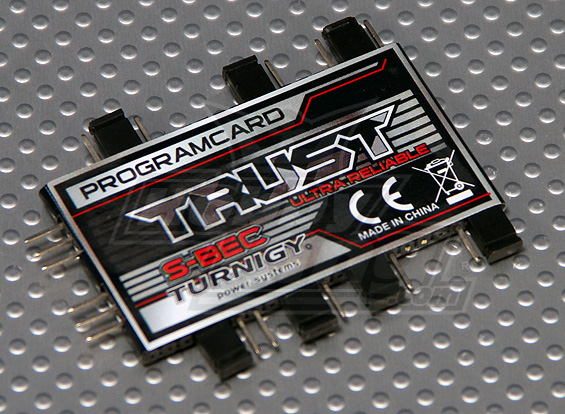

NOTE: Turnigy TRUST ESC's (45A, 55A, 70A)have exactly the same programming as Common-Sense-RC and Airbossand other ESC's -they even use the same Sunray program card as all the others (i.e 6 pins at top, Brake On/Off at bottom right etc -see pics...);-They just have no Governor Mode in position 9, so are plane-only ESC's. Otherwise are identical.
-AND:are about 20% of the cost of the same amp rating Hacker X-Pro ESC ...!
Turnigy dlux data log ESC's have exactly the same programming as Common-Sense-RC and Airboss and other ESC's; They also use the same programming box as used for Gens AceESC's( -and BMI Data Log ESC's use the same program box as used for JETIESC's..)
-Despite Turnigy dlux data log ESC's being made in the same factory as Hacker X-Pro ESC's, and despitethem having data loggingfeatures in addition to normal ESCfunctions-they are STILLonly ~25% of the cost of the same amp rating Hacker X-Pro ESC ...!
-There is a lot of smoke and mirrors going on here ....
Pics show: 1, Turnigy Trust ESC program card, back side; 2, Front side of the Turnigy Trust ESC program card

QUESTION: WHICH FACTORY MAKES THE TURNIGY DLUX RANGE OF ESC's ?
ANSWER: It is Sunray Technology (-of course ... )
This whole thread started 12 months ago, with the simple question: WHO MAKES THE TURNIGY DLUX ESC's ...?
See post #1: http://www.rcuniverse.com/forum/fb.asp?m=11215832
At the time (March 2012) I reasoned that it might be the ZTW factory.This was partly because the Turnigy dlux ESC's use a program box which is exactly the same as the Gens Ace program box (see pics). And I have never seen this particular program box used for any other ESC's. And as you will note -we thought at the time, that Gens Ace ESC's were made by ZTW.-So it all seemed reasonable at the time, and fitted together.
I suppose you can guess what is coming next. Of course, we now know that Gens Ace ESC's are made by Sunray Tech -and not by ZTW.
I am 99.9% sure now, that the whole range of Turnigy dlux ESC's is made by Sunray Technology.
This is not simply because Turnigy dlux ESC's use exactly the same program box as Gens Ace ESC's.
The functions (not cosmetic appearance)of Turnigy dlux ESC's (at least the S-BEC ones that also do data logging) are almost identical to the BMI Spitz Data Log ESC's -and we know these BMI ESC's are made by Sunray Tech. For instance, BMI Spitz Data Log ESC'suse the Sunray jumper program card (6 pins at the top etc ...) see: http://www.bmi-models.com/#en/SPITZ_Controllor/4/1423
In addition,features of the programming of Turnigy dlux ESC's are almost identical with E-F Airboss / Common-Sense-RC / Sonic Electric / Gens Ace / OK Hobby Infinite ESC's (i.e "typical Sunray brands" of ESC) .
Also,some features of Turnigy dlux ESC'sare similar with Jeti SPIN ESC's, and Jeti SPIN Pro ESC's.
-This will all be demonstrated in future posts in this thread.
Pics show: 1, Turnigy dlux ESCprogram box; 2, Gens Ace ESC program box
-the buttons on these program boxes do different things, but important pointis that the boxes themselves are identical ...
