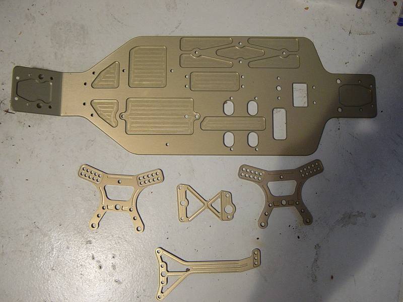

As the title says.
DrHonda has kindly offered to machine up some stronger than stock, 6061 grade aluminium chassis sets, based on the very rare JT chassis (but in shiny silver) - photos of the JT chassis below. Any suggestions for mods to this setup should be posted here, and we will see what we can all come up with.
If there is enough interest then, as per the ARO shock towers and ARO hexes it will go ahead, the more wanted, the better. With one of these chassis' as a good solid base, u too can have an overpowered, go-anywhere, giant killing, pass anything beast like mine!
No timewasters tho please.

the ARO chassis with both top plates will be around 260g give or take 10g or so, as thats the weight of the JT chassis and plates. its so similar to the stock and the ARO design (so far) i cant see there being much in it, certainly nothing that will affect performance to a noticeable degree.

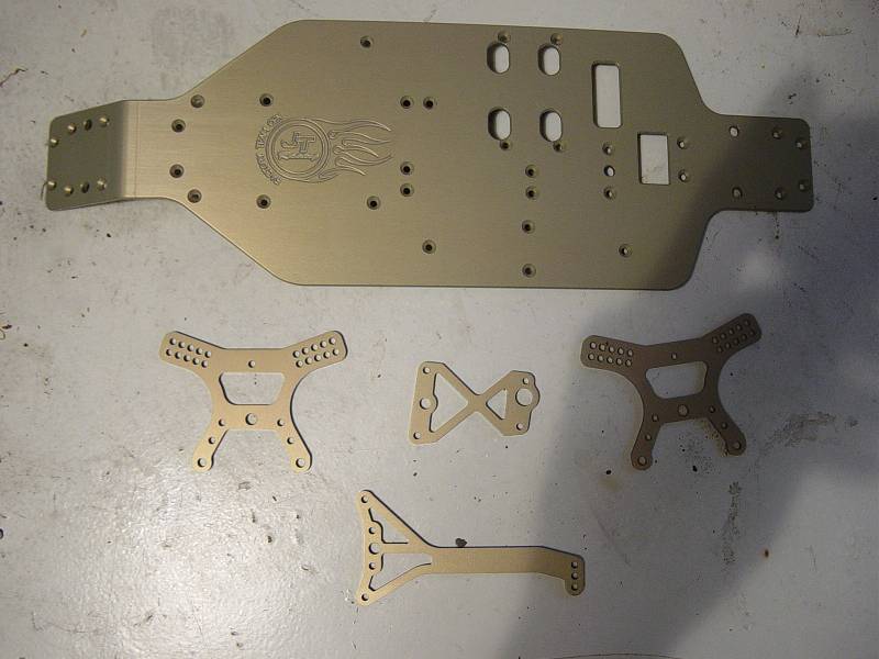

The stock centre shaft will work - its fitted to my JT chassis - it just needed some short bits of fuel line in the front and rear cups to help keep it in place. I did the Diff Cup Mod to these cups too, just to be sure.
The one I have drawn up is as per the JT chassis - 7mm longer than stock, yes it sounds a fair bit, but it can be lost in the way the cups are fitted - ie slightly more inboard - along with the fuel line.
Ive heard very little about the Magnums length or centre shaft, so Im in the dark too as to how long its chassis and centre shaft are. If anyone knows, or has one, please let us know.

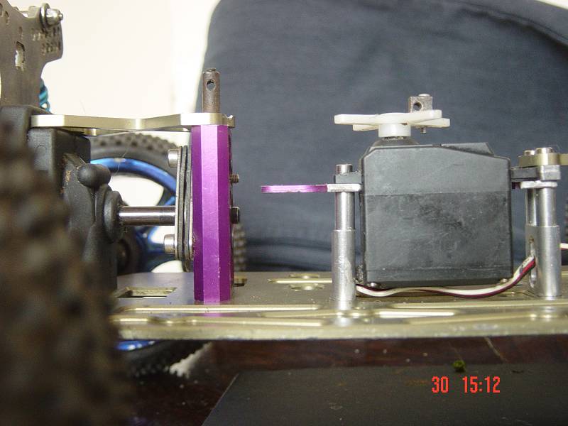

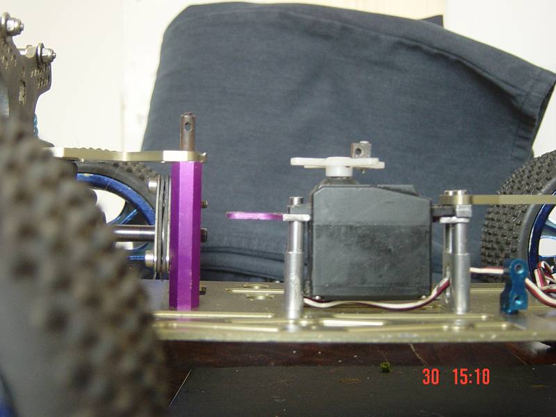

I need a picture of a stock FF, from the side, looking at the throttle servo. I also need a top shot of the throttle servo. The pics need to clear and in focus… and only of the servo and surrounding parts. (don’t get too far away, or too close)
I will disclose my idea shortly… and it may be added into the chassis kit!!

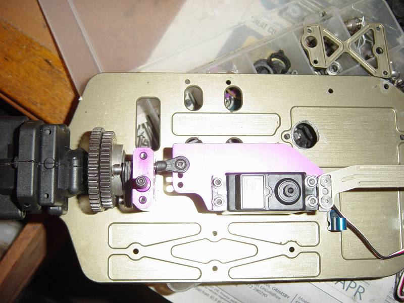

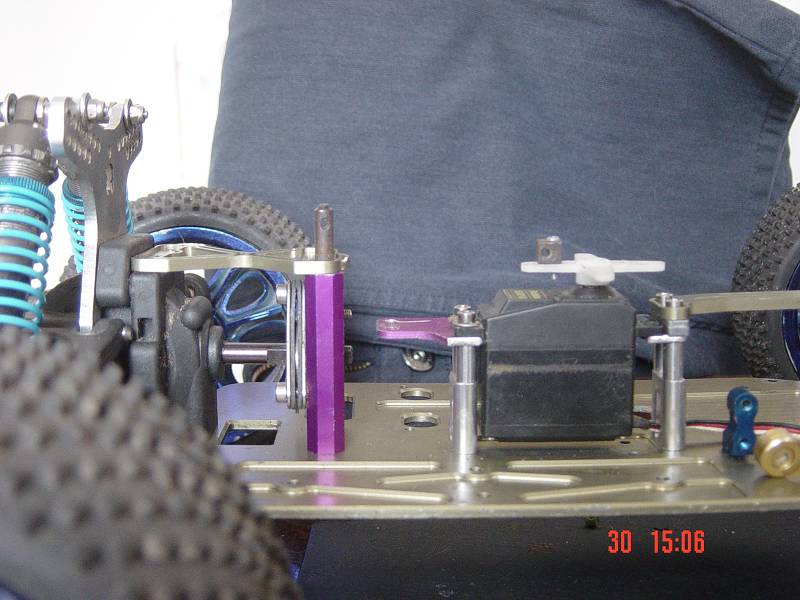

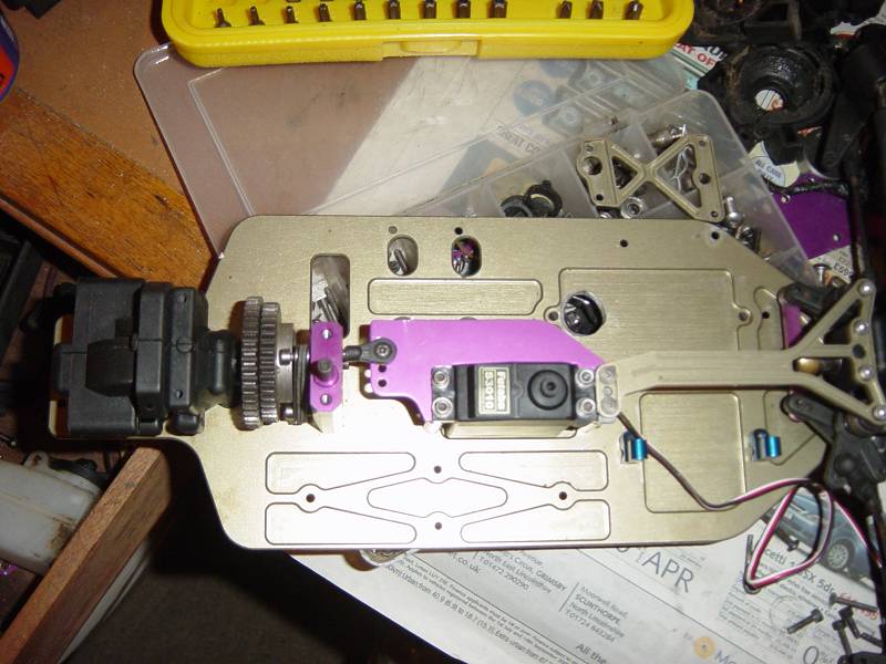

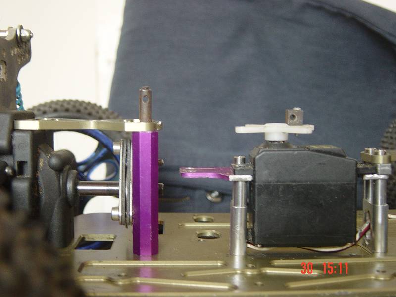

DrH - the drawing I have sent you is already stretched from stock, by 7mm. I wouldnt be surprised if the Magnum chassis is around 7mm longer than the stock FF chassis, and I expect it uses the same shaft as the FF, but Ill try to find out. I wouldnt get too hung up on the centre shaft length if you are planning on working from the drawing I sent. Having said that, it would be nice to know the length of the Magnum shaft. But the stock FF shaft WILL work on the stretched drawing I have sent to you.
As a point tho - FunFactor spares are a lot easier to get hold of than NX or Magnum bits, so I would prefer to stick with FF parts.
The rebates are not necessary, but look nice. I left them out due to cost, and people having slightly different arrangements on their chassis'. They dont let stuff sit lower on the chassis as all the mounts are the stock ones - so they are pretty pointless rebates really.
My truck is still completely stripped down, but I do have these photos on my hard drive if they are any good to you. I cut that purple piece from the stock FF front top plate, it does help a lot, but doesnt cure the flex on its own - is that the kind of thing you were thinking?

Poor judgment…
OK… good point about the NX parts. Lets stick with the FF parts, and the JT sized chassis. If CEN gets NX parts out to market… and enough people want the chassis stretched even more… I guess I can make a change later. A few mm’s isn’t that hard. I’ll just leave enough room on my tooling fixture to allow for the stretch.
Also, thanks for the pics. The two top shots tell me what I needed to know… but I need a better… well, a different side shot. It needs to be more at 90 degrees to the chassis. (straight side shot) I think my idea will work! I’ll check the other thread for a picture.
Lastly… I'm most certainly using your drawing. You do good work, and I don’t have a truck to measure from. You will get full credit, and the prototype.

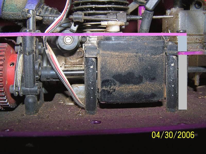

Hi all,

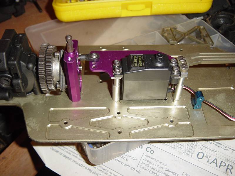

Well… here’s what I was thinking of. Basically the top plate will extend over the servo, with the servo wheel (the arm) coming out above the plate. Then it will tie into the chassis again via an aluminum block, and bolts running threw down to the chassis pan. (or servo block) What do you think? (it’s just an idea at this point) this will tire the rear and the front of the chassis as stiff, and compact as possible. The picture I got is of a stock FF… but Poor judgment’s picture looks like that may not work. Give me some input guys, so I can start to move forward with it.
That's a very interesting idea. The benefit of the way you did it is you don't have to worry about bending the aluminum brace. Just use longer screws on the top plate. That just might work.

Only thing I'm thinking is that the screw going into the plastic front steering servo mount mihgt strip easily.
However, It would be easy enough to take the Top plate support bars and use them there instead of that plastic and then cut the plastic down for the servo mount. It wouldnt require any extra parts except 2 top plate mounts...
That didnt explain it at all.... my bad..
Heres a pic.
Heres a pic.

my servo mounts are a bit lower, thats the issue there, i didnt think they were as low as that - many apols.
it looks like a good idea to me too DrH. Dustin covered what i was about to type. only thing i can think of is that there will be a fair bit of leverage against the long screw thru the extended top plate. that can be helped by making a kind of butressed alloy block maybe? something like my fantastic pic below? sorry, i love the airbrush tool on ms paint too much
or could we simply use 2 blocks, one to each servo mount?
alloy servo mounts would help loads in either case... just a thought - maybe a kind of "Stage 2" hop up perhaps...?
.or could we simply use 2 blocks, one to each servo mount?
