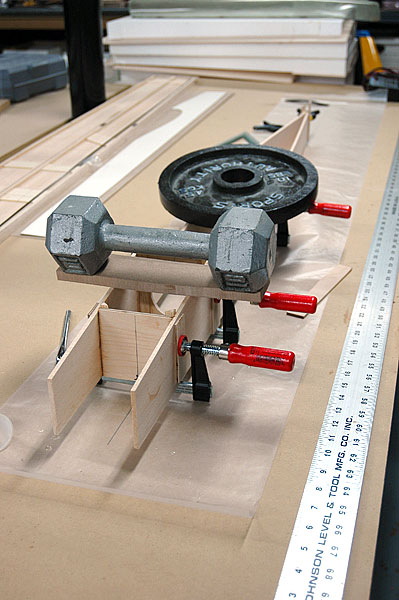

here is a shot of the super kaos fuse in the jig, I acutally framed up the first fuse for the super k a year ago but the wood I used was really heavy. I cut out the fuse sides and formers a couple of weeks ago. I also wanted to test my simple jig setup. the curare fuse is a simple as the kaos box - 3 formers and a nose ring. I just got a super jig from Pete's RC, but havent put it together yet. I laid up the test fuse using west system slow epoxy - it looks super straight and level - we will check it out in the morning -
the other shot is the 55" planks I have for the fuse sides. this wood is really - I mean really nice : )

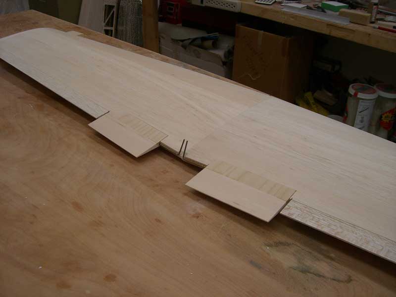

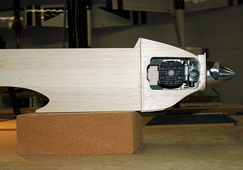

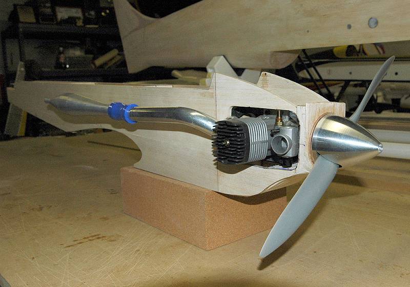

pics!
ID:	587555   Click image for larger version
ID:	587556   Click image for larger version
ID:	587557   Click image for larger version
ID:	587558   Click image for larger version
ID:	587559   Click image for larger version
ID:	587560   Click image for larger version
Old 12-31-2006, 03:56 PM
handglider
My Feedback: (23)
handglider's Avatar
Join Date: Mar 2005
Location: ,
Posts: 1,097
Default RE: Curare build
HI All,
just a few pics of the work I did the last couple of days. My "prototype" curare is slowly coming together. I hope to have a turtle deck core soon. and Mike is helping me with the foam wings also. I just had to stick that pipe on it for grins.
Does anyone know what pipe I should use with the YS 61 long stroke with something like a 11 x 11 or 12 x 10 props. ??? Any info out there on rpm's from the YS long stroke out there ???
The only tricky thing is cutting the fin leading edge and building up the body of the fin...
enjoy the pics!
Dean

The shot with the fiberglass fuselage is the original "Hobby Barn Super Curare" I have a fire wall to install cut out and ready to fit it. I've decided to use the OS 61 - ABC-P rear exhaust, robert spring-air retracts. I've got Mike cutting cores for this one.
should be a screamer : ) !!!!

The fuse is looking good. That's the next item on my agenda. Starts tomorrow.
I have the wings and the stabs done on mine. Pics of wings attached. I cut my own cores. I have built bagged glider wings with carbon and fiberglass for years and this was my first bagged balsa skinned wing. Makes for a perfectly straight wing. They seem light two, only 13 oz. per side with carbon reinforcement.
Cutting and shaping the ailerons and flaps from flat stock took the most work.
I forgot how much balsa dust you make scratch building. Whew!
Jeff
