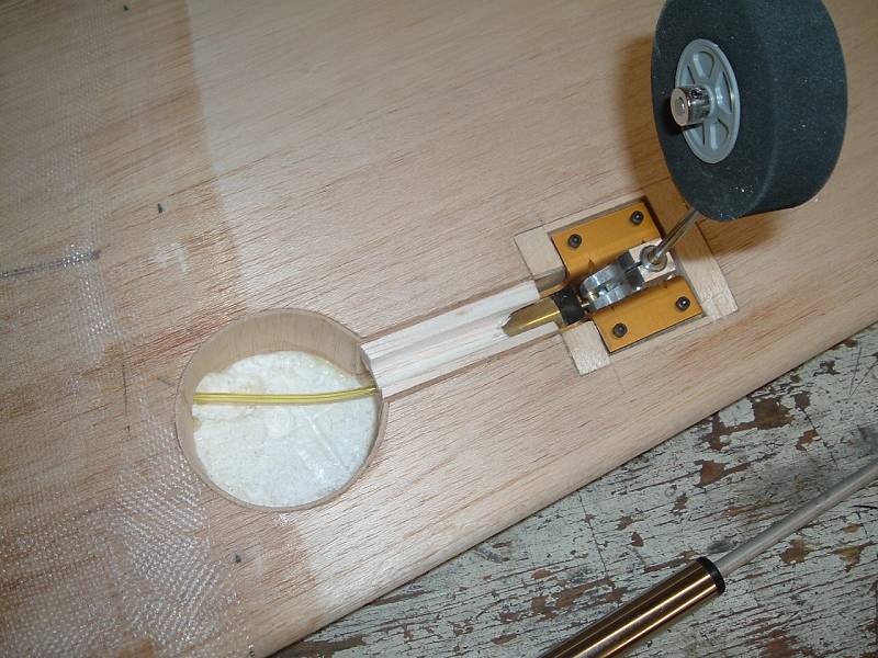

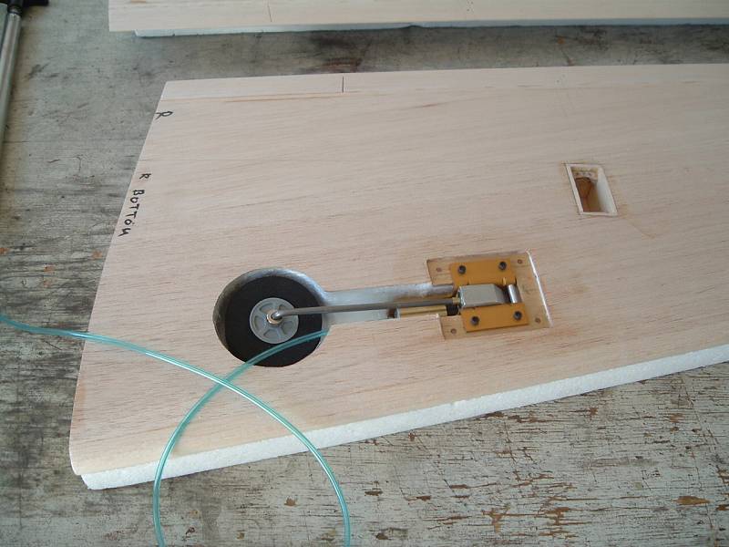

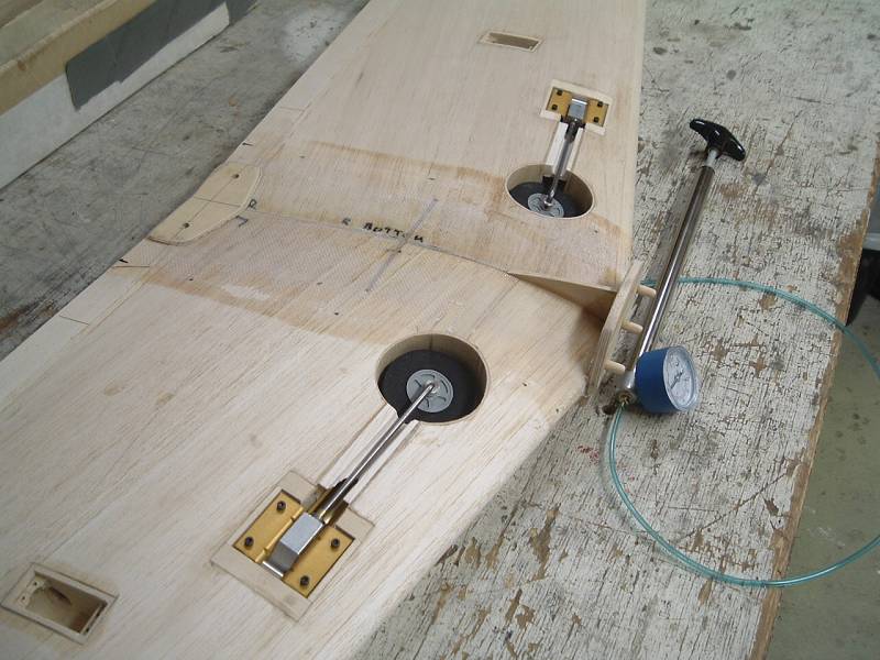

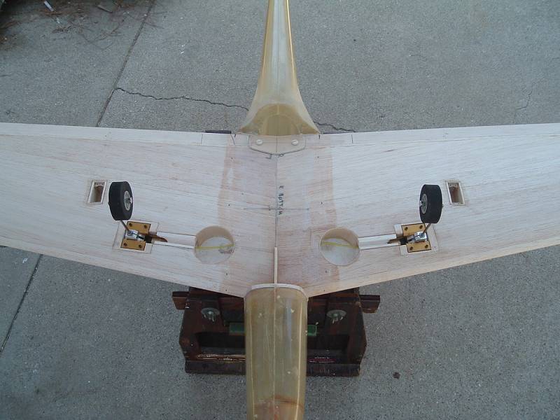

Photo 1: Wheel wells are cut, main gear legs cut to size with wheel attached.
Photo 2: The main gear is retracted using the hand pump to verify the wheel well opening.
ID:	1173401   Click image for larger version

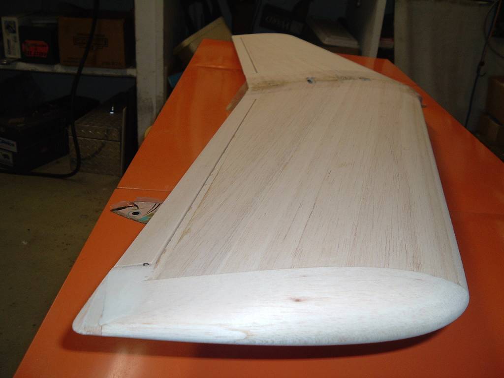

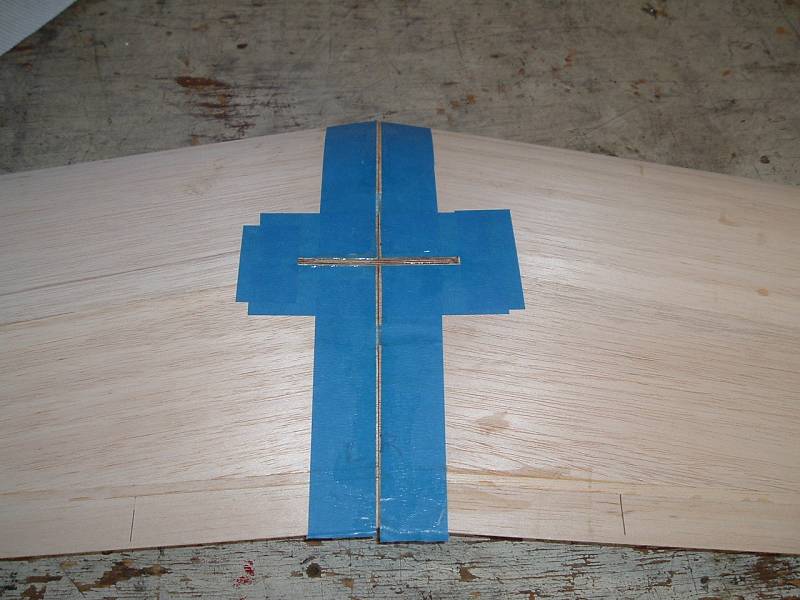

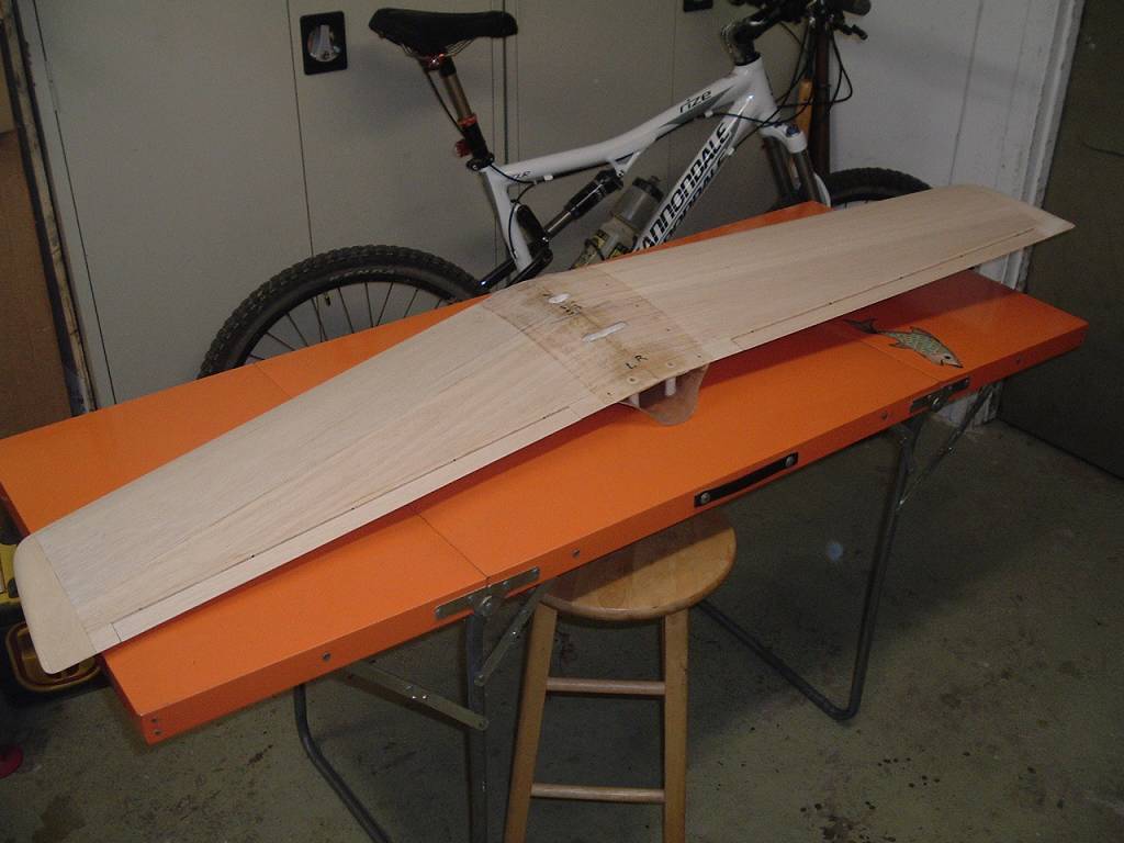

The wings are joined with 30 minute epoxy. The blue masking tape keeps the excess epoxy from getting all over the place. Once the epoxy sets, sand flush with the tape, and avoid gouging the soft balsa. The dihedral brace in made of 1/8 ply. Next is a 6" wide layer of 6 oz. fiberglass, this time with Bob Smith Industries 20 minute epoxy. It sands easier, like polyester resin. Maybe a bit overkill, but I will err in the conservative with this one. Dihedral is 1" each tip, or 2" total. I am the fat bald guy holding the wing.
ID:	1195202   Click image for larger version
ID:	1195203   Click image for larger version
ID:	1195204   Click image for larger version

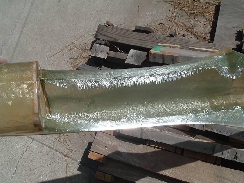

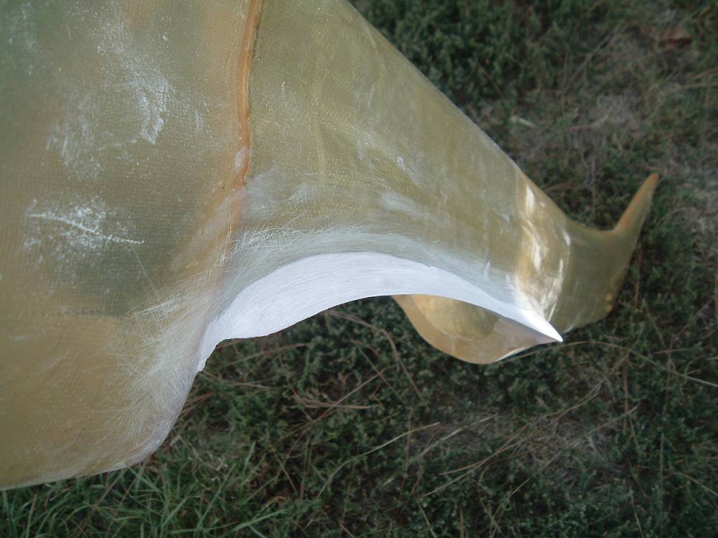

Have you ever had a warped fiberglass fuselage? This fuselage had a twist in the wing saddle section, which was visible when sighting down the bottom mold line (center line). I tried heating the fuselage while twisting in the opposite direction, but the material has enough "memory" to where is would spring back to where is started within a few hours. The solution was to add a laver of 6 oz. fiberglass using polyester resin. Polyester resin was used because Skyglas fuselages were polyester layups. Kind of a drag, as polyester tends to become brittle with age, and this piece is no exception. Unfortunately, this added a little pork to a weight sensitive project, but lightweight doesn't mean much if it is crooked. Using the paper towel method of blotting up the excess resin in the layup helped mitigate the weigh gain. I will have to add a bit more reinforcement down the road as I tackle the engine installation.
ID:	1195651   Click image for larger version

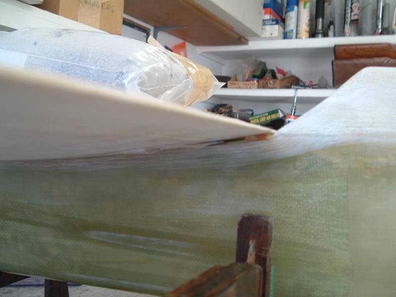

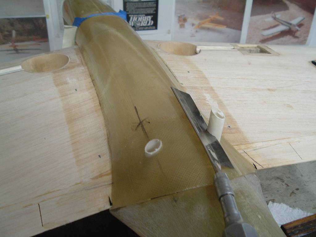

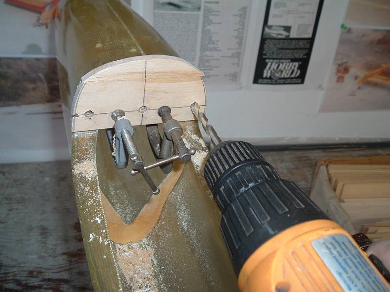

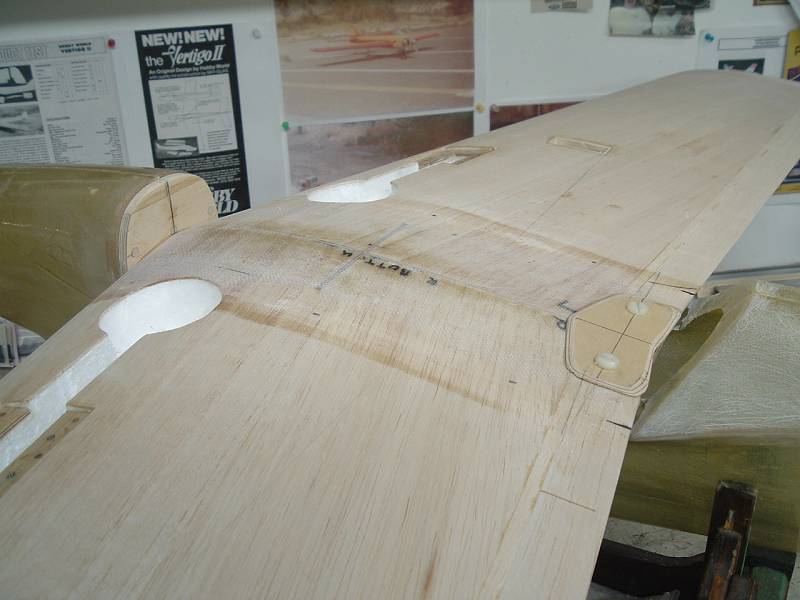

Wing mounting, Part 1. The most serious flaw in the Vertigo II is the wing saddle. There is roughly 2 degrees of negative incidence in the wing saddle, depending upon where you position the wing fore and aft. The wing is actually too narrow of a chord. The chord at the root is what it should be if it were at the fuselage side. The chord should be longer as you project it toward the actual centerline. Consequently there is a gap at the leading edge when you move the trailing edge back to the rear of the saddle, which is the correct position.
Fortunately, I figured this out 33 years ago. Wing cores that I cut for this airplane in the future will have the correct root chord, and the fuselages will have a correct saddle. But that is for another day.
Here is my solution for this particular aircraft. I cut a bulkhead from 1/4" ply, and capped it with 1/4" balsa to save some weight. I want to key this into the old brittle fuselage really well to add some torsional rigidity to this section. The wing bolts will anchor the other end of course. I used three dowels rather than the regular two for a bit of overkill. The middle one is not really necessary, but it looks cool, and makes me feel good. I will back this up with a gusset, and some glass strips to the leading edge.
The wing is shimmed to the correct incidence, thanks to my trusty Robart incidence meter. The wing is aligned correctly, and the leading edge is epoxied to the front mount. I epoxied 1/16 ply wing screw plate to the trailing edge. The wing hold down piece the mounts in the wing saddle is cut from 1/4" ply. I tap the 1/4-20 threads right into the plywood. To save weight, I put the piece in the Bridgeport, and mill a slot to take out some unnecessary material to save some weight. This piece is epoxied in place with 5 minute epoxy. The wing saddle flanges are much stiffer now from the added layer of glass applied to the inside of the fuselage from the previous step. This wing won't be falling off anytime soon.
If I laid everything out correctly, the bolt holes will come out right on or really close to the marks on the bolt plate (wing saddle). We will see in the next post. Stay tuned.

The wing is bolted in place now. The drill hit the marks really close. One little victory at a time.

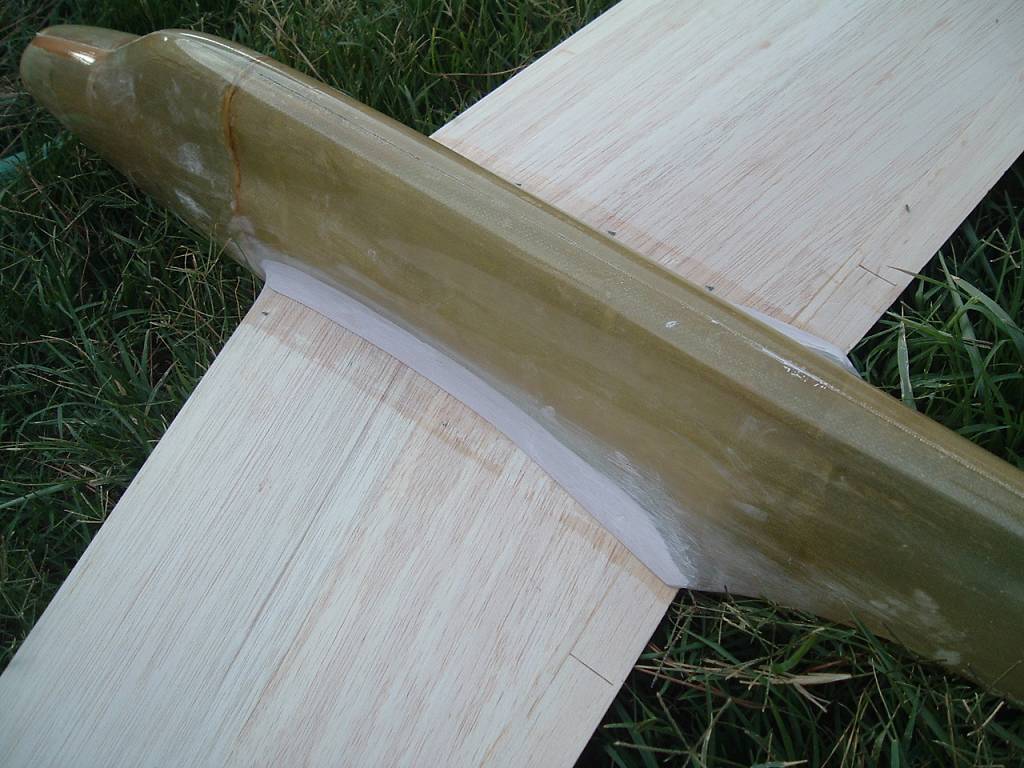

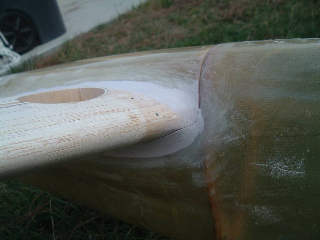

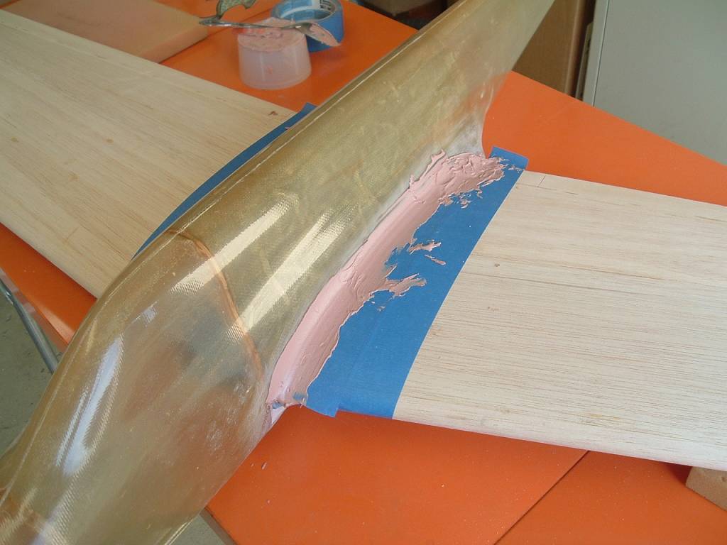

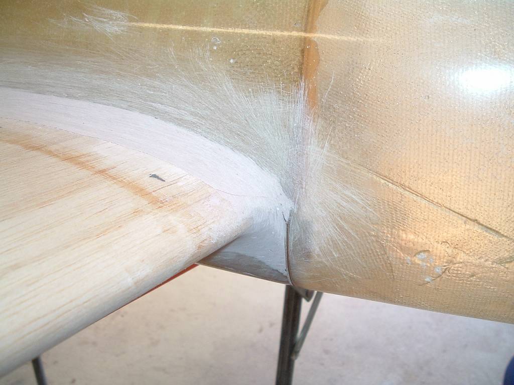

Photo 1: Front wing mount finished. Added gusset and a strip of 6 oz glass, fibers oriented on a 45 degree angle with epoxy to tie the plate to the leading edge better. Looks cool.
Photo 2: Time to fix the wing saddle gap. I wrapped the center section with wax paper, mixed up polyester resin and microballoons, slopped in onto the wing saddle, bolted the wing in place. Bolt threads sprayed with mold release so they wont stick. Set out i nthe hot afternoon sun (91 degrees today) to speed cure. Looks good there, wing and fuselage screwed together. Looks more like and airplane.
Photo 3: Wing removed, and excess trimmed away with a knife while somewhat soft. A couple of spots need touch-up, I'll do that when I finish up the wing fillet contours.
ID:	1199743   Click image for larger version
ID:	1199744   Click image for larger version

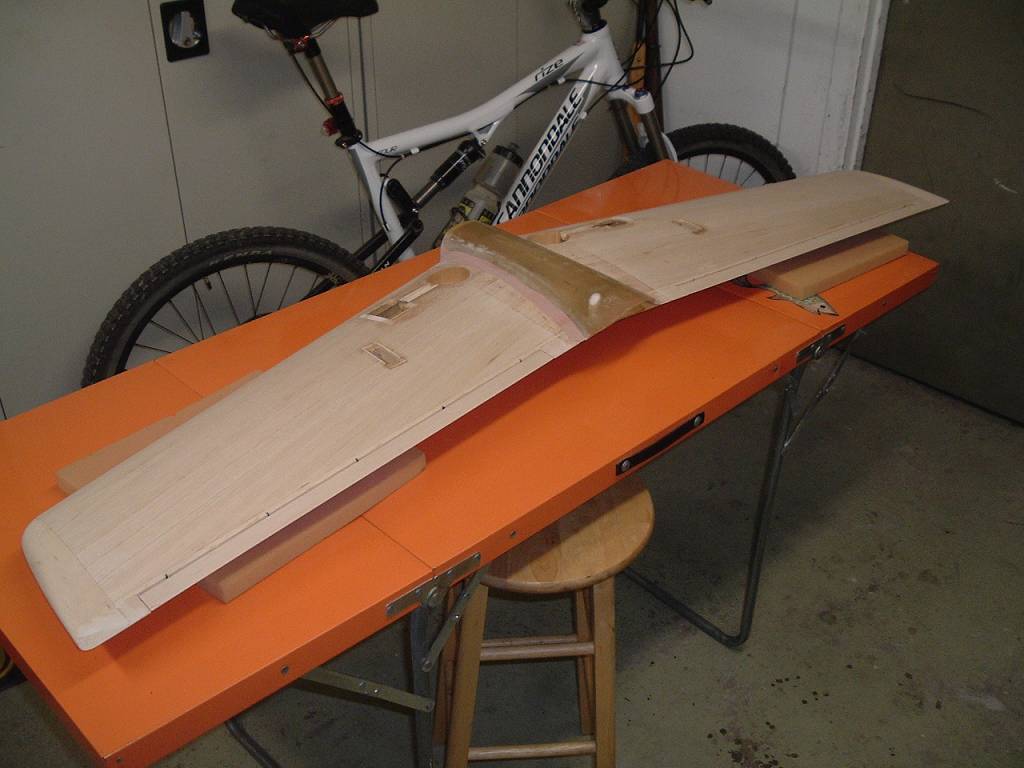

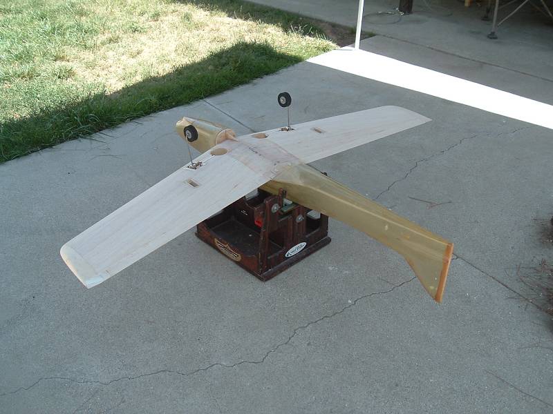

Finally got some shop time. The wing is getting quite a bit of hangar rash in my small hangar, so I am going to finish it up, to mimimize further damage. The belly pan will be last. That is because I only have one, and I need more. So I need to save it for use as a plug.
The first thing is to finish off the wheel wells. Three evening's work produced what is shown here. Also shown sitting on the main gear for the first time. Enjoy the pics. Next will be aileron hinging, linkage. Then final sanding and covering. Either Econokote of Ultracote.
