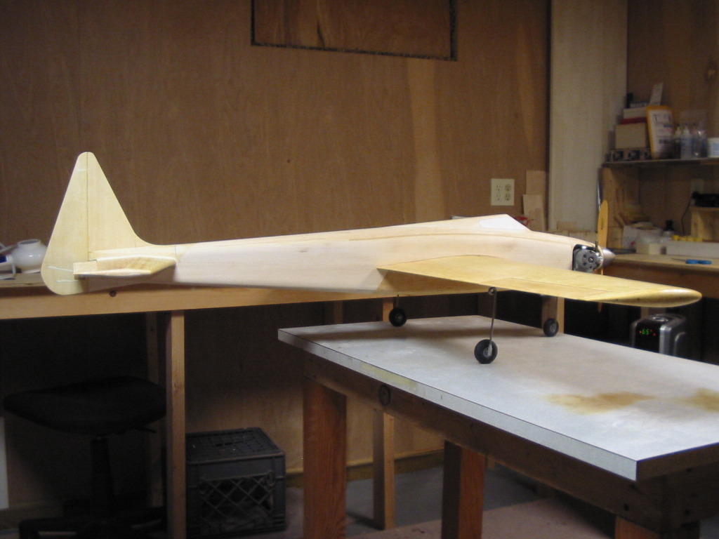

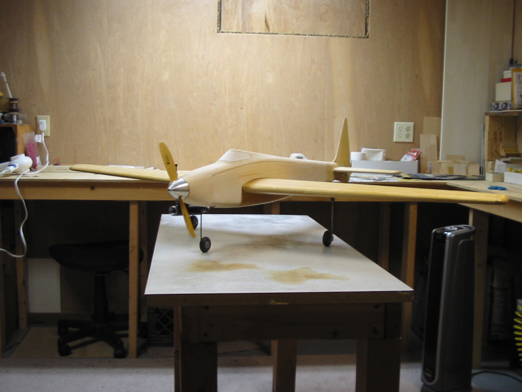

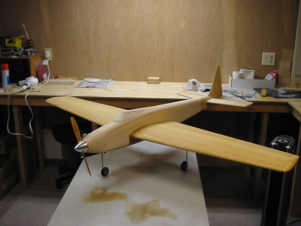

The cold has settled back in just in time for me to unwrap the Banshee, and get back to glassing. As noted in a previous post, I ran into some problems with slow curing resin. Well a year later, it has hardened completely. I left some witness samples of the resin mix I used that had given me problems, and they confirm that it had hardened completely. I’m fairly sure that the issue is that the thinned resin simply requires a lot of time to cure when applied as a second coat. The first coat goes on very thin, and much is absorbed into the balsa, which either aids curing, or makes the slow cure unnoticeable. Either way, using un-thinned resin for all additional coats has allowed me to proceed to sanding within 12 hours or so.
I did complete and fly the Super Kaos last year. I was concerned that the Banshee might need a bit more ground clearance for my grass field, and wanted to modify it if needed prior to finishing. However, the Kaos handles okay with a 12x6, and prop clearance is a non issue with an 11x7; the Banshee has 1/8†more clearance than the Kaos. Alls well.
I’m to the point that a decision needs to be made regarding paint. I’m leaning towards Nelson Hobbies paint, as it’s claimed to be brushable, and I might be able to use it in the basement with minimal ventilation. I’m open to other ideas or comments regarding Nelsons’ from others’ experiences.
Thought I’d make certain that I knew where all the pieces were, so she got assembled for a photo shoot. The wing needs a few more coats, and then should be ready for primer. The total weight gain of the wing to this point is (130 grams) 4.6 oz. As pictured below, the total weight is 5# 12.5oz (need to add the remainder of the glass to the fuselage, paint, four servos, receiver, battery, and tank). I’m feeling fairly comfortable about hitting 7.5# or less auw.
Thanks for checking in.

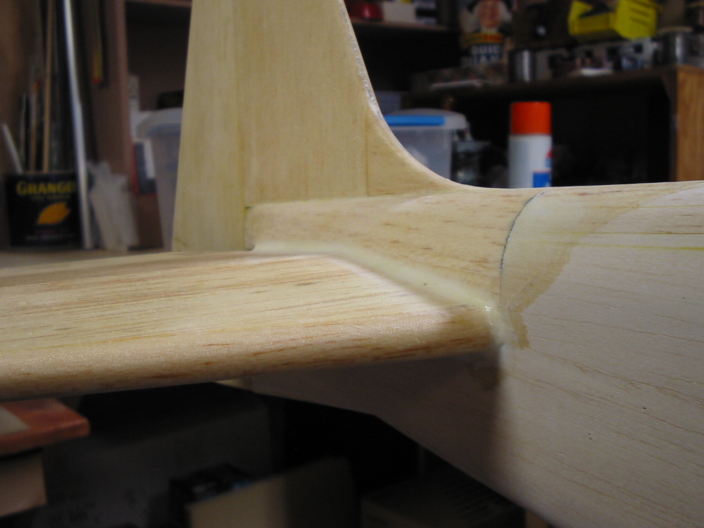

The fiber-glassing is progressing, but slowly. Yup, resin is interesting stuff…….allow me to ramble for a bit.
After three coats of resin to the wing on top of the applied fiberglass, I’m finding that there are still too many unsatisfactorily filled areas (the resin is very willing to tear/shear when using a squeegee, and when wiped on when first mixed, will actually orange-peel a bit as it thickens). I’m confident that I sanded sufficiently prior to applying the glass, and know that I’m sanding sufficiently to remove all excess resin, as I’ve not added a single gram in weight since applying the first coat of unthinned resin (bare wing at 669 grams, ‘glassed wing, followed by one coat of resin, sanded, weighs 791 grams (4.3oz added)). That is to say that the last two coats of resin have added no weight, as the wing still weighs 791 grams.
I’m going to try filling just the remaining low spots, a quick sand to ensure that they are at least to level or above, another complete coat, then (hopefully) a final sand.
I’m finding that the resin consistently gets thicker from the moment that it’s mixed (doesn’t suddenly “kick†like a quality epoxy will), and I have to modify my method of application while coating a larger area. I’m glad that I ‘glassed the wing first, as straighten out my learning curve on the fuselage would have been more painful.

3 coats of fiberglass resin is more than typical. Have you weighed components before and after? You should try to do that to get a good idea of how much you are really putting on. Hopefully this suggestion isn't too late. Beware of building heavy wings
The guns I use are fairly inexpensive HVLP type with about an 0.8 mm to 1.2 mm nozzles. That's "high volume low pressure"....You get pretty good atomization with only about 25 psi of air and for larger surfaces I will go as large as 1.2 mm on the nozzle. Puts out more paint at the same pressure, give or take. To me, there is little need to use the expensive guns such as Sata Minijet. Sure these are great guns but I've learned to use the lesser guns just fine. Spray on a piece of cardboard first to figure out the settings before committing to your work. And don't be afraid to use thinner in your paint. For our application, an extra 50% of thinner works just fine and produces a thinner, lighter coat
Another suggestion if I may...since you haven't yet laid down the glass on the fuse, you might consider bedding it with epoxy clear paint from Klass Kote. BTW- their epoxy primer is terrific stuff and feathers beautifully. The primer will accept pretty much any top coat you wish to spray on it
I was talking with Bob Hunt at Christmas and he told me of another water based paint that he really likes a lot. It's DuPont Chromax. This is a polyester paint (similar base to mylar which is what monokote is made of ). Bob said that you can water this stuff 100% easily. It's expensive at 60$ a pint but produces superior results according to Bob.
Not certain of how fuel resistant either Nelson, DuPont CHromax or AutoAir/Createx are. These are all water carrier paints, polyurethane, polyester, acrylic base, in that order. They are gasoline resistant but yours is a glow application I think.

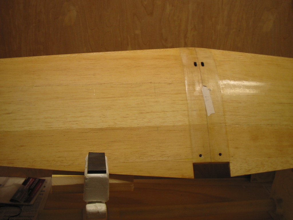

Ok, feeling a bit better about how this process works. I wasn’t working with the Finishing Resin, rather trying to make it work as I thought it should…..and I was wrong.
-Don’t play around with it. I’ve managed to get fairly thin, and SMOOTH coats on the wing by pouring a long continuous “S†of resin on the wing, spreading evenly with a squeegee, and then just LEAVE IT ALONE. Previously, all my “touch-up†work after spreading the resin, trying to get a perfect finish, seems to be the main culprit in the tears and pockets. The resin will start to set up immediately, and going back over it continually just rips the resin apart. I have the top of one wing panel done in about 5 minutes.
-I figure that I’ve put on about 1 ¾ oz of resin to finish the wing. This is just the resin on top of the fiberglass, not the fiberglass/thinned resin.
-Using 220 wet/dry sandpaper, I’ve knocked down the resin to the lowest point by sanding to a consistent dull finish. The shiny low spots do act as indicators to let me know that I’ve reached bottom, but still above the fiberglass cloth.
-Speaking of sandpaper, I’ve found that just because I put a new piece on my sanding block 5 minutes ago, doesn’t mean that it ain’t worn out. I have to put my “thriftiness†aside, and frequently replace the paper; makes the task much less tedious.
-Side note; I purchased both Great Planes and Z-Poxy finishing resin about two years ago. A package of the GP resin has set unopened, sealed in zip lock bags, next to some half used Z-Poxy. Looked at the GP resin yesterday, and it was hard as a rock. I’m currently using the Z-poxy without issue. Don’t know what that tells me other than I’m going to stick with Z-Poxy.

I can see in your photo that you have a Webra Speed in the nose, but I don't know what muffler that is. Did you need an adapter? Who makes the muffler? Any modifications needed? How does the engine perform with it? Is there a current source? I really need to find a decent muffler for my Webra Speed .61F. I have two older ones that don't have mounting holes and one newer one that does have factory holes for a "bolt-on" muffler. I used a Macs strap-on with an adapter for the engine that was on my Deception. Worked prretty good but looked kind of clunky.
The Banshee looks terrific, but I don't see wing fillits. Are those still coming?

The muffler shown on the Webra is an old SEMCO. I’m certain that they are not currently manufactured, but I had one in a box, and picked the one in the photo below up at an on-line auction site (ya, that one). The photo below shows two versions of the SEMCO muffler, the “Flow Through†(115gr), and the sexy dual tail pipe (76gr). The Flow Through, on the right, is actually a tube inside a tube (you can look into the hole in the front, and see right out the back), with the inner tube being drilled full of holes. I believe that they all require an adaptor, but the ENYA adaptor that came with the dual pipe is only a fraction off, and could readily be tweaked to fit the Webra. Performance wise, the Flow Through provides very little restriction, but also, very little silencing. I haven’t run the dual pipe, but it is closed in the front like most modern mufflers, unlike the original SEMCO flow through.
That being said, I haven’t currently flown with either of the SEMCO’s.
Also pictured are an OS Max muffler (135gr), and a MVVS muffler (69gr). Interestingly, both the Max and the MVVS have the same bolt pattern. I drilled and tapped this particular Webra without much difficulty, and the result with about 15 flights are no loosening or leakage. I did a little reading, and am comfortable with the thread engagement, and being able to tighten the bolts as required without stripping out the block. Rather easy to do once I came up with the courage. The aluminum block drilled and tapped nicely.
Still debating the fillets. I would put them on after I finish fiberglassing anyways to avoid having to sand around them.

This evenings accomplishment (really getting tired of sanding.....), fuselage side covered from nose to LE of stab with one piece of fiberglass. Masking tape runs top and bottom, down the center.
