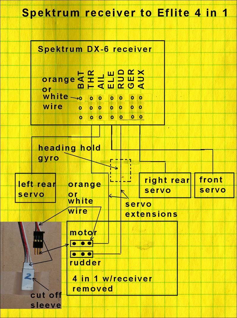

It's takes 2 extension wires to plug in from the seperate receiver to the 3-in-1. Channel THR goes in the upper slot in the 3-in-1, RUD into the lower slot.
You might have to plug-n-play with the cyclic servo channels.

Happy New Year ya'll. Been outa town and too lazy to turn on the laptop.
For those of you playing with your Rx's, Tall Paul's schematic is great. On another note, since I fly Futaba, I am able to use my 7C with the blade. One benefit is I used a blade Rx in one of my planks after the esc fried. So if anybody who likes JR etc. wants to send out their old Rx I'll be glad to take it off your hands.

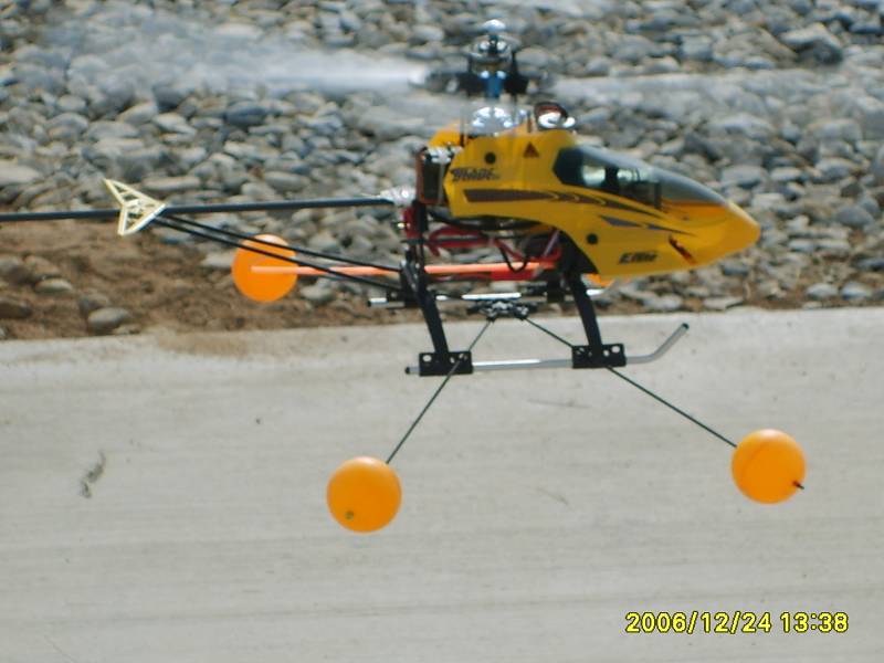

Old 01-03-2007 | 11:04 PM
  #4608
Joined: Oct 2006
Posts: 37
From: Apple Valley, CA
Default RE: E-FLIGHT BLADE CP
A pic of the creampuff. Just for fun.
