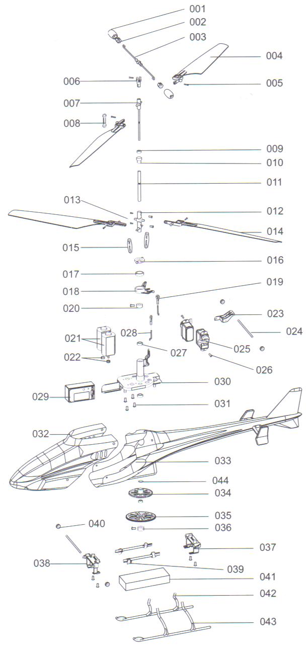

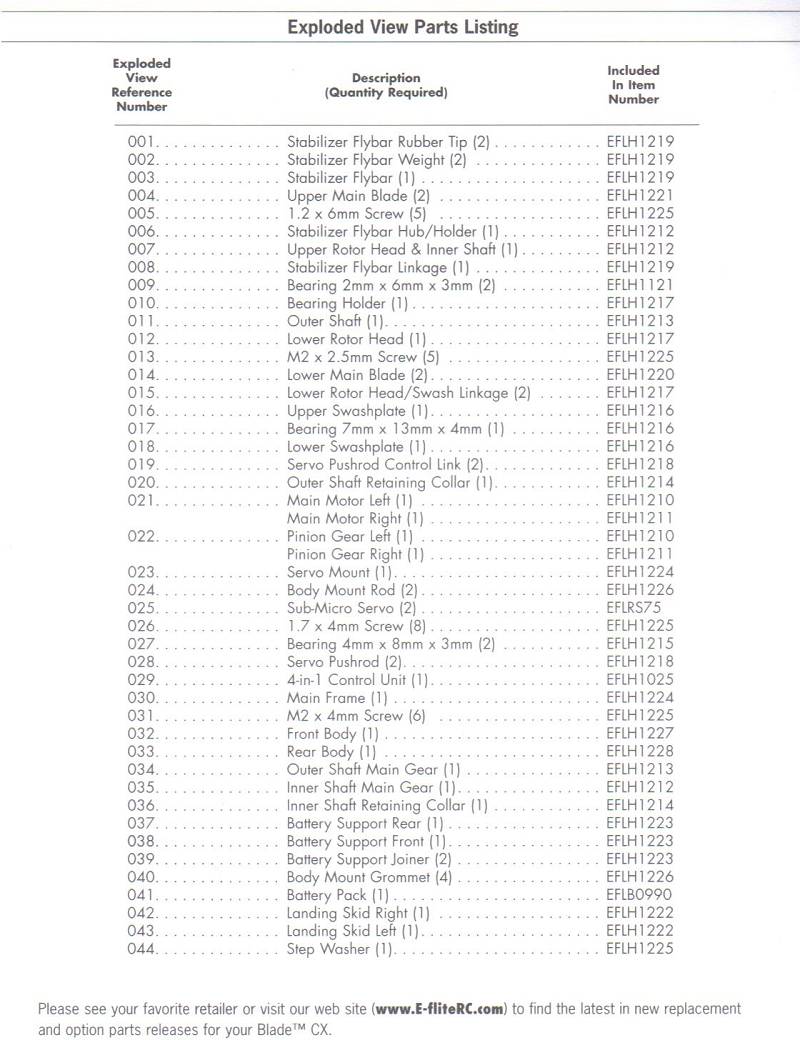

I'm officially a Heli Pilot! I was to close to a wall, orientation got me confused, had a soft chair below, thought I was going to strike the wall so I dropped throttle from about 1-1/2 feet from chair, landed partially on chair and flipped the heli onto the top of the rotors with no power to the blades.
Short drop to the floor but broke the Stabilizer Flybar Hub/Holder contained in CX Part # EFLH1212 Inner Shaft w/Hub & Main Gear Set. This is a weak piece.....well...I guess it isn't if you fly correctly..HAHA.
This piece looks like one solid piece attached to the inner shaft but in the parts list the flybar holder shows that its separate from the inner shaft.
Thank goodness for super glue. That fixed it but when I go to replace the Stabilizer Flybar Hub/Holder how do I take it apart?
Do I have to replace the inner shaft?
I looked closely but wasn't sure how to take it apart when I get a new part for a permanent fix.
I wish the CX had instructions on assembly/disassembly. The exploded view doesn't do enough for a beginner like me!
Thanks for any help on disassembly.

#81
MA3K... from what ive read in threads and my own expierence with the blade cx its pretty common to expierence some minor drift during take off/ive read about ground effect and also expierenced it. my suggestion and im not an expert but think most will agree is to trim it for best flight when its out of ground effect. the instability and drifting is pretty common while in ground effect (make trim adjustments while on ground and and retry in air unless your comfortable trimming while in flight)and when your ready and comfortable enough to fly it higher it will be more stable out of ground effect. i know its nerve racking to take the blade higher and have potential for a crash when its up higher but youll find when its out of ground effect it will be easier to fly. also once the training gear is off it will be more manageable. set up is extremly important with any aircraft/it can make it easier to fly or very difficult. your flying area sounds really small and sounds really limiting as far as manuvers or learning. i know personally if i had a larger area i would be more comfortable doing more manuvers and it would probally make my learning go quicker. i havent had any mishaps so i cant really comment on repairs since i havent taken mine apart other than the canopy and made trim adjustments. ive had mine a little over a week and flown almost every day. ive flown electric planes since midsummer and feel thats helped alot from hovering planes and having learned throttle management during hovers and its carried over to my heli learning/realflight has probally helped alot to. your flying will come along and with learning youll make mistakes just as i have and everyone else new to heli's has. good luck with your flying and learn at your own pace and with your own comfort level.

Mine just broke at the same spot as everyone else's, right at the top above the flybar.
I cannot describe how really angry this made me. It looks like a major problem and I will bet that over 98% of them will break in the same spot.
Horizon must have known about this defect through their testing. Only a slight hit on the flybar and it is broken...every time, but IMO, they obviously were in a hurry to get them out for the holidays and chose to ignore the issue.
I ordered two replacements. You get the inner shaft, main gear and the head piece for $9.00.
To remove them simple losen the collar at the bottom and pull it. Watch it because there is a bearing in the middle and I nearly lost it.

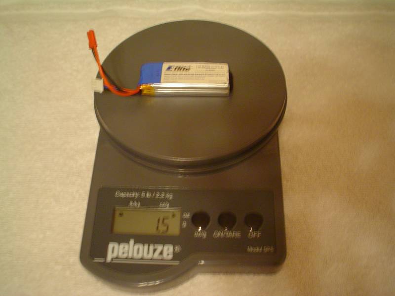

Picked up a scale finally. weighed all my planes and BCX. also weighed battery to show anyone interested in its payload abilitys which i demonstrated in test video by lifting BCX 7.4 lipo/ 1.5 oz according to scale which is suppose to be pretty accurate. still havent broken anything on mine.. i know it will happen eventually. this is just my opinion and not directed twards anyone but in general/its very common in posts of how cheap or fragile aircraft or parts are thought to be. i personally think if a part doesnt fail in flight its built well/if it fails in flight after a crash chances are it was overlooked and already damaged do to crash. bottom line things break when you crash. id like a aircraft that could bounce off walls and 3D and pretty much fly itself to but thats asking a bit much out of any aircraft. MA3k from what i seen this weekend at shop it would be nice to be able to purchase that part seperatley. good luck with your flying.
