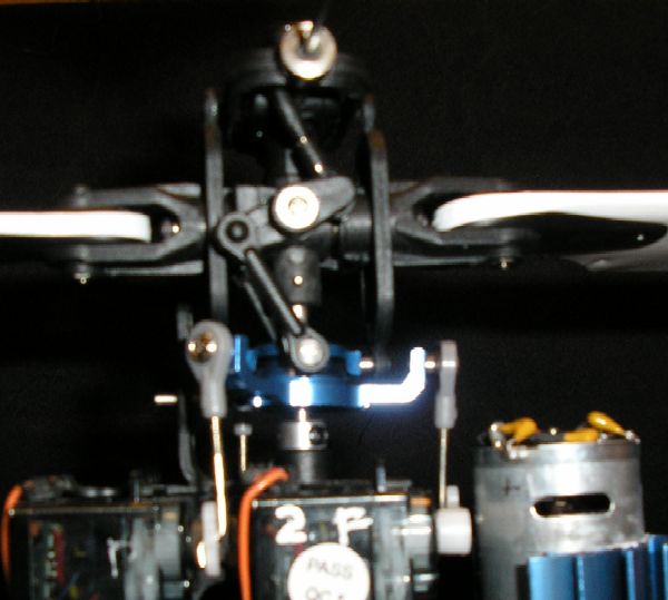

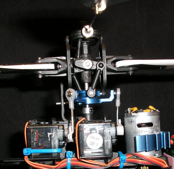

How can the B-H levers/mixers be upside down? Wouldnt the nut for the blade grip be on top? Mine is on the bottom like normal.
jellyson,
The blurry pic is the wrong way, the clear pic is the right way.

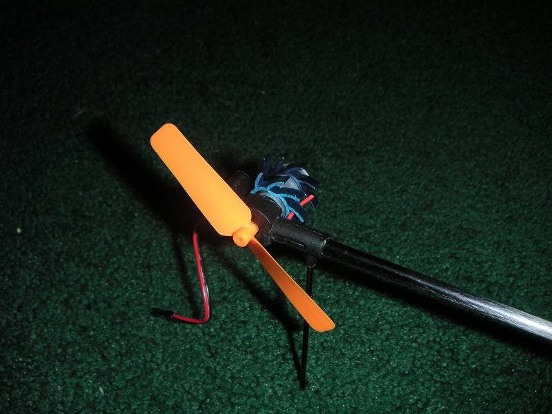

The orange blades work very well, no problem. However, I don't like orange. You could spray paint 'em flat black. Jusk kiddin'. They do work well, and have a totally different sound to them. Kinda like a bumble bee.
You'll like the DD set up.

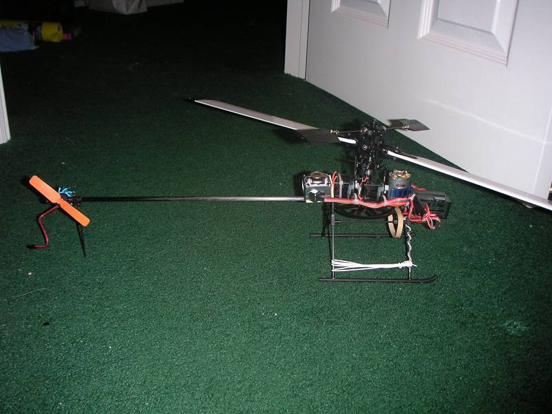

The stock screws would not hold the DD motor in so I used a little CA and it held great. I wanted to see the DD motor work so I pluged it into the battry and it got my finger [:@] a cupple of cuts nothing bad.
How do you post pictures??? When I click image I just get [img][/img] what do I put between them?

With my gyro if the Ch5 knob is on the left side it works fine but I think this is standard rate but if it is on the right side the whole heli just flips out... random pulses of speed from the main and tail motors...
Justin
Justin

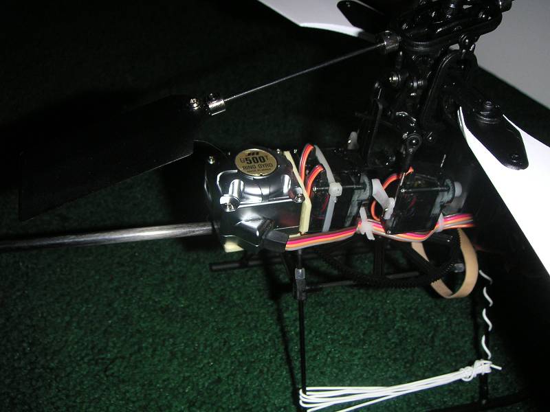

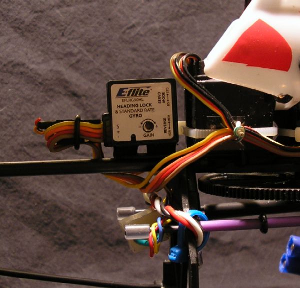

Also you should not use a single piece of thick foam tape all across the bottom, but rather two narrow strips with a space between them. This will give much better vibration isolation. And make sure the case does not touch the servos, you should eliminate that piece of tape there between the gyro and the servos.
You of course have made sure the gyro is set for analog servo not digital.
I can't quite "grok" why it would cause random pulses from the main motor unless it is causing the tail motor to draw way too much current. You might play with the travel limits, I think they are set in the gyro with this one?

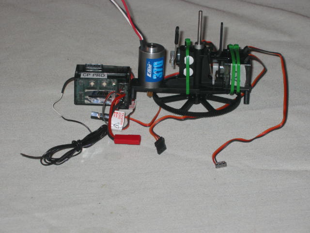

You're having to much fun.. You are a certified nut, just like me. I just did the brushless motor, WOW, simply, in a word, COOL Much, much more power. Take some pics and post.
Here's my brushless in a total rebuild.

snip> vibration isolation is critical for performance. It looks to me like your gyro wire is stretched pretty tight and this will transfer vibration to the gyro.
<snip

The gyro came with the foam tape on the bottom... it is a square with a whole in the center and a cut in the side to the whole it's kinda a U shape.
