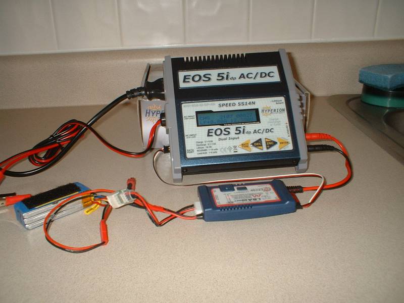

thanks for the info. I kinda figured I burned up the pack by charging at the wrong charging current. The stock E-Flite Balancing charger that comes with the CX2 (EFLC3110) is rated at 0.65A output, the stock E-Flite Balancing charger that comes with the CP Pro (EFLC3105) is rated at 0.8A output...
stock E-Flight battery specs
Anyone know the max charge current I can use with the stock E-Flite Lipo's without damaging?
7.4V 800mAh 2-Cell LiPo, JST/Balance: BCX/2

good news!!!
I figured it out
not the bearings, not the motor, not the connections, not the head, not the pitch range, not the batteries, not the main shaft or the gear mesh... hrm... I got to thinking, so what does that leave... the blades =) of course =P Anyways I tested the PE foam blades that I have been using and their min draw at 0 pitch @ 8vdc was 2.24A, the JCS plasti were about 2.14 and the stock syms were really low at about 1.46A. I expected the syms to be low, but I didn't know they would be quite that much lower. The PE's from the JCS's though were not alot of difference at 0 pitch, so then I tested hover range amp draw on all the blades, I can't remember what the syms were, the JCS were 2.8A and the PE's were a wopping 4.2A.
Also I dunno what happened to the PE blades, but they were flat when I got them, and now they have a good negative camber to them. Like this but not nearly as extreme http://www.pdc.kth.se:81/pdcttn/sve/...stmesh_200.gif
I wonder if they just mishape in flight or something, cuz the heli hasn't gotten warm. I bet the foam gets compacted on the flat side under the forces the blades exert pushing the air down, which leaves the negative camber. So basically if you want to go with PE's remember to check the camber and get rid of them if they have too much =)
boy I'm glad I figured that out. This heli stuff was driving me bonkers, making me almost ready to throw in the towel because I tried everything I could think of, and I didn't want to throw a whole bunch of money at it to not fix the problem.
I also couldn't believe switching back and forth between the 3 sets of blades how much the pitch angle needed to be changed to get a 0 pitch at center stick in idle up. A good -40% for the syms, 0 for the PE because that's what my system was tuned to, and +40 for the plasti blades. Anyways goes to show if you switch out blades you really need to check the pitch angles because they can vary alot.
Anyways I just got done doing a 25 min test with the plasti blades tuned for 0 pitch at 50% throttle in idle up on a 8vdc power supply. I did 75-80% collective, and the motor after the test was only 103 to 105F
So basically I could run that setup as long as the motor would last without it getting any warmer than that =) and I bet the syms would work even better than that.
I'm really glad I got it figured out =) Thanks for everyone who helped!!!
I haven't done a flight test yet, but with this info, I'm pretty sure that it will all work out well.
