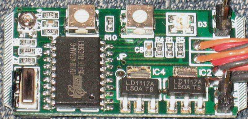

flight time just under 10 min with a 1250mAh pack with 837 mAh put back in after charging (a little less than normal... I usually put 1050mAh back in including the amount waisted to discharge, which is about 120mAh over the 1 hour charge, which gives me an average usage of about 75%)
first 3 or 4 min max climbout from a hover about 1ft per sec
middle 3 or 4 min max climbout from a hover about 1/2 foot per sec
last 3 or 4 min would only sustain a GE hover at full collective
batt temp when done 94.6F OC battery voltage after flight is 11.4v and I always cut my pack off at 10v under load
motor temp when done without canopy 134F
I found it kinda weird, but the heli would not arm without both the ch3 and the ch4 connected =P
Anyways, so I hooked up just the main motor and no servo's or the tail motor were hooked up. I ran for about 5 min and the motor temp was 147 point something, so basically 148 =( The throttle was all the way up, and I set the servos for about 6 or 7 degrees pitch.
I also had a weird glitch while I was testing it... the main motor bumped out for a milisecond and then when it came back up reved higher and pretty much stayed there. Is that something with the motor, or something with the 3 in 1?
here is a pic of the test. You can see how the motor is arcing a bit.
I also included a pic of my current pinion spacing.

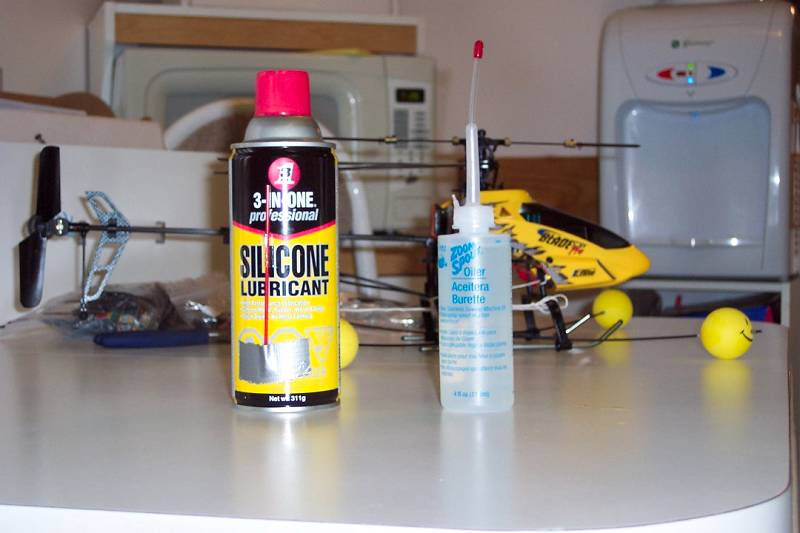

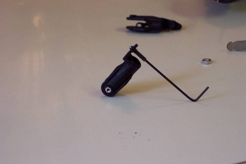

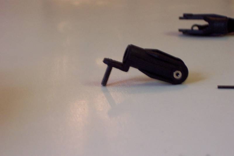

Default RE: Wheeeeeeee.......... Blade CP!
ORIGINAL: mrasmm
Thanks for the info, sounds like your setup might be running pretty close to what mine is. Good to know on those sym blades. I'm not used to them because I haven't been running them in quite a while (ever since I found these $3.75 a pair flats). Sounds like a good idea on the lube, what lube are you using?
About the head, yeah I think it would be a good idea to do basically the same to one side as the other, but also where it is so close to the center you would have to have alot of weight out of balance to cause a problem. The farther out you are from the spinning part the less the weight required to make a difference, just like choppers was saying with those formula's =)
Make sure you post some pics when you get it all done, and let us know how it works out for ya and if it's worth doing if the links break off =)
[/quote]
Hi mrasmm, I have been using a 3-1 Teflon spray lube and a sewing machine oil I got from WalMart. I have been leaning towards the sewing machine oil more lately as it has an extend able spout and is easier to control the amount you apply. Here are some pics of the grip mod I did, it works great from what I've seen so far only two packs through it with mod but no wipe outs so I'm not sure what will happen then. I drilled a 5/64 hole where the pin on the grip was, threaded in a small 4-40" X 1/2" long set screw using a .05" allan key, put the arm and washers back on back then put on a little nut with lock-tite. The other thought I had for using the set screws was for holding on the tail mount, I drilled a 5/64 hole on the top of tail mount, installed the boom then tightened the 4-40" X 1/4" long set screw it held the boom no problem, this will be the only way I mount them from now on. I think I figured out part of my grip breaking problem, I bought a new brand of paper clip and it will not break when needed, before when using the previous type I would shear the clip after every blade strike. Hope this helps some people out. Rick

Sounds pretty close to what I had except mine was severe and the 3-1 would disarm, and the glitch was severe too. I got 3 HS-55's on order (servos). It didn't happen all at once, it was progressive in nature where it would finally cause crashes.
ORIGINAL: mrasmm

ORIGINAL: crashcrash
Would the servo's do weird things also, or just the motor cut out? I might need to just get me some 55's anywho, they sound like alot better servo.

Every once in a while the pitch servo (right side looking at the tail) would every so often pull causing the heli to dive to the right. As it progressed...got worse...eventually would pull hard enough for me to loose it and hit a stationary object. At the end...the 3-1 would actually diarm too. Very strange stuff to be sure. Got 3 HS-55's comming from an Ebay store new in the wrapper at the lowest price I could find anywhere (about $12 per unit for total of $39.xx). While I was at it, I ordered new Bell Hiller grips and micro heli stainless shaft from Horizon which I took out on the last crash. If it's not the servos (and I'm 99.999% sure it is), then it's the radio and that would really SUCK because the radio is about new and I got 2 AR6000's for it. I haven't had any glitches in the plank I'm flying on the other AR6000. I'm going INSANE waiting for parts...sheesh! We had a couple eve's here where the wind was NONE///notta, I don't have squat to fly. Corsair is down for Prop, Cub is down for prop, heli down for grips/servos/main rotor shaft.[] The HS-55's are not better than the S-75's persay. They don't have quite as much torque power but they're real close so it makes them a more reliable (so I've heard) suitable sub for S-75's. They will still fail with hard landings etc but they shouldn't just "burn out" like the S-75's. I might start using Futaba servos that are comparable to the S-75's. I've never had Futaba anything go bad all the years I've flown it.

arrrgggggg.... ok, so after all these tests to figure out what is going on with my heli, I decided to take apart the 3 in 1 to see if that didn't have something to do with it. I took it apart and got some good pics. It didn't really look too bad to me when I was looking at it, but after I did some more tests I looked at the pics, and I'm not sure they look so good. When I pulled out the main motor connector, I noticed it was melted =( it was deformed and hard to get out. It was a new connector when I put the 9T in there, so basically 1 pack ago.
After I took all of that apart and got the pics of the 3 in 1 I decided to try a brand new 9T esky motor that I had. I used that one, and after 1 min the motor went from 80F to 115F (no servos and no tail hooked up), so I killed the test. I measured the voltage during the test which was at full throttle, and the RMS came out to be 10.1 or so. After that I wanted to see if it was the 3 in 1, so I took an 8v power supply, and left the pitch and the swash the same with no power to the 3 in 1 receiver or servo's. It drew 4.25A and I let it run for 10 min and took the temp. It went from 80F to 134 =( so no beans on that one, same results with or without the 3 in 1.
that's what one looks like from the 4 in 1 from the regular cp.
The crystal seems to have some burn marks on it, and the [link=http://pdf1.alldatasheet.com/datasheet-pdf/view/22690/STMICROELECTRONICS/LD1117A.html]BEC regulators[/link] (2 @ 5v and 0.8a in parallel for 1.6A total) seem to have slid around, althought I guess they could have been installed that way. Also the plastic positive pole on the main motor has melted a bit. The flip side of the 3 in 1 seems untouched though, including the 3 mosfets 2 for the main and 1 for the tail.
Everything is running normal though except the flight time is down and the main motor is running hot. It looks like the 3 in 1 has definately seen some hard times, and might be shot. It might also be ok and something else is what's causing the problem. Anyone have any ideas?
If the 3 in 1 is shot, I guess I should consider weither to get another 3 in 1 or just go seperates or something. I guess we'll see what plays out =(
