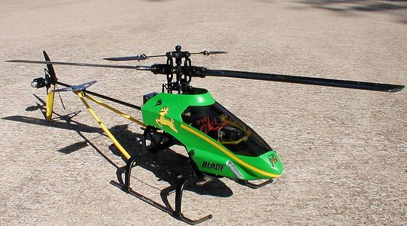

I found it... looks exactly like mine, same color too (LOL).

heh........means we can't fly em together in the same room :P

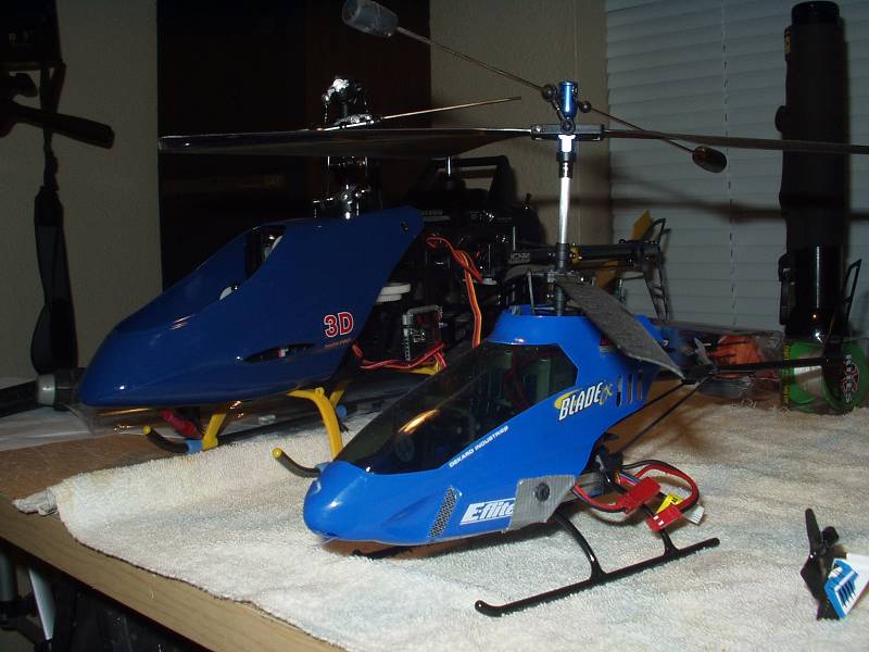

Ummmmm...OK. My son has a yellow one too.

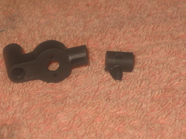

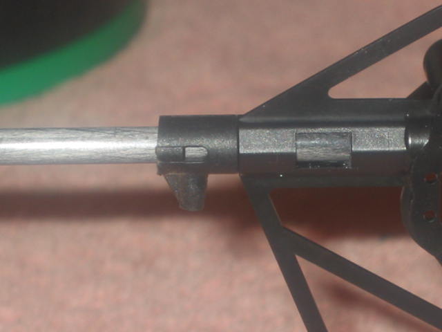

Choppersrule Here:
To all that are doing the DD tail upgrade.... It has been mentioned that the tail housing that comew with the kit is somewhat flimsie(spelling)?). I got mine yesterday(Friday) and sure enough it is flimsie.. Also, mentioned was to use the stock gearbox and modifiy it so that GWS round motor will fit..
I had a Brain Storm last night, didn't hurt at all. But here's my idea. (See pictures)
Take the original, stock gear box, using a dremel cutoff wheel, cut the part off that the tail skid slips into.. Take that piece and put it on the boom first, then the GWS gearbox. I haven't finished the installation yet, to much to do today, so the attached pitures are just for starters. But it will give you my train of thought... Gotta run.. Back later.
Dave / Choppersrule

This is the guide I used: http://www.runryder.com/helicopter/t218932p1/
As in the guide I cut my boom at the stock gear box and slid the GWS gear box on after cutting the geared GWS shaft tube off to save even more weight. I only have to move the battery 1/2 inch forward. The GWS gear box is sufficient.
You have to remember in balancing something, the further you get to the end (in this case the tail) the less weight it takes to effect balance. So, you want as little at the end of that tail as possible without compromising performance.
