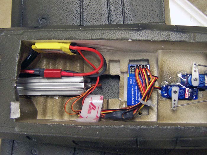

I recenlty reviewd the P-47 for another site... should be up soon.
Park 450 Outrunner Brushless & 20 amp ESC
Took the 1 oz of putty in the front lip of the cowl to balance and this with the rudder servo option installed.
This is with the TP 3cell 2100 slid into the channel it was designed for. For those adding so much weight, I'm guessing you are installing the battery in the larger area behind that seems to have "battery bumps" molded in to help keep a NiCad/Nimh from sliding so much. The tunnel is JUST ahead of that and a 2100 fit inside perfectly... this is not an air cooling tunnel.
Balance was spot on with the 1 oz of putty, though I did leave the plastic wingbottoms off... I think the underside looks just fine without addind that extra oz or so.
Flies real nice with this setup... not monstrously powered but plenty for a warbird. I could easily do very large loops from level flight.
I did want to mention that I too got a funny hit... I was using a Berg Microstamp in mine... usually flawless. My cowl came loos a little and rubbed against the pro tad, was making a little noise, then I got a hit or two. It's possible that the motor somehow generated some RF rubbing against the cowl (can't figure out how, but maybe) and that could explain others mysterious hits perhaps...
Anyhow beautiful offering from Horizon... the most complete out of box I've seen and a nice performer as well.
J. David
Battery location for clarification:

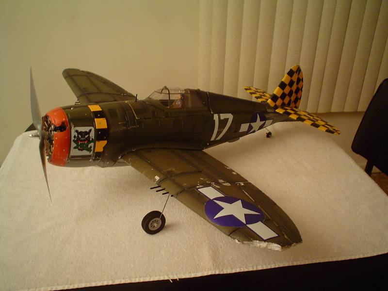

Foam is really easy to repair.. ive done repairs on my buddys planes before and now this one and some light repairs on some of mine.. i'll have to take pics of how i do it next time. its almost repaired.. i'll post pics when its done and i make new motor mount. for now i just want to see how it flys with minor work and i may not have time to go overboard on it. fuselage is repaired and other little things are fixed. ive been thinking its a warbird and sometimes they flew with quite a bit of damage. should have it done over weekend sometime and ready to fly.. been busy and now im probally gonna do some upgrades on my other planes while im working on this one since weather doesnt look good for flying this weekend. heres some pics.. motor mount came out nice for inrunner set up.. had to cut it down for outrunner.. oh well its not like i bought it.. it still worked out well. i might have time tomorrow to get this thing finished up... started on some other stuff and didnt have as much time to work on it as i would have liked.

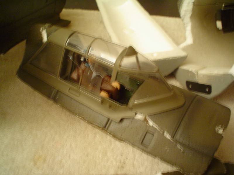

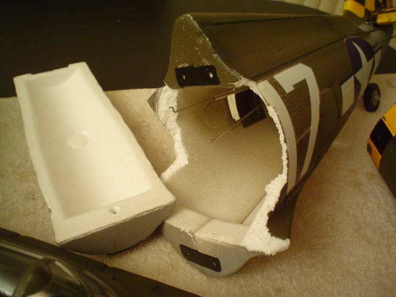

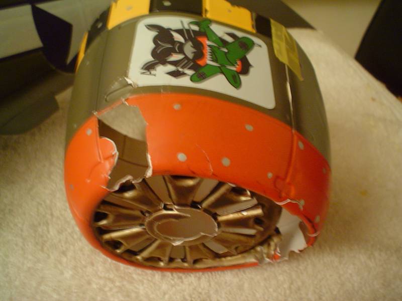

ID:	396831   Click image for larger version
ID:	396832   Click image for larger version
ID:	396833   Click image for larger version

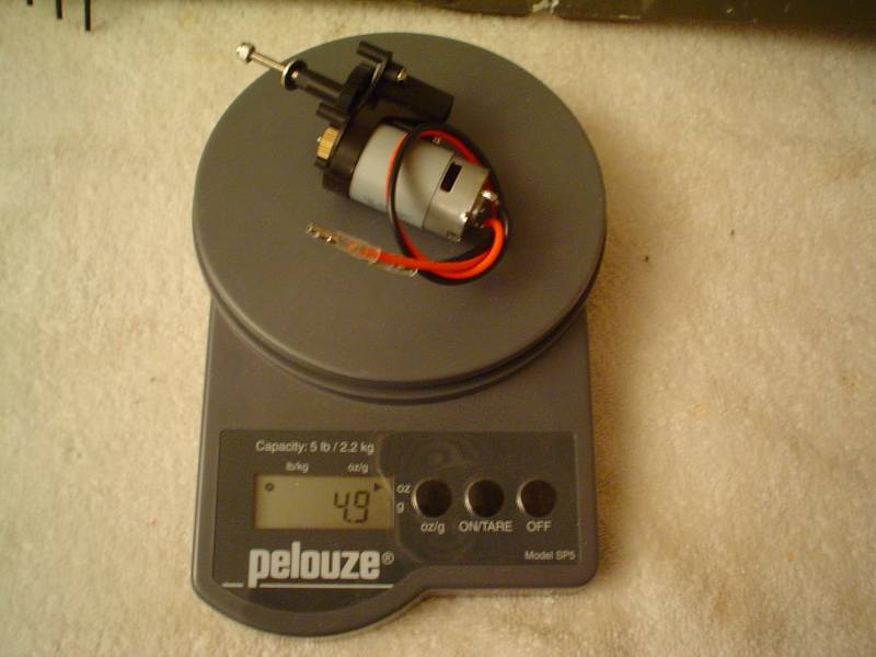

its rtf now. has very good pull inside with 450 outrunner and apc 11x7e on tp2100. if weather agrees i should see how flight worthy it is after repairs. could use a little more repair.. i'll see how flights go.

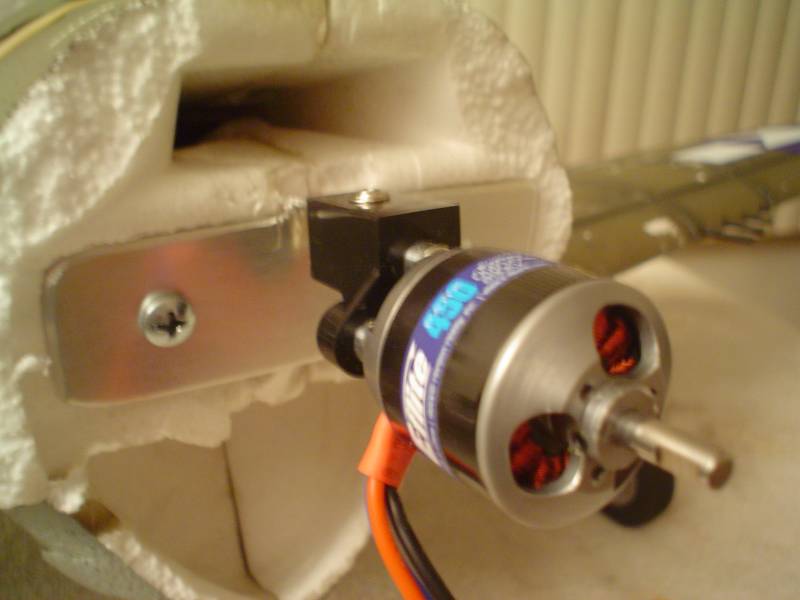

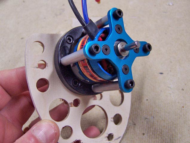

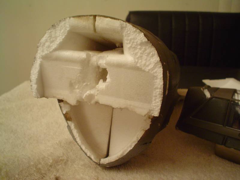

I let my buddy have mine and we ran some more figures...

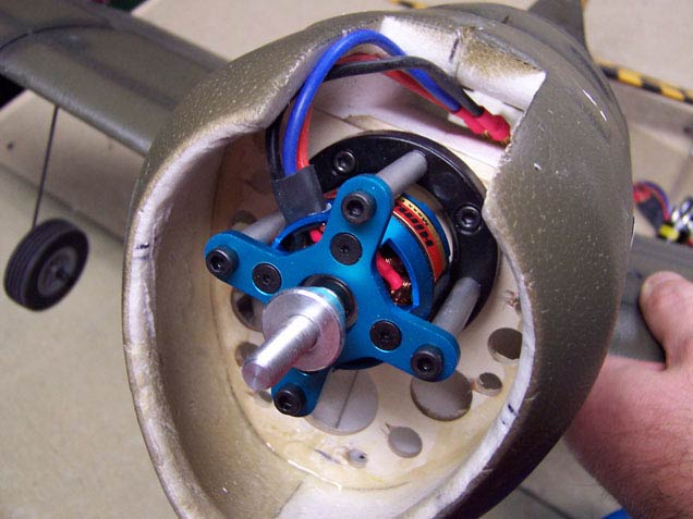

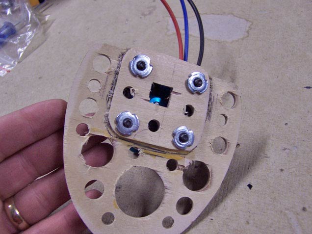

We ended up trying out a HiMax 3510-1100 on a 10x7e prop and a TP2100-3S Prolite.
This motor comes with a nice firewal mount, so he modded the fron of the plane and added a firewall... added about 1/2 oz in doing so. And the motor weighs about 1 oz more than the 450... BUT we dropped all the clay off the nose and moved the battery back for CG.
It now weighs only 1 oz more than it did, but has a LOT more motor in it. It definitely has unlimited vertical as I held it vertical in the garage, he hit full throttle and I slowly let loose... it climbed up so fast I almost didn't catch it.
We hope to fly it soon and get video.... good luck on your flight... I liked the 450 just fine... it has ample power for great big loops, etc... but not unlimited vertical.
-J. David

Hi guys. I'm the friend of Maudib that is hopping up the P47 I got from him. Here's some pics of the motor, firewall, installation and where I had to move things around to balance. After removing all the clay and adding the new heavier motor & firewall, I ended up nose-heavy. So, I had to cut a slot in the bottom of the fuse to move the 2100 pack back for balance. It now rests on a velcro strip on the top of the wing.
Balance is about 1/16" behind the suggested point which should be perfect. I still haven't done a range check with this receiver, so hopefully it will check out OK. As soon as we get good enough weather I'll give it a shot and let you know how it performs. I know it will have TONS of power, but just hope I got the engine thrust angle correct!
Tom

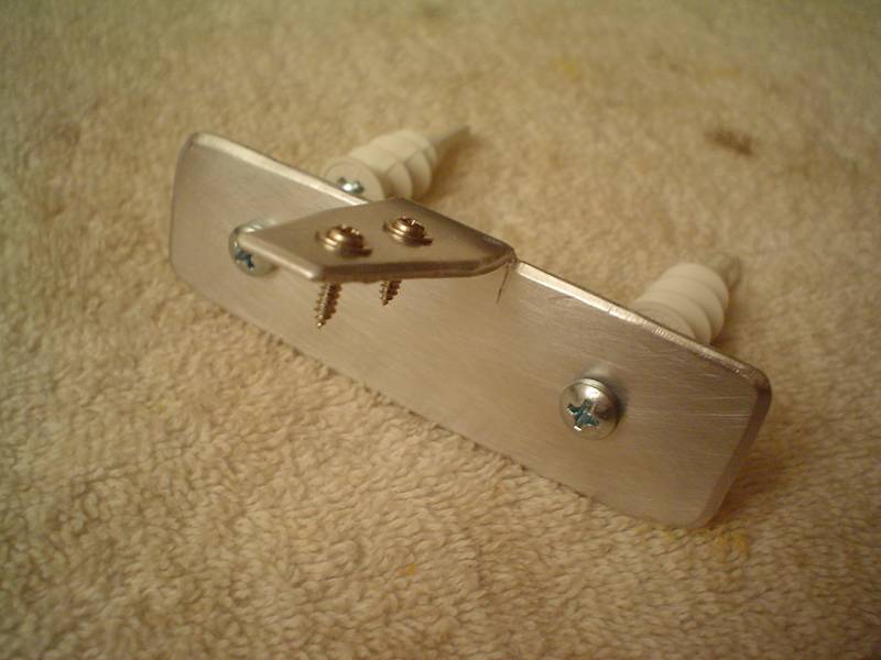

thanks Maudib. its simple but works.. i used some scrap aluminum i had... tin snips a grinder and a cordless drill to make motor mount. ive read that most add weight to balance this plane.. my buddy did to.. even when he ran it with the 480 outrunner and with stock power set up... i started flying last summer with aerobatic electrics and im highly against dead weight in planes... its a little tail heavy and i may try a different lipo or moving 2100 more foward for better balance if it flys badly with current set up. if you and your buddy can get some video it would be great.. not familar with himax numbers but this plane flew very well on the e-flite 1020kv 480 outrunner with a cheap 1800 lipo and 10x7e apc prop.. battery probally restricted performance a little. i think the 450 should be plenty for me and give me good performance all the way around.. i dont plan on doing harriers or anything with this plane but it is nice to rocket vertical from landing speed or accelerate fast during slow passes with high power motors . PS. i'll ask my buddy if i can post his video with the 480.. he ran it for 7 minutes with cheap lipo and temps were fine probally could get 10 minutes easy but i had concerns about the pack he was running and didnt want him to fry it.. it was around 30 to 40 degrees though that day.
