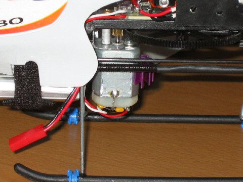

I've bought Hummingbird stock gear/shaft yesterday. Hummingbird gear/shaft has pin on the bottom. Ran couple test flights with inverted J250/stock blades. It has more power and runs smoother but I need to test it with like90 blades which I've ruined last week. Right now I'm in process of installing thin heatshrink on stock blades to gain some headspeed. Will keep you posted.

BTW, I've finished inverted J250 mod ---> seems to have more power and run quiter.

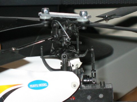

Currently working on bell-hiller mixer mod (~$5.00)... How is your bell-hiller mixer compare to stock?

You have a good point doing mod one by one so you can see the differences. How about rename your new heli to "Jabba" as in StarWars:Return of Jedi
Anyway, I've replaced stripped gear with hummingbird's stock gear and all is fine. I've also tried Bell-Hiller mixer mod and it's much more responsive. It's sort of re-learning cyclic controls and need sometimes to get used to it. See attached for Bell-Hiller mod (cost me nothing) and inverted J250 mod.
.Anyway, I've replaced stripped gear with hummingbird's stock gear and all is fine. I've also tried Bell-Hiller mixer mod and it's much more responsive. It's sort of re-learning cyclic controls and need sometimes to get used to it. See attached for Bell-Hiller mod (cost me nothing) and inverted J250 mod.
Joined: Feb 2004
Posts: 1,139
From: Moira, NY
looks really good. I wish I could do inverted motor...My g-10 frame is in the way. Oh well.... Mabey I will try to wrap some wires together to make it look a bit better. It kinda looks like wires hanging out everywere....I hope I can get my cover on still...
