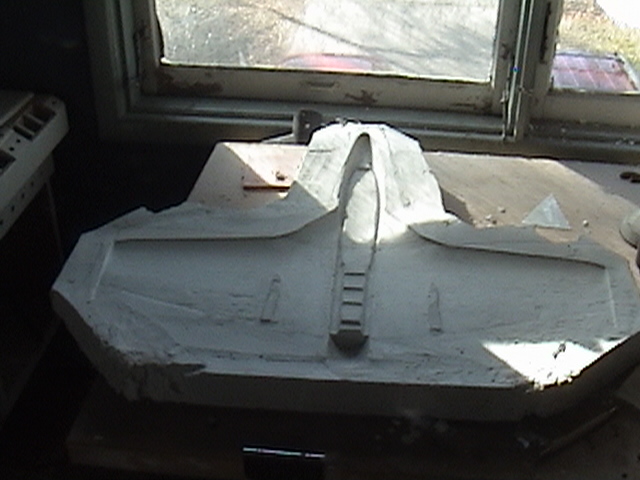

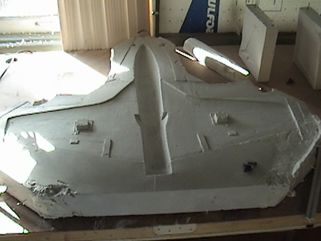

here's some more pic of the soon to be carbonfiber funjet

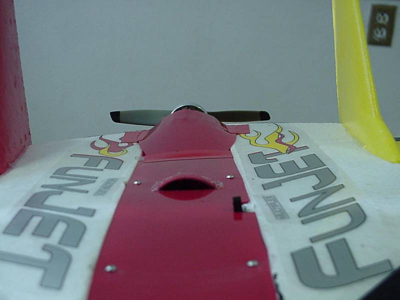

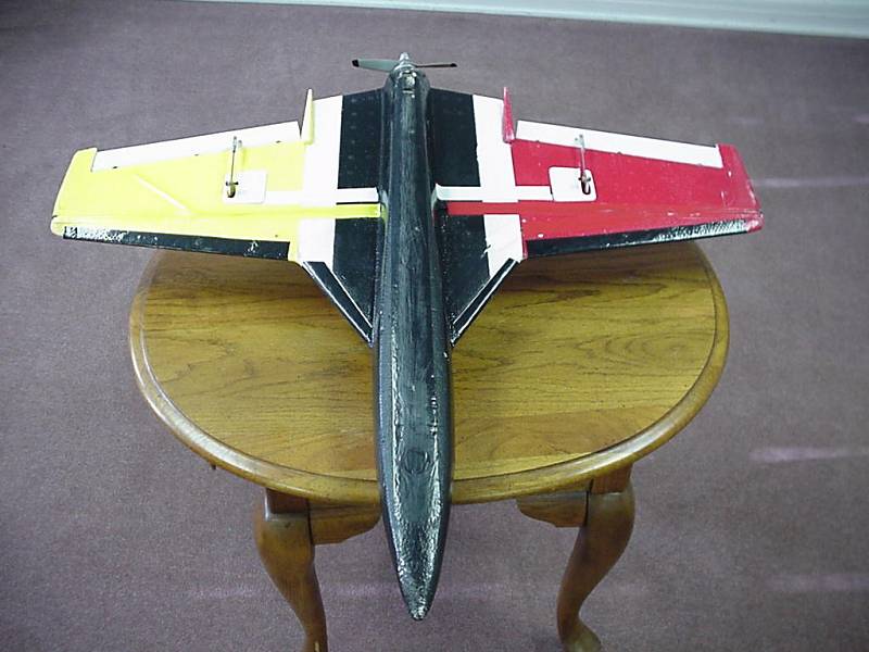

Dang!!! I haven't check in here lately an look at the posts.
rino

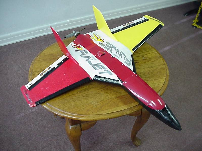

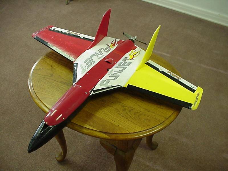

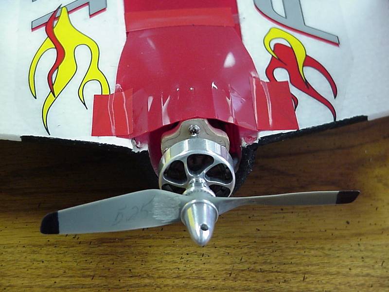

You'll like the FJ much better .....lite is better here's my latest FJ Super Mod.
Running...
Micro Dan 2800kv outrunner
E-flite 60 amp ESC
2200ma 3 cel 30 c batteries and 2500 4 cell 20-30 c batteries
radared on 3 cells level flight APC 5.5x4.5 prop 98 mph
Now running APC 6x5.5 cut to 5.25x5.5
Suggest you go with a short style motor 2700 to 2800 kv range.
This plane has the same type deck mount as my Stryker. I can change motors in 2 minutes or less.
ID:	1079293   Click image for larger version
ID:	1079294   Click image for larger version
ID:	1079295   Click image for larger version
Old 11-26-2008 | 10:11 AM
  #349
Joined: Nov 2004
Posts: 1,261
From: Spartanburg, SC
Default RE: FUNJET

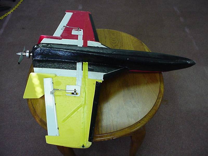

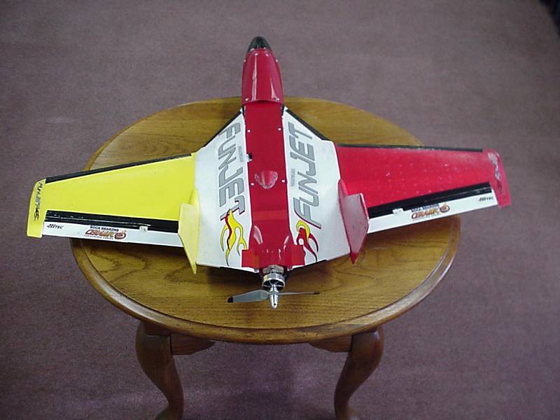

MORE PICS !!!!!!!!
As you can see, I've removed the stock canopy and rear top of the fuse. Removed the end wing tanks...I just sanded them into the same contour of the wing. I did not shorten the wing
Installed CF tubes wing tip to tip. CF tube on the inside floor/bay area nose to tail. Installed balsa elevons 1 1/4".... Hitec 65 mg servos. No balsa on the trailing edge. Used hinge pins, 3 per elevon. Outrunner is on a stick mount. Then sits on a 1/4 balsa block laminated both sides with 1/32 ply-I had to groove the bottom of the block to get it to sit correctly...wire ties down thru and around the CF tube. Motor shaft is equal with the trailing edge as that's the center of thrust.
All covers screw down into small balsa blocks. Simple.
Flys rock solid. High wind doesn't phase it. I have flown this one at the beach in 20 plus mph wind.
I did widen the bay area for future batteries. Oh the canopy..front part made from a 2 litter soda bottle..rear part is made from curtain rod package material nice and flat plastic... I spray painted the insides of both canopys.
Cp
