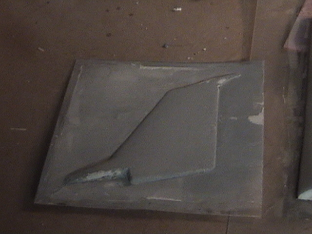

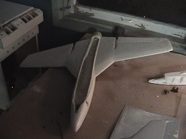

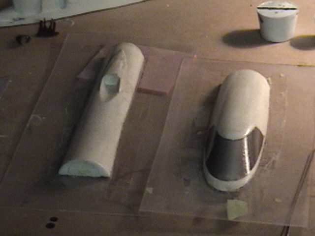

johnny five is allmost alive I have turned a funjet given to my buddy bret and me into a mold so i can make it out of carbonfiber and this will help us fast funjet fan's keep are wing's from getting riped off at high speed. all i have to do now is insert the plactic into the fuse like i have done with the rudder and canapy so i can pour plaster to get my negitaive mold hive me a few weeks and it will be done here's some pic have a look at my youtube channle under b1bman look for the birth of a b1b this will give you a better idea of how this plane is being built out side of a lot of hand shaping the b1b was very little hand shaping to do with the funjet so much easyer than the b1b was
I will have some more pics and video's of this build soon if you all are intrested

funjet body free
molding clay 4.00
minwax polycrylic 10.00
plaster 30.00
carbon fiber and cevlar 100.00
epoxy 30.00
and a all carbon fiber funjet priceless
molding clay 4.00
plaster 30.00
epoxy 30.00
