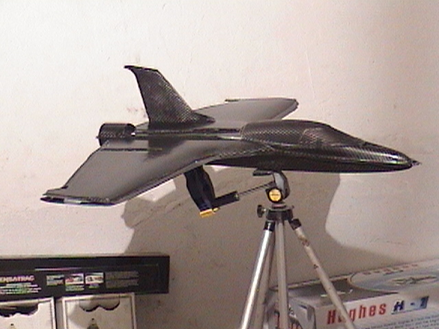

ORIGINAL: theb1bman
I have been working on the carbon fiber funjet
CF monkote???
Looks good

Thanks for the complements chippedprop I do have a series of build pics of the Aurora (modified twin jet) at different stages of it's transformation and I would be happy to share them with you guy's if if you want and give details of my build methods to those who wish to know .I have gotten a great deal of info from the many forums on line covering many aspects of building and using materials and would be glade to pass the info along to be used . Let me know what pics or info you are interested in seeing and I'll see if I can oblige . Woody

yep I'll use it

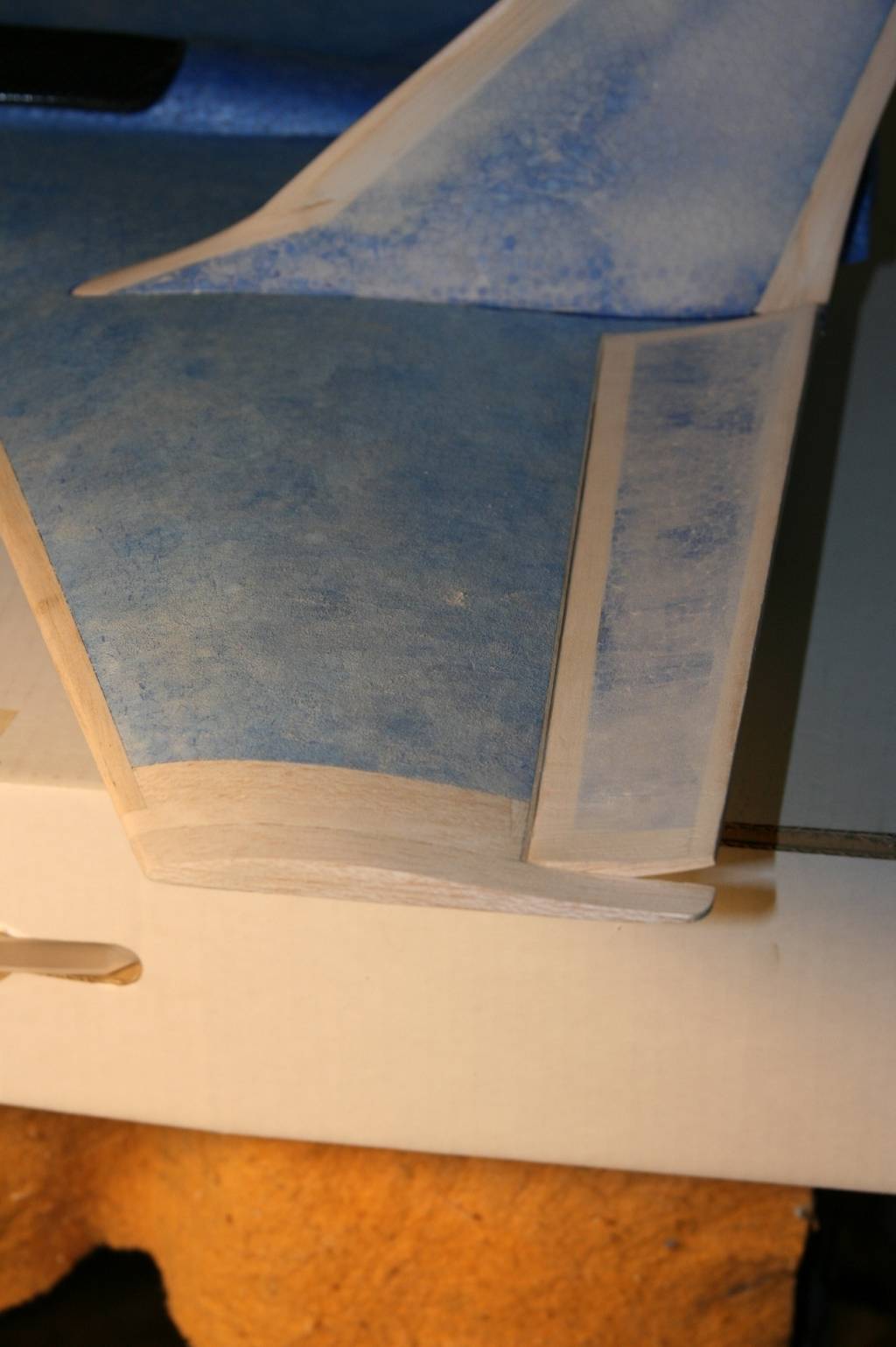

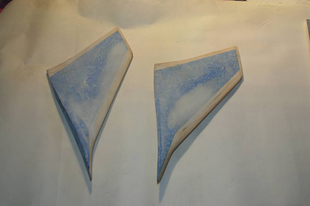

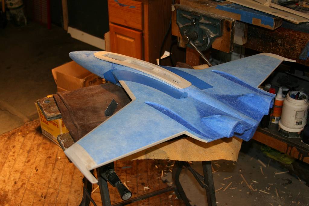

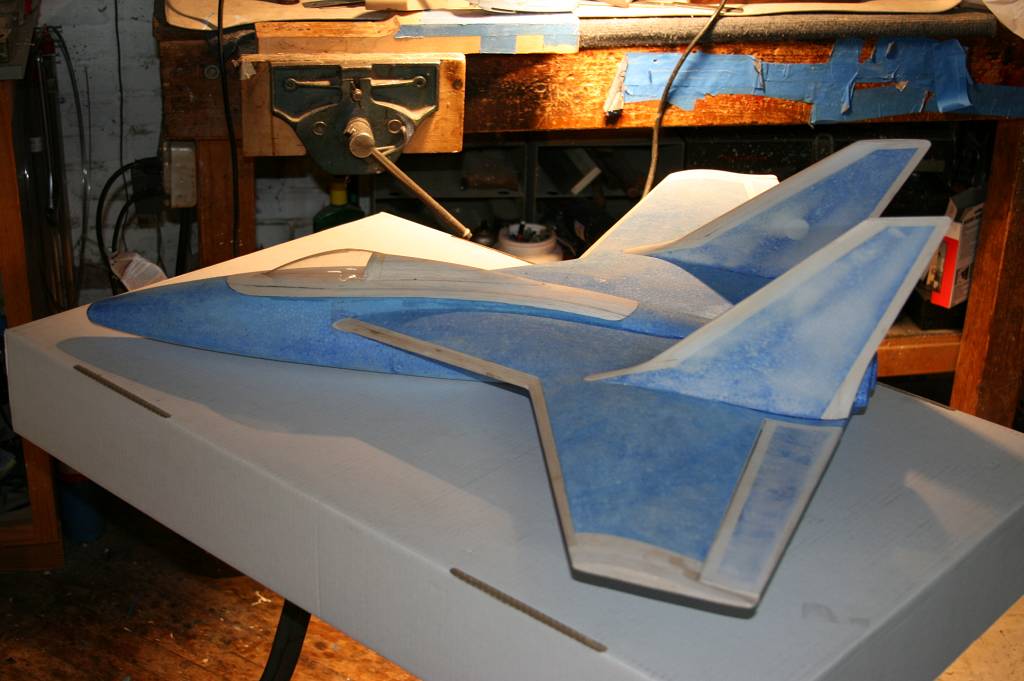

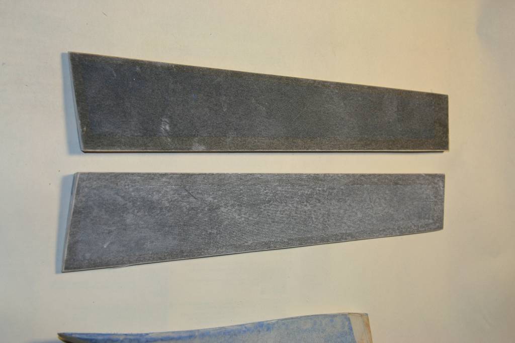

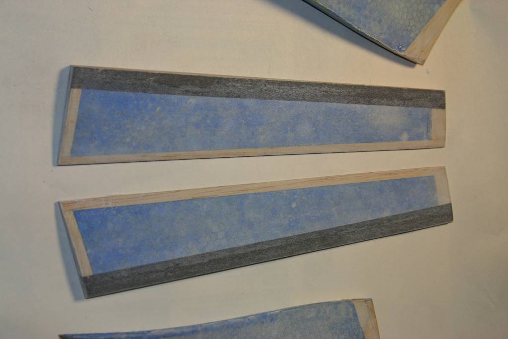

Hey guys these are a few pic's of the early work done on the Aurora (TJ) after I had reshaped the airfoil and framed out the wing and vertical stabs. The framing made a tremendous difference in stiffness of the wing ,I also extended the wing 2.5". Framing the vertical stabs and elevons also made these items really stiff and resistant to torsional twisting. The elevons and stabs also sanded down to reduce their thickness and were glassed using a very inexpensive bagging method.I used a Reynolds Handi-Vac food bagging system that's used to store small food portions(the system comes with a vacuum pump and some small bags) ,the bag I used was a 1 gallon size that measured 10 9/16"x11 1/2" big enough for the vertical stabs and elevons. The Handi-Vac system cost 10$ here in the US and the large bags were 4 bucks can't bet that.You will need two other thing no.#1 a material called peel-ply that will be placed over the item once the resin and glass have been applied(it will allow excess resin to pass through it into the next layer). no.#2 breather cloth that will be placed over the peel-ply (it will absorb the excess resin that's squeezed out) then the whole thing ,glassed item cover with the two additional layers is put into the bag and the air is vacuumed out .Leave the bag overnight and when you remove the part you will have to peel off the two last layers and you will have an incredibly stiff light weight part ready for paint with just a bit of light sanding. all parts must be sanded even if you don't want to change their shape to remove any mold release agent present on it's surface.I recommend using 220 grit down to 400 grit and use a sanding block for all flat wing surfaces and leading and trailing edges it will give you a very flat ,true finished surface finger tips will not work as well on large surfaces. I used 2 coats of light weight spackle sanding between each coat with 320 to 400 grit paper .All elevons and stabs covered with 2oz cloth and West System resin elevons had carbon vail added to le of bottom and complete topside. If this info is missing anything please ask I will fill in the blanks.

Old 09-25-2009 | 10:00 AM

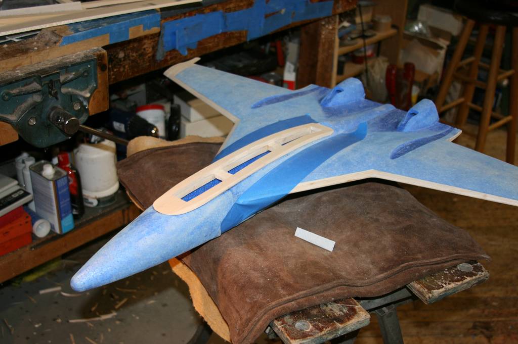

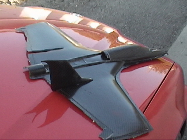

any one know the empty weight of a Funjet? mine looks like it will be around 28 OZ to 36 OZ
I got the canopy done and should have the bottom or the plane done to day
heres some more pics

that Aurora will be nice I wish I still had a twinjet.
I do still have a couple microjets that I will mold up one day
we name this funjet Johnny 5 from the movie Sort Circuit. There was a number 5 on the plug plane that was donated

theb1bman is that 28-36oz empty weight if so that's not as light as I thought it would have been for that size plane.What kind of resin did you use and did you do anything to remove the excess resin from the carbon fiber when you did the layup. The Aurora's empty weight complete with paint job is 25oz and AUW with 4500mah 30c 3s plus 2x100ampesc Castle Ice esc's ,separate Castle bec, HS 82mg x2 servo's ,Just Go Fly 550th motor'sx2 ,custom motor mountsx2= 58oz and 62oz with 5000mah 30c 4s.

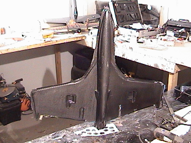

ya I did my math wrong
just the top half is 6.5 OZ canopy is .3 OZ and rudders are .7 OZ and I'll say the bottom is 8 OZ and the back canopy is .7 OZ and the batt tray is 1 OZ
6.5
.3
1.4
8
.7
1
= 17.9 OZ
then I'll have to add the spar, ribs, glue and spray foam weight
yes I do use 3/16 cotton cloth and West Systems epoxy
I also just tried Fiberglast.com's new stretchlon bagging film and WOW!!! way cool if conforms to nearly any shape. If it is not quit as close to the mold as you want heat it with a heat gun and it will be

That's more like what I thought it would be excellent work can't wait to see the finished project .Thanks for that product info very neat stuff going to order several things from them today for my next project. Look forward to your next post and pic's. Woody

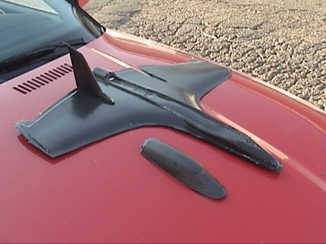

here's some more pics
13.1 OZ
