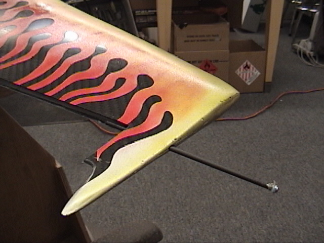

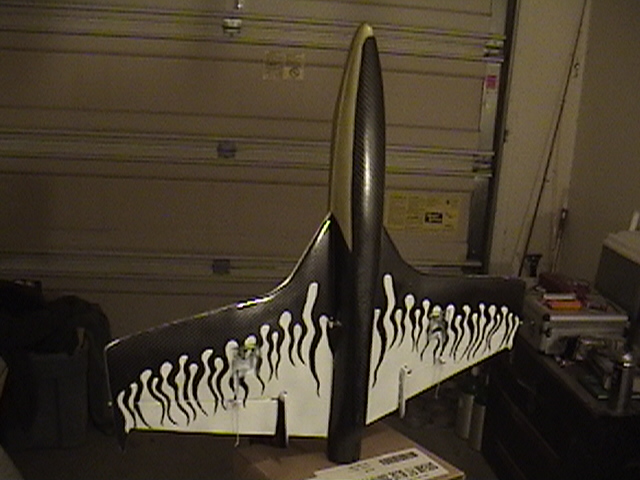

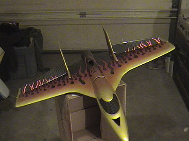

I think the elevons will stay on and lots or room for batt this is the set up I will use as soon as I get the motor I have every thing els
1512 2d NEU motor 2 3 cell 3900 to make a 6cell 100 amp ice 5x5 prop. all this come up to 1800 watts 50,000 rpm on the prop and over 200mph on the prop speed
It fly's well on 3000 kv and 2200 3 cell with a 6x5.5 pro but had to put in a lot more expo very touchy on the sticks

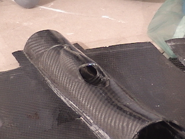

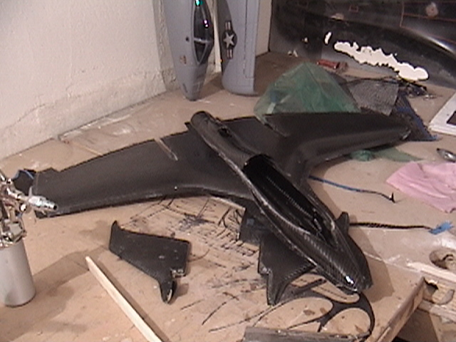

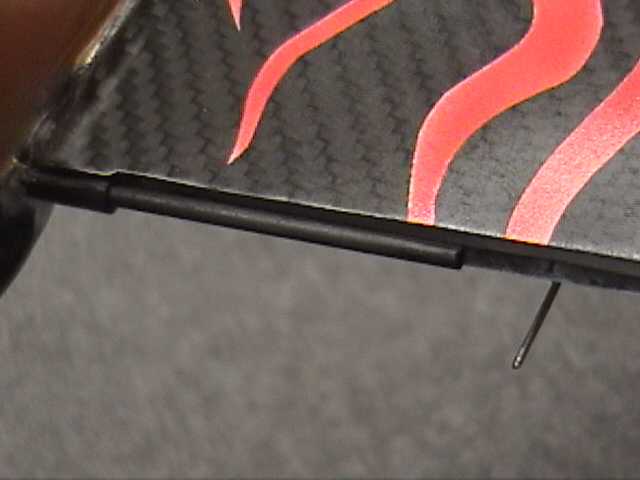

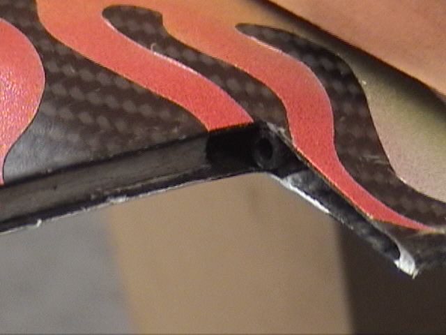

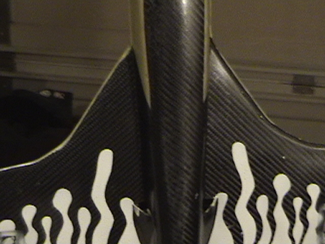

the hinges are carbon fiber tubing two sizes one fits in side the other making the pivot I'll post some better pic when I change the servos out
she is kind heavy 20 oz empty and 32 oz with a Phoenix 45,3114 futaba servos, ar500 spectrum, 2200 3cell 30c, typhoon 3w
still hand launches fine
