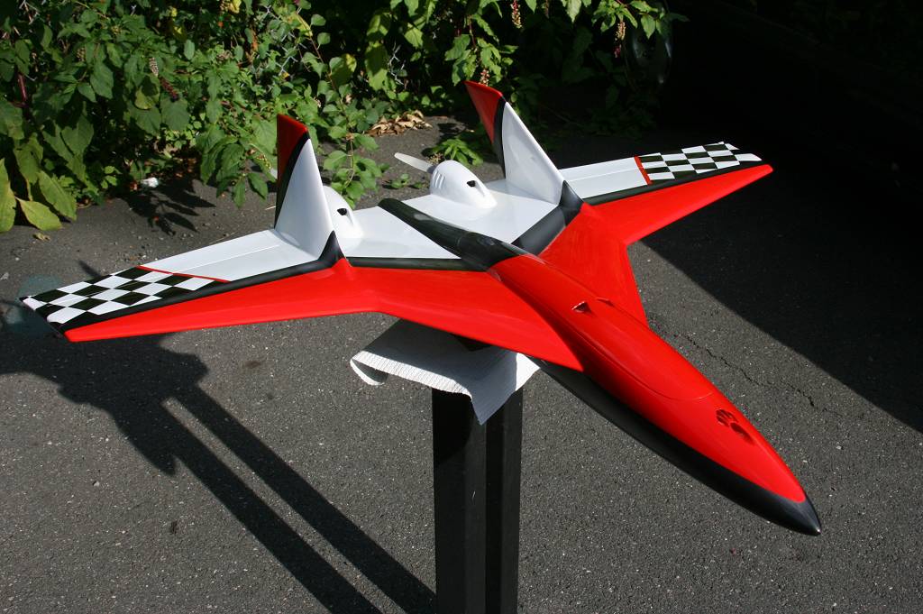

#808
Joined: May 2009
Posts: 38
From: Garnerville NY,
NY
This is the finished prototype which will be flown with several power setups after which I will determine what if any further changes need to be made before making a copy plug of it .The plug will be used to make a fiberglass and possible aluminum mold in order to make several using fiberglass with carbon fiber in key stress areas. This project started as a Twin Jet but now bears non of the TJ's specifications except it's still a twin motor, it has been totally reworked, new wing and vertical stab airfoil,reshaped fuse,increased wingspan(38.5") custom designed air intakes and extractor ducts and custom designed dual canopies one for show and one to "goooo".New designation The AURORA
#810
Joined: May 2009
Posts: 38
NY
There is a good possibility that there will be a few available this time next year and it will be a molded glass ship similar in construction to the Baio jet .
#811
Beautiful plane Blanik! Its been awhile since I have posted. The military has been keeping me busy. I've been flying my Funjet and Phase 3 F-16 for a bit. Till I killed my F-16. There is a reason in the Air Force we call them Lawn Darts, I figured the plane was just living up to its name. I finished rebuilding my Stryker yesterday and have been flying at the park today, she is still fun to fly, but looks nothing like your guys sweet looking builds!
#812
Joined: May 2009
Posts: 38
NY
Thanks for the complement flighttops it was a long term project that took a lot of patience to complete but was well worth the effort. I am still making improvements to the power system and expecting to post some serious speeds in the near future but rite now she's still new and in that sorting out stage so increasing speed will be in increments.Good luck with your flying and stay safe.
