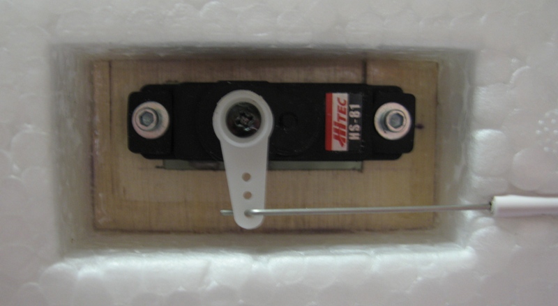

So, with some effort, we could easily be under 60 oz's with our build. That should work out pretty good then. Well over 50% thrust to weight ratio is easy to acheve then and safe to fly. I am one to love "more-power", and rarely build with less that 180% thrust-to-weight ratio for 3D.
I see the photos apparently indicate full-size servos. Maybe HS-55 servos will work the tailfeathers, with a HS-425BB on the ailerons, maybe get us even lighter... What servos are you flying? On a trainer, not a lot of torque needed, small throws with good mechanical advantage.... hmmm. How do you feel about servo torque requirements?

Well, finished the build on my Father-in-law's Magister over the last few days since Christmas. Used HS-81 Servos, and made servo plates from 3/32" ply glued in with foam-safe CA (see photos).
Drum roll please..... the AUW came in at 53 oz's! Well under the 60 oz target weight... nice
. All that's left is to add decals.
Setup:
AXI 2808/24
CC Phoenix 35
Dymond Modelsports 3S HD 2100 mAH 12C Lipo
JR UL610 Rx
APC 11x5.5E
This rig will make 275 watts @ ~25 amps, and pulls 45 oz's thrust. I'll retest that and verify, get more precise numbers when I get time. Should fly pretty well with 85% thrust to weight ratio. CG came in dead on the book recommendation without special arrangements, everything in stock locations. The lighter servos rear seems to offset the light motor up front. Sweet!
This is a very nicely engineered chuck of foam, I am impressed. Everything fit to gether very nicely. I only made a few minor mods in the build. I think some Dubro Ultralite wheels will kill another once or so. I was able to get some great throws on the controls too, and these HS-81's are very quick and seem to have plenty of power to slam the surfaces to the stops. Should fly well, can't wait to maiden.

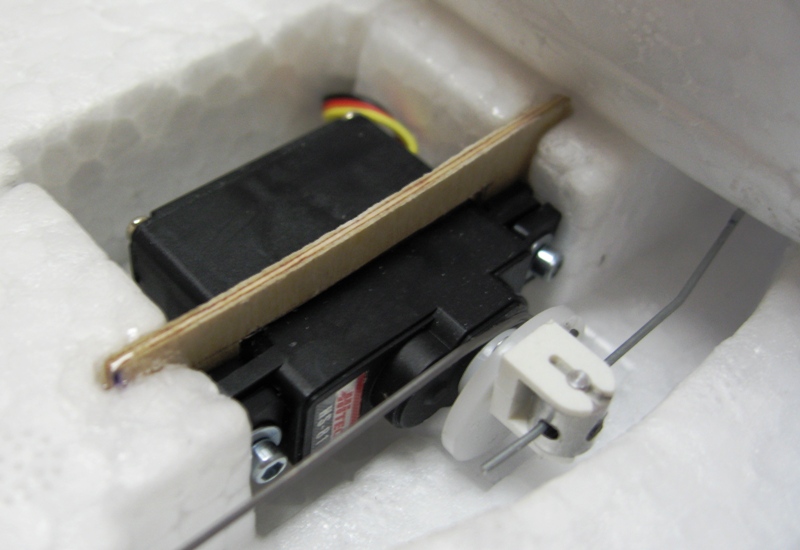

Oh, kept forgetting to mention it. If you have trouble with control surface freedom, take the exacto and trim out a few sections of the hingeline so there is only 3-5 tabs about 1" to 1-1/2" long acting as a hinge. Works great, and the freedom is greatly improved and you can get much bigger deflections too. Tempted to put in pinned hinges, but this is working well enough with the HS-81 servos. Full throws without working the servos hard at all... nice.

I finished today my new motor mount for the Hacker motor. I had to build it up from scratch, as I wasn't able to get one from any of the LHS nearby. I used aluminum we had at my workplace. It's a bit thinner than the original mount, but I think it will work better.
I also installed pinned hinges on the ailerons and finally did the extra servo setup for using flapper-ons. Now I'm only missing the elevator hinges, but will place them tomorrow night for sure. Ailerons were really easy. I installed 5 hinges on each one, and glued them with foam safe CA. I've done some pull tests and they seem to be glued correctly. The aileron movement improved significantly.
