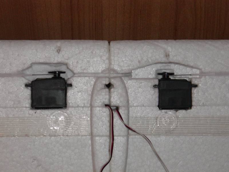

I'm trying to figure out how to upload some photos for you on the install. Pretty simple. Just cut out an equal size portion on the opposite side of the wing for the other servo. Shorten the linkage and you're all done.

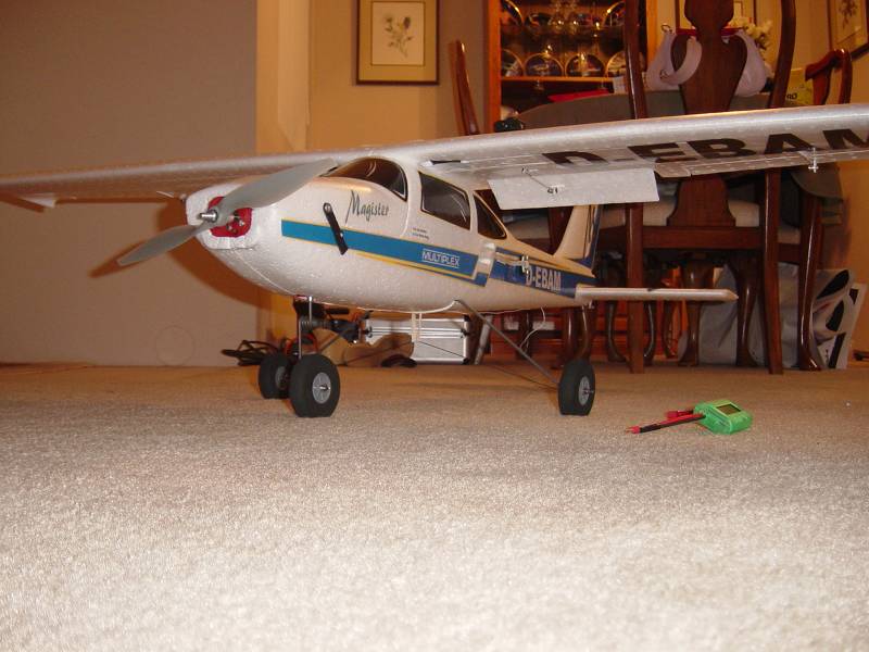

3 weeks after my crash, I've finally rebuilt another Magister. I upgraded the motor to a AXI 2826/10. ESC is a CC Phoenix 45. I kept the second aileron servo and also installed a set of inboard flaps. Place also has a FMA Co-Pilot installed. To windy to fly today, so I'll try it out tomorrow. Here's some pics.

What li-pos are you using and what is their capacity. I purchased two GP3300s from you a month or so ago and am going to move to li-pos as well. I didn't even use them. I flew the maggie once on the stock battery and decided to go lighter with more voltage. How did the stock motor work with the li-pos added voltage?

Could you post some pictures showing the configuration of your flap servos? I am thinking about doing flaps on my Maggie using HS-55s. What servos did you use?

Great pictures, thanks Joe. Interesting that you covered the servo bodies with tape. I assume you did this for aerodynamic and/or dirt control. What hings did you use?

The tape was just for asthetics. I had some lying around, so what the heck. Hinges are Robart size 307 hinge points. 3 per flap. As far as flying is concerned, I don't anticipate being able to fly anytime soon. I showed up at my regular place today (vacant office building with a large parking lot) and there was a fence erected all around the place. I don't have access any more. I spent a few hours driving around trying to find a suitable place, but no luck. I live in the San Francisco Bay Area and it's quite developed and crowded. My advice to anyone wanting to live here...Don't!!! It's very expensive. Average home price is over $600,000, crazy! Very few open areas in which to fly that are away from people. I did the club thing for a while, but got tired of the fees and rules. Plus it's crowded on weekends too. My company is moving me to Sacramento next month and I'm hoping I can find more open space there. Here's a pic of my flying spot...pardon me, former flying spot. I love Google Earth!
