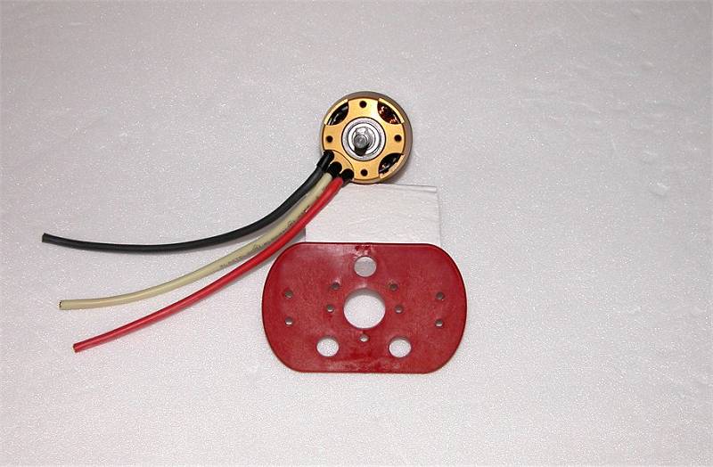

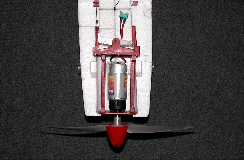

The hop-up starts by removing the stock power system. I had a burr in my motor shaft which made it difficult to remove the prop adapter but otherwise the removal was easy.

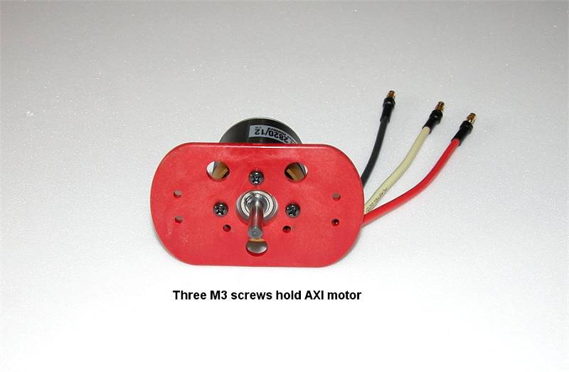

The motor mount cage faceplate can be easily unscrewed. The holes used by the stock geared Speed 680 motor are not the same ones needed for the AXI 2820 motor. A second set of existing holes is almost a perfect fit for the AXI motor so you only need to very slightly enlarge them to create a perfect alignment that matches the motor.
The new AXI motor weighs only 5.2oz compared to the 11.4oz stock geared motor. Already, we have an incredible 6.2oz drop in weight so we are off to a great start!

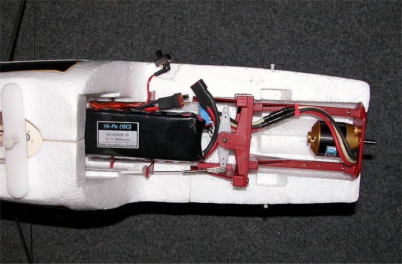

The proper mating connectors need to be soldered on the battery pack, ESC, and AXI motor. The Jeti ESC supplies the connectors for the motor but you need to select your own power connectors. My favorite connector for this level of power is the Dean's Ultra.
The stock 8-cell, 1900mAh NiCd pack weighs 16.5oz and the replacement 3-cell, 4000mAh Lithium pack weighs only 9.8oz. We dropped another 6.7oz in weight and added the voltage of two more NiCd cells.
The incredible benefit of new technology like brushless motors and Lithium power has not only increased performance but reduced the weight by an amazing 12.9oz!
I needed to slot the upper middle hole in the motor mount slightly towards the outside edge. This allowed the motor to mount easily with three M3x10mm screws. The motor mount plate was then installed back into the frame in the fuselage.

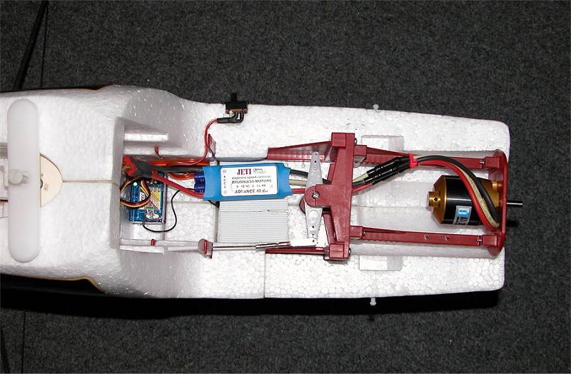

The Jeti ESC is held with Velcro and I used a Tywrap to secure the motor wires. The On/Off switch sat in tha same position as the previous ESC for brushed motors.
I made an EEP foam step to cover the ESC and support the battery pack. It has Velcro on both sides.
The lighter pack fits nicely across the receiver and ESC. I check the CG after installing the wing and it was just a bit nose heavy which will be perfect for testing. It was originally flying a bit nose heavy with my stock power system although it is not likely needed as these trainers are very stable flyers.
