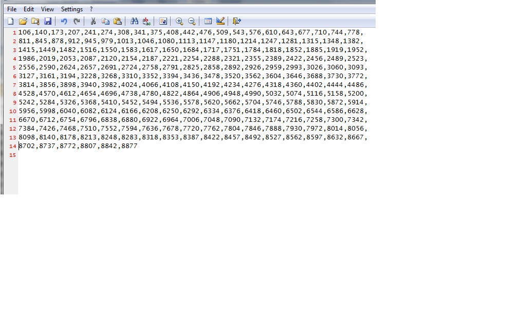

I tried John's curve and for me the timing curve is right where it needs to be at startup through WOT.
Jake,
I have a question though in the curve John is using
1) above table the first value is 1448075. how is that usable? Its bigger then the biggest number that timer1 can hold and there other values similar.
2) the table has a 2 as the second number it seems that the numbers should go in some kind of order.
3) the first row it seems that the numbers are all over the place (example)
108,100,91,83,74,65,57,48,39,39,41,44,47,
49,52,55,57,60,62,89,117,145,173
Now I am guessing that at lower rpm the pic is using the numbers at the end of the table and as the rpm increases the pic uses the values closer to the beginning? is this right?
as I mentioned on my engine sim using a timing light the curve is where it should be.(IMO)

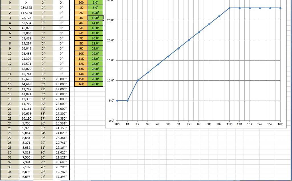

If curve is linear like belownumbers shouldbe in order. 3 things thatI think can give you the numbers in different order .
1 data colection to the Copy/Paste Cell
2 calculation
3 curve .
One of them it my have couple bugs.
Curve can influence the numbers. If you taper down at HI RPMS then your numbers are going to change,If you use a curve similar of
ROB posted here.
If you use something like I just test here then they should be in order.I just used 12F683_CDI_v0.9b3 excel file.
LOW RPM= Hi number
Hi RPM= Lo number
So... in order to make sure "numbers are right" make a linear curve , spread the numbers as equal possible over the RPM range.
Look in to the table data and you should all numbers in order.
After that go ahead and create your desired curve.
In this particular example that first number is an issue....can be a data colection,calculation .
Take a picture of the curve and posted here. My be able to pinpoint better.
Like I saidcan be one of the 3 or all 3 of them with the new version of the file.

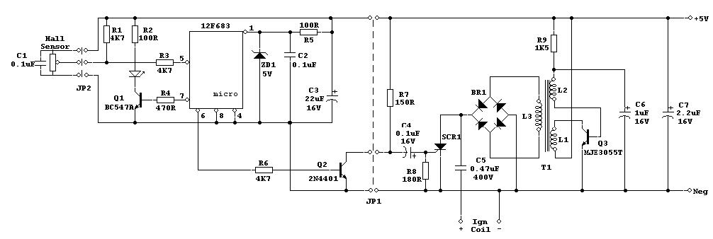

Charlie, I don't know how you are getting that table. Maybe your hall sensor degree setting is wrong? When I set all the advance curve to 0 I get the following table...
5333,0,0,0,0,0,0,0,0,0,0,0,0,0,0,272,293,314,335,3 56,377,398,419,440,461,482,503,524,
4997,5018,5039,5060,5081,5102,5123,5144,5165,5186, 5207,5228,5249,5270,5291,5312
These should be the max values for waiting all the way to TDC with 30 degree hall sensor placement.

The hall sensor is active low, like in your picture. So the falling edge comes right as the magnet is hitting the sensor. That's why I figured on using the falling edge. If I used the rising edge I would be getting the interrupt right as the magnet leaves the sensor.
> In the code, you can also wait for the Hall input (GP2) signal when there is ignition timing delay is not ready?
The interrupt only triggers on the falling edge. So it will only produce one interrupt per rev. The rising edge will not trigger the interrupt, so we don't have to worry about it.
It's not. You must have an error in the spreadsheet. Everyone should check their numbers. There should be nothing larger than 5333 in the table if you hall is at 30 deg. If you hall is at 40 deg. then you should have nothing above 7125.
I should have mentioned this. The first number is actually table value 256.
I'm using an 8-bit variable for CurrentRev. In order to get double the resolution (128 instead of 256 uS) I'm using the low 8-bits of Timer1 to round up or down. So we can get 255 for CurrentRev, but then if it gets rounded up it will go to 256, which rolls over to 0 since we're using an 8-bit variable. So a CurrentRev of 256 will end up being 0.
I figured this was a pretty slick way to do things. A real CurrentRev of 0 can never happen, unless you were running at infinity RPMs. So I use table value 0 to get an extra table value out of the same space, and it accounts for the chance of the max value of 255 getting rounded up to 256 and rolled over to 0.

Ilook at the excel file , Last Rev3 ,I had a bit time today and in the Table value on the D3 for copy paste I look at the statement and reason for starting with the high number and then small is
that it gets first cell G262 and then G7,G8....etc.
I change the beginning and the end of the statement and then all comes in order. Un less you need the G262 for some reason to be first. .
G262= 916RPM
As far as calculation all seams to be OK, I test it with a linear curve like in the last posting and all comes in order .
If you make a wave curve then numbers are up and down to reflect that.

=TEXT(G262,0)&","&TEXT(G7,0)&","&T EXT(G8,0)&","&TEXT(G9,0)&",........... ....,"&TEXT('Table Values'!G261,0)
After:
=TEXT(G7,0)&","&TEXT(G8,0)&","&TEX T(G9,0)&",..........,"TEXT(G261,0)&","& ;TEXT('Table Values'!G262,0)
The last table value DOES need to be first. CurrentRev can be 255 and get rounded up to 256. Since it's an 8-bit variable setting it to 256 rolls it over to zero. That's why the last value ends up in the first slot in the array.
Zero is not a valid revolution time, so I'm just making use of the zero slot in the array to handle the case where the highest value gets rounded up.
-Jake
-Jake

Table valuas from John (website Jake) without any changes, just open Exel-file and copy / past from cel D3 tab tablevalue
9272,2,44,86,128,170,212,254,296,338,380,422,464,5 06,548,168,174,167,160,152,145,138,131,124,116,109 ,102,83,63,43,39,41,44,47,49,52,55,57,60,62,89,117 ,145,173,200,228,256,290,368,445,522,599,676,753,8 31,908,985,1062,
1139,1209,1270,1330,1390,1451,1511,1571,1631,1692, 1752,1812,1873,1933,1993,2053,2114,2174,2234,2295, 2355,2397,2436,2475,2514,2553,2593,2632,2671,2710, 2749,2789,2828,2867,2906,2945,2984,3024,3063,3102, 3141,3180
,3220,3259,3298,3337,3376,3416,3455,3494,3533,3572 ,3611,3651,3690,3729,3768,3807,3847,3886,3925,3964 ,4003,4043,4082,4121,4160,4199,4238,4278,4317,4356 ,4395,4434,4474,4513,4552,4591,4630,4670,4709,4748 ,4787,482
6,4865,4905,4944,4983,5022,5061,5101,5140,5179,521 8,5257,5297,5336,5375,5414,5453,5492,5532,5571,561 0,5649,5688,5728,5767,5806,5845,5884,5924,5963,600 2,6041,6080,6119,6159,6198,6237,6276,6315,6355,639 4,6433,64
72,6511,6551,6590,6629,6668,6707,6746,6786,6825,68 64,6903,6942,6982,7021,7060,7099,7138,7178,7217,72 56,7295,7334,7373,7413,7452,7491,7530,7569,7609,76 48,7687,7726,7765,7805,7844,7883,7922,7961,8000,80 40,8079,8
118,8157,8196,8236,8275,8314,8353,8392,8432,8471,8 508,8545,8581,8617,8654,8690,8726,8763,8799,8836,8 872,8908,8945,8981,9017,9054,9090,9127,9163,9199,9 236

Unit firing at power up due to the way 150R (R7) is connected to positive rail and transistor collector (Q2) must pull down to turn off.
Same as with Gompy's old 16f628A ignition that had switching for either a CDI or TCI system. In John's CDI power board he shows an alternative connection for R7 depending on whether you use points, hall effect directly or input from a certain pic micro circuit.
If the circuit was changed so that 150R (R7) was connected to ground and the transistor collector (Q2)connected to the positve rail, then this would not happen. It probably requires software change on GP1 though.

So we just have to convert this assembler routine into a "C" routine and the input routine should then function correctly.
I think I may have saved some of the old routines from the old project we can try.
Jake, would it help to have the old excel file that we had used to generate the c code after making the curve from the previous project, or have you already obtained a copy? It would probably have to be edited since the c code is using the data collected in a slightly different sequence but may be helpful. Nyemi had suggested the original routine when we had the problem before.
As for the numbers in the curve looking odd and being too large, the spreadsheet generated numbers do come out right if I do a flat curve. I didn't edit anything else that I can remember, just the curve. I started at 0 rpm and 0 degrees of advance if that is of importance. Just trying the curve in a compiled hex file showed no bad reactions during the running of the engine, so it must not be affecting the timer output to the ignition. Either way, it was a test run which gave us an idea of how it worked so far. A little tweaking here and there should have the code working as expected. It's come a long way in a very short time, there are bound to be some setbacks to overcome.
John
John
