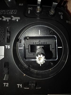

most radios have index marks on the gimbals
It looks like mine doesn't have any marks at all, do you have an example please?

2: It looks like mine doesn't have any marks at all, do you have an example please?

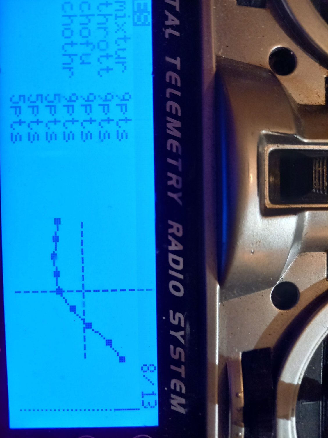

1: The programming is done in the transmitter, of course, and I work in OpenTX which is slightly different from EdgeTX. Whatever the case, in OpenTX you can assign every separate receiver output to any combination of imputs. So I assign for example receiver output 1 to the throttle stick, but also to the throttle curve. I hook up throttle servo to output 1.
Then I assign output 2 to that same throttle stick, but I assign the fuel curve to this output 2, and hook up the solenoid.

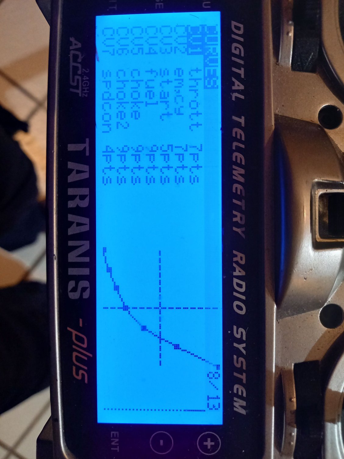

By changing the throttle curve, I can change the RPM characteristics of the throttle stick. I set this curve once, then never change it, EVER. This is in part experience based, and I aim for a linear relation between stick and RPM, such that stick full back is idle, stick full forward is full RPM, and midstick, the RPM is as close as possible in the middle of the availlable RPM range. It turns out, that most "barrel carbs" have approximately the same throttle curve. It is not really critical, and there is no need to change if mid-RPM is a few hundreds off.
By acting on the fuel curve, I can set fuel/air mixture correct for every indexed stick position.

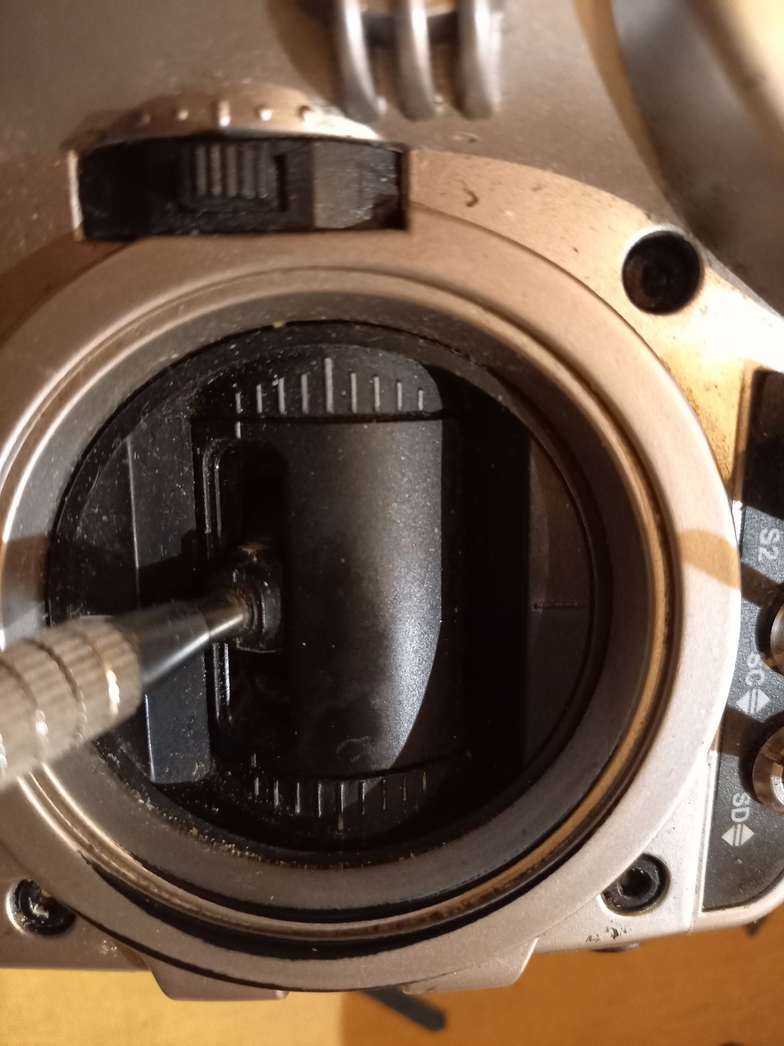

2:
Sorry for the pic being sideways, I am not smart enough with computers to rotate it.

Same story, rotated, apologies.
5: I have experimented with 5, 7, 9 and even with 17 points. For purposes of accuracy, 5 points is enough but noticably "imprecise", 7 points is usable, 9 points marginally better than 7, and anything above 9 only is confusing, but does not lead to better results.
Initially I used 7 points (as can be seen from the throttle curve, which I did not change) but I found that in order to set the fuel curve you need to be able to consistently find the same throttle position again and again.
That is when I started using the index next to the stick, and since my transmitter has 9 index points, 9 curve points it is...some transmitters have 7 indexpoints, others have no index at all, and then you need to use other means availlable. Some transmitters allow to show the stick position in a display screen. I cannot tell from here, what the oiptions for your particular gear are.

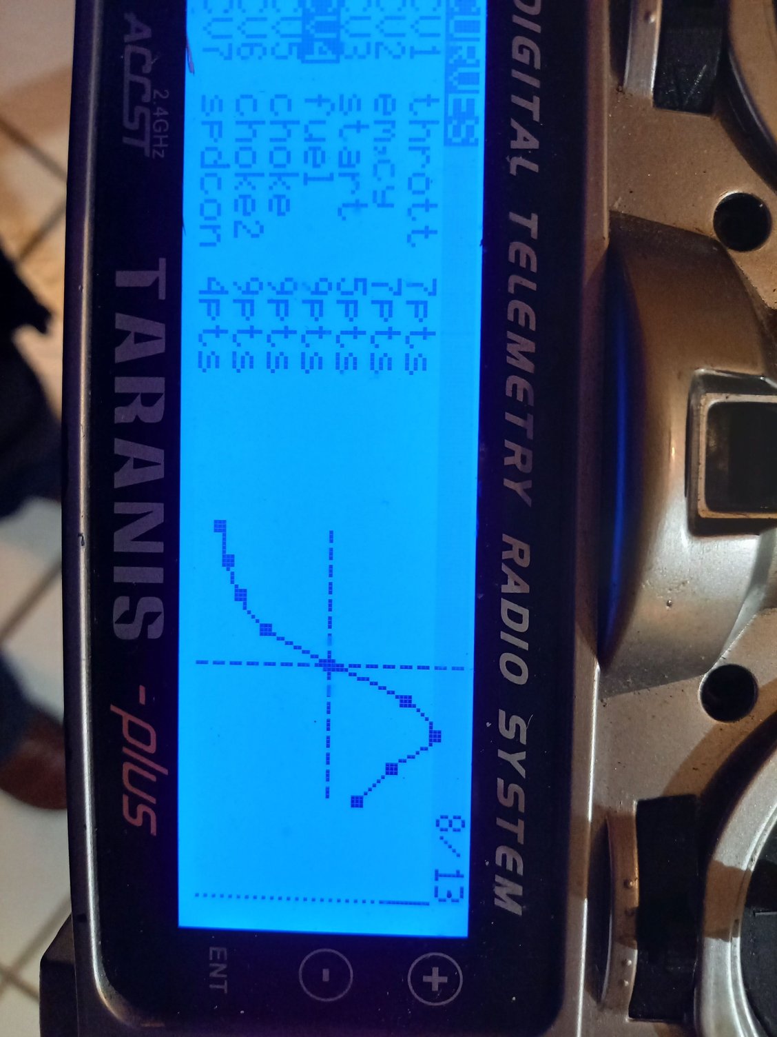

This is one example of a weird curve:

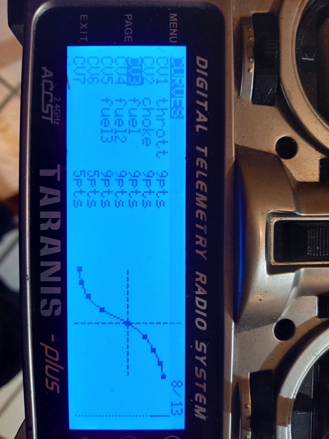

But more common, they look a bit like this:

The shape of the fuel curve CAN be influenced by the position of the low speed needle. Closing it a touch, forces you to raise the low end of the curve a bit, opening it up, forces you to lower the low end a bit.
A too low curve looses resolution, it is always advisable, especially when you have trouble getting mixture correct in the low range, to force the curve up a bit by ever so slightly closing the LS needle.
The throttle doesn't have any markings and the ratchet has 22 indents, so that's going to be fun, funnily enough the airelons have 7 markings, but I don't know if the rachet corresponds (no point looking). I'll have to make an inlay which will hopefully line up with the rachet. I suppose if the system is sensitive one notch may make a difference? Always something. As a matter of interest what do the corresponding curves look like for the valve?
You can try making a temporary (or more permenent) index yourself, or you can perhaps do your testruns with the stickpositions "on screen"? Another option is to use the call-function, where activating the momentary switch (the one that springs back when you let go of it) to audibly call out the stick position.
As for the bolded: A bit confused, because I posted 3 examples of possible fuel curves (from 3 different engines)? Of the four curves I posted, the first one is a generic throttle curve. They all look like that, they all are a progressively increasing curve, individual differences are at best the value at midstick being slightly higher or lower, but they all start at -100, and end at +100 in a single progressive curve upwards.
The other three are fuel curves. They can look like anything, but common properties are that they are "smooth" (no strange spikes) and they usually have a vague S-shape like the 3rd pic from top, or a U shape like the last pic.
The first fuel curve (2nd pic from top) is a bit of an outlier with its sharp drop at the top of the throttle range, and I have no explanation as to why it is shaped like that, It is the only one of my engines that requires a cyrve like that...
