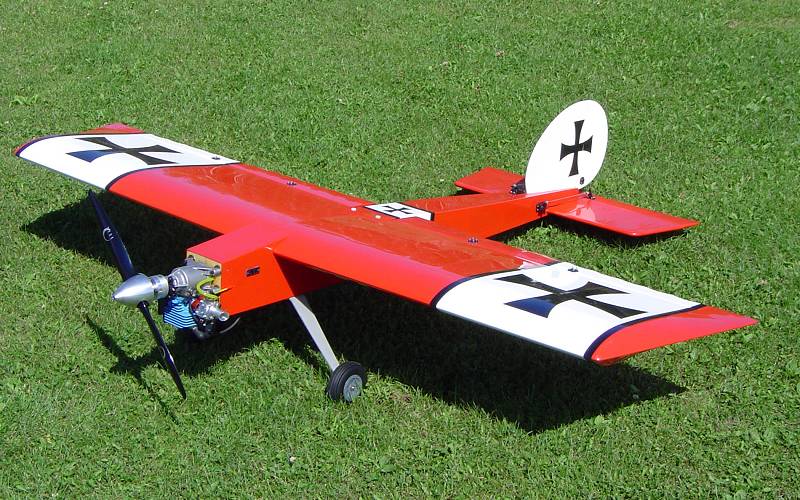

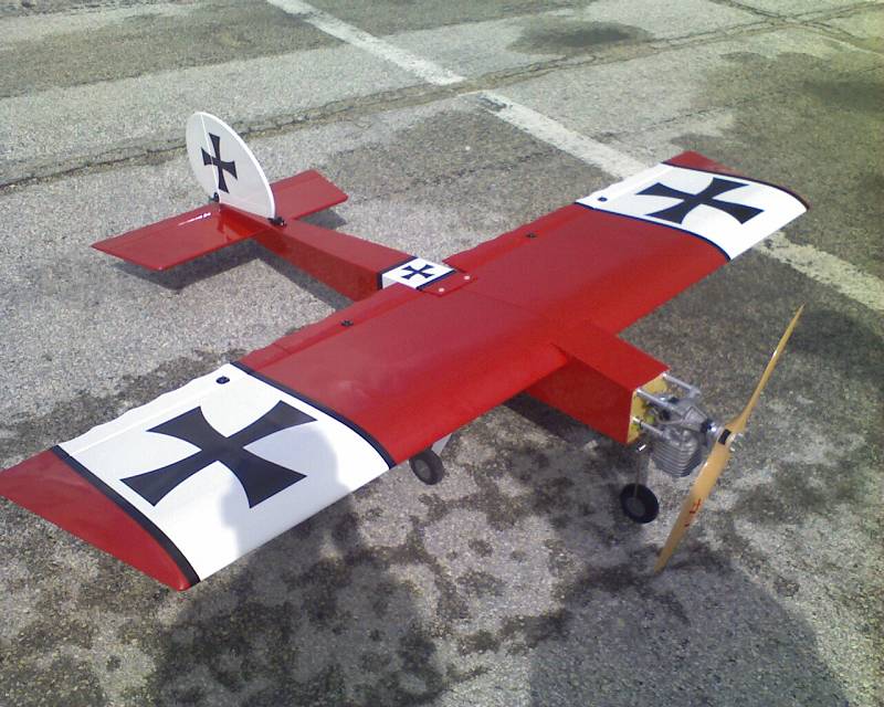

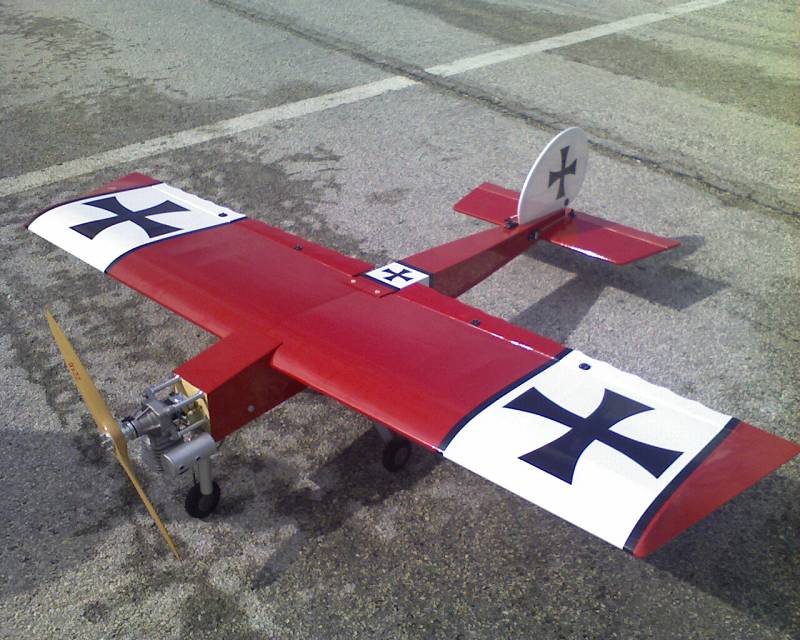

Old 11-01-2008 | 05:31 AM
  #3194
Posts: 145
From: Panama City, FL
Default RE: DL-50 engine
Used the Tricycle gear configuration. 15-25 knot winds in Key West every day, and taxi is non-existant with a tail dragger. If you're into DL/DA50's, this is a great break in platform.

Old 11-01-2008 | 09:09 AM
  #3195
Super08's Avatar
Joined: Dec 2007
Posts: 4,121
From: Fort McMurray, AB, CANADA
Where did you put the fuel tank? Is it in the front or back under the wing?
I did the same sort of thing with my Fuji. I used to have an OS 1.60 on it.
I have a new DL I need to break in an I would love to do it on my stick. I'll have to find some 6" wheels to get enough prop clearence to do it.

Old 11-01-2008 | 01:08 PM
  #3196
Posts: 145
The fuel tank is moved back further than the stock gas configeration. I marked the center of the fuel tank, and put the center of the tank directly over the recommended CG. Both the ignition and receiver batts are directly behind the fuel tank. With the DL50 tricycle gear configeration it balances about 1/2 inch behind the stock CG of 150mm. So slightly tail heavy. It is a beast. I take off at 1/5th throttle, 25ish feet, at rotation it climbs vertical unlimited at that stick position! I use the stock wheels, and get only 2 inches of ground clearance with the prop. I fly off of concrete though. Grass might not work without the 6 inch wheels.
