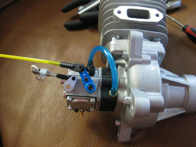

Hey guys,
Anybody know if you can easily re-position the choke arm?
Steve.......
Old 11-02-2008 | 07:15 PM
  #3212
Joined: Jul 2008
Posts: 369
From: Miami beach, FL
Default RE: DL-50 engine
ORIGINAL: mando
Hey guys,
Steve.......
Impossible...
Yeah...kinda looks that way.

The only thing you can do is to grind it off and use a cut down nose wheel steering arm in its place.

Thanks, that's a thought.......But I've did some creative control rod bending.

you can turn the choke arm 180 degrees, in doing this it makes rod connection much easier. make sure to use blue loctite when placing the screw bak in. Our club is not currently under a noise restriction, but many of us our using headers and cannister mufflers on our engines. they keep the noise down and i prefer them. What fits a DA will work on the DL including the new 100's.

You can spin the throttle arm 180 as it has the screw holding it on. But the choke arm is a press fit on the end of the shaft. No screw to remove so you have to grind/break it off and do the steering arm thing if you need to get at it a different way.
Normally just spinning the throttle arm 180 makes the choke easier to get as it frees up access to the lever, so it can be left as is.

Thanks DL Aust. Iremember turning one of the arms 180deg. , thought it was the choke, but I stand corrected and agree that reversing the throttle opens up extra space for the linkages.
Cheers
Correct. Choke can't be reversed in a normal fashion, there also shouldn't be a need.
