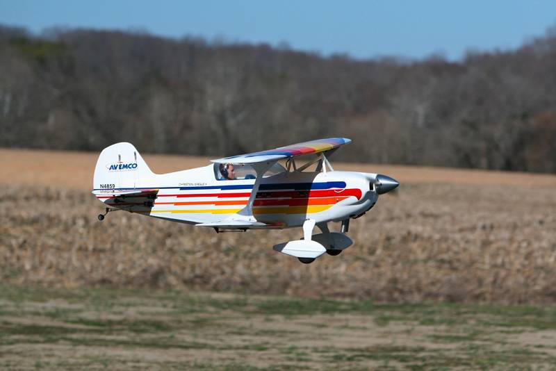

I have had a Skyshark Christen Eagle in the box for over two years now and have decided to put it together. Has anyone ran a dl50 in one of these planes? Thanks.

Bosco,
I covet your Eagle. And I've also fallen in love with the DL 50 (have two nowone in a GP 27% Extra and my second in a GP 27% Edge). Back when, I did the "in-house" development on the Eagle and wrote the instructions for it, but they (we) discontinued that one and I never got one for my self. [&o] I've always loved the Eagle and I wish I could have flown one with a good (powerful) engine like the DL.
Take care of my "baby."
Tim

I have one NIB that I'm about to let go of. Too big for my pit crew (wife) to handle. I'm talking about the Great Planes 1/3rd scale version of the Christen Eagle. PM me if interested.
